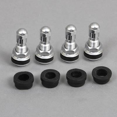

This is the 949 valve stem:
These are some others from Keyser Mfg and Allstar Performance:

I have never seen anyone answer their own question as much as you do. It is quite bizarre. The part that goes through the wheel is usually the same size but the seals can be larger or smaller. Every valve stem I have seem has a rubber seal on both the inside and on the outside of the wheel but it is usually tightened on the inside only. Considering they are a wear item and even metal ones will end up needing to be replaced eventually I like the cheap ones from ebay. The 949 ones are nice as well but a bit more expensive.

Most of the metal stems seem to have a flange cast into the metal section on one side (usually the inside, which makes sense) and a washer and nut on the other side. The rubber piece has a cylinder that is close tolerance to the hole in the wheel and a flange that rests on the molded flange. Tightening the nut causes the washer to compress the rubber piece tightly pressing it against hole.

Sorry I don't understand what you mean by access? For me the fewer pieces that can move the better hence why I like the 949 style or the ebay ones I have bought where there is no un on the outside of the lip and at least the ones I have have 2 nuts on the inside. I have never had one come loosein plenty of street driving on really rough roads. They were fine at the track as well with multiple pressure checks in between sessions. These are the ones I have.
http://www.ebay.com/itm/4-NEW-RED-VA...59c3a1&vxp=mtr
They come in plenty of colors and are cheap enough to replace if they fade, break etc.
