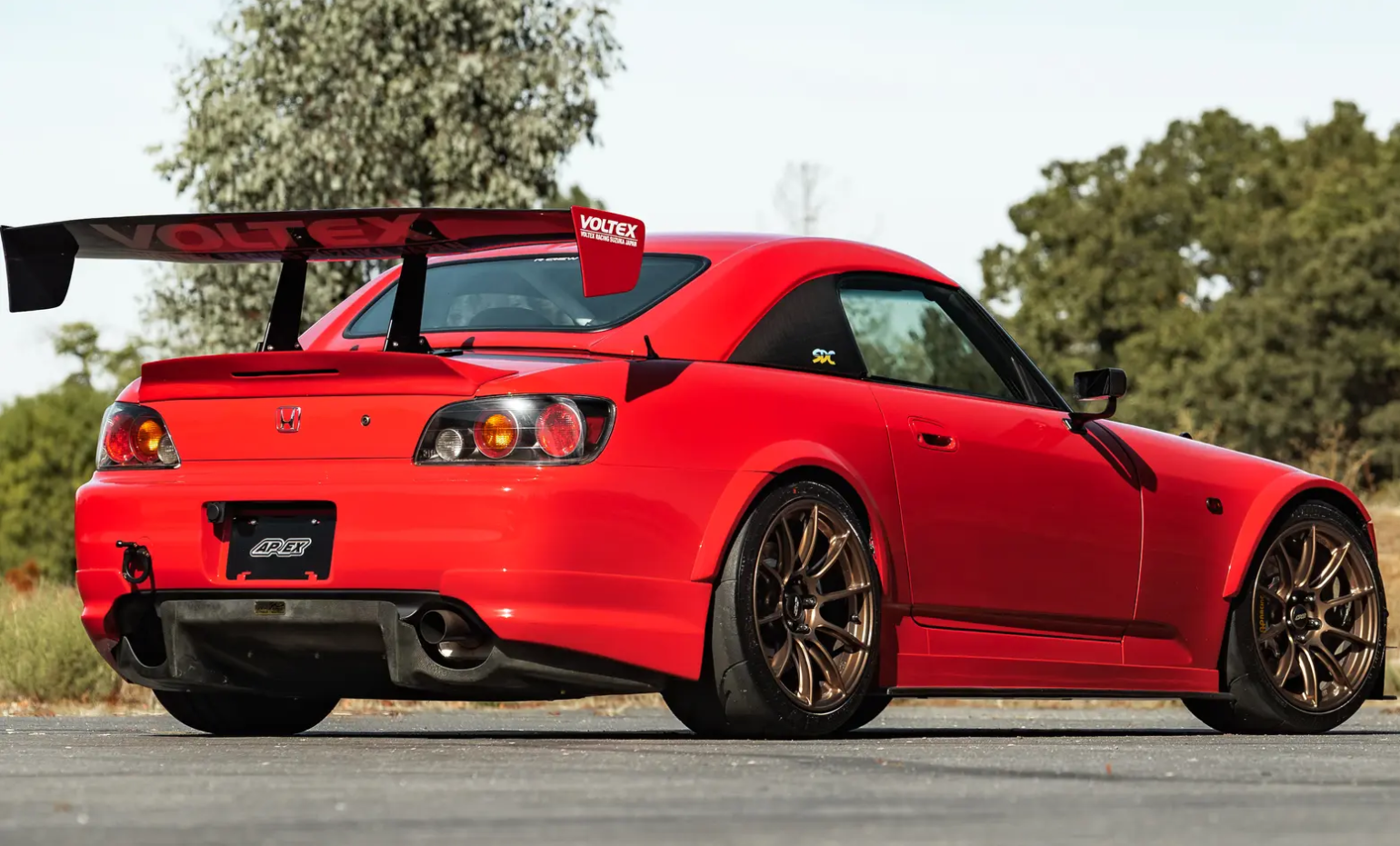

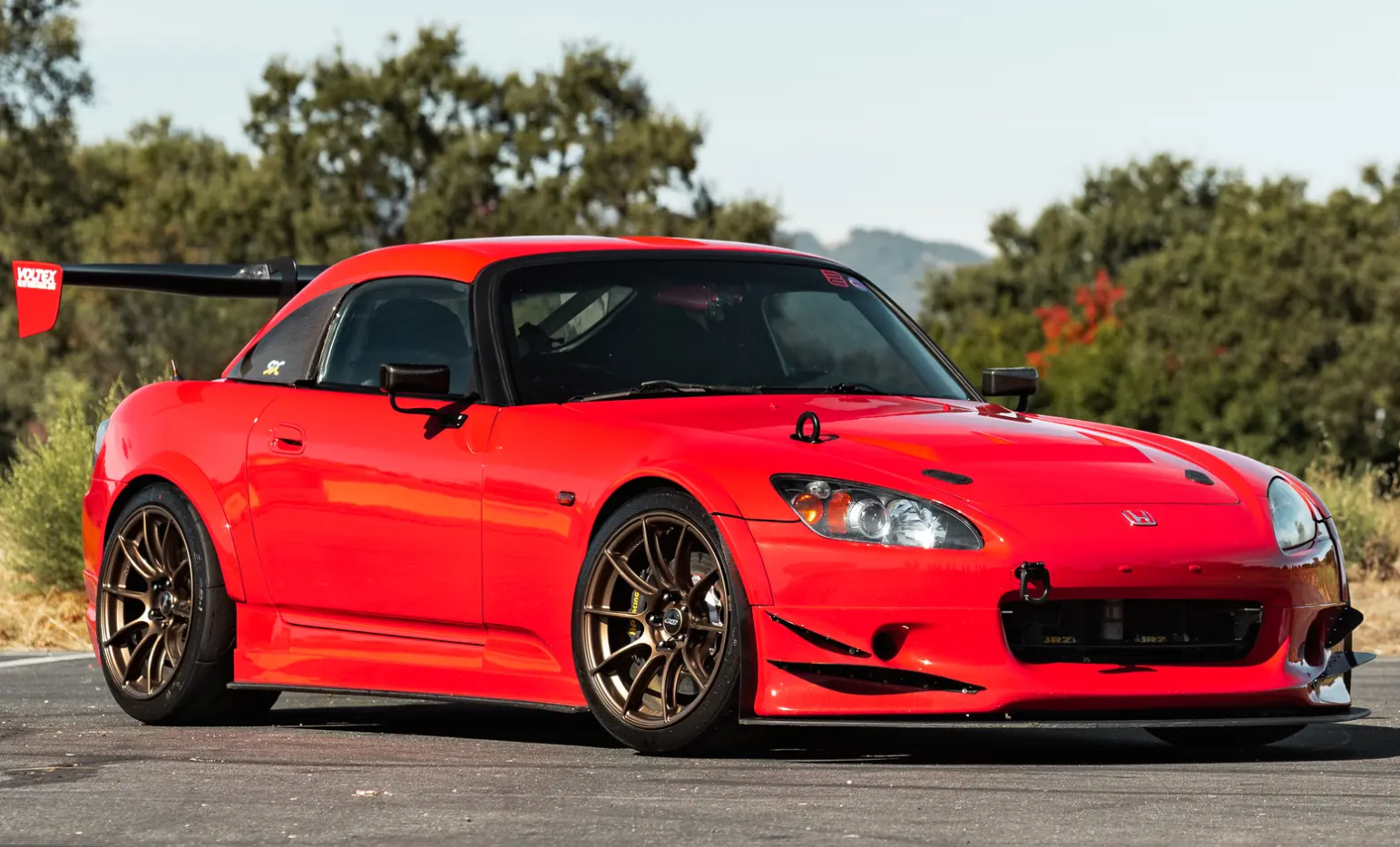

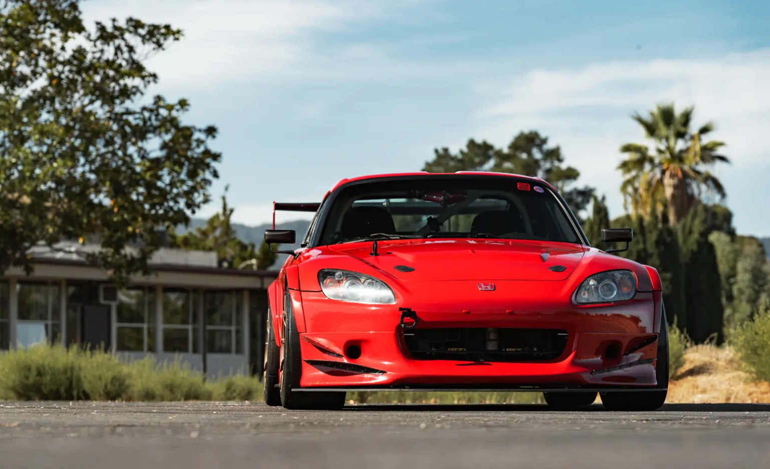

Go to Apex wheels. You can stuff 18x11 +52 wheels with 295 tires square with those fenders. They have a few wheel designs in those specs both forged and flow-formed. Pictures below of such a setup.
