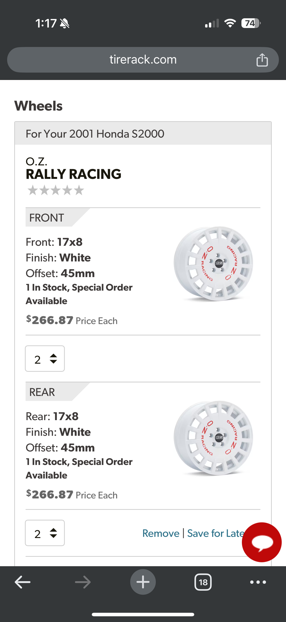

Saw these wheels and wanted to know if you guys think they would fit or if i’d have to roll my fenders.

Roll fenders needed. What size tire were you planning on running? 245 or 255? either-way, a roll needed.
Probably won’t do it then. Not looking to roll my fenders, also I just showed them to my girlfriend and she made fun of them and said they look ugly. I’ll just keep oem for while longer
https://apexwheels.com/vehicles/hond...4HzbbXyra_CEXd
You can get all of these wheels in 17x9" +61 and fit 245 square tires and not have to roll your fenders - it's recommended, but you can get away with not rolling.
