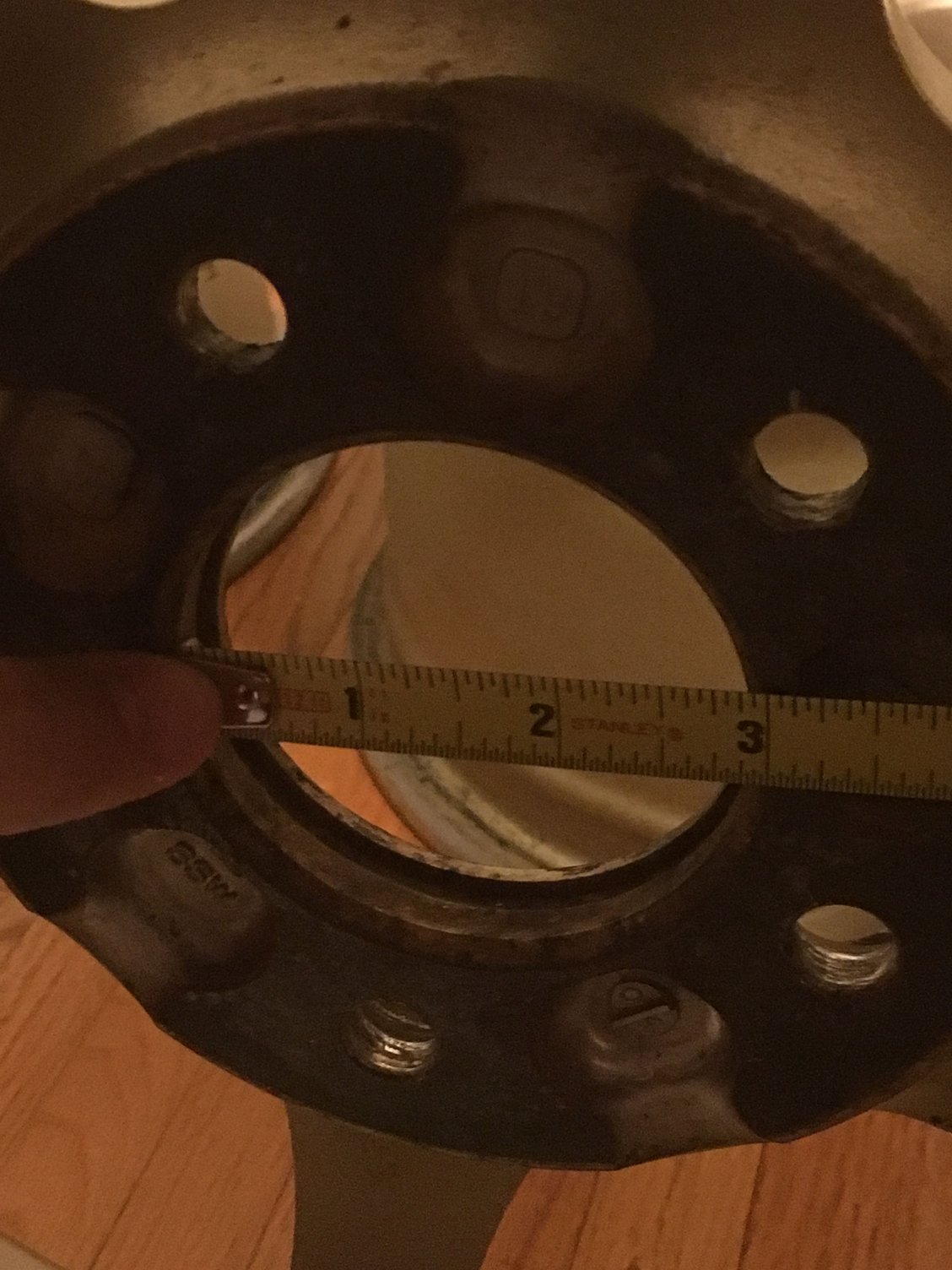

Gotcha. and here are the specs just to make sure before I shop around
Front: 17 inches, +48 offset, 7.5 wide
Rear: 17 inches, +55 offset, 8.5 wide
starting to get nervous due to me stupidly not researching hub information.. if I try to test fit them on the car, it would be obvious if they fit properly or not, right?
Thanks!!

Looks like both front and rear center bore sizes are a tad under 3 inches. Am I screwed?
Old Aug 1, 2018 | 06:59 PM
  #1508
Manga_Spawn's Avatar
Site Moderator
Joined: May 2011
Posts: 13,625
Likes: 372
From: Seattle WA
I don’t think so. Oem fronts are 70.3 mm which is about 2.75 inches. Should fit fine.
Id honestly just do oem ap2 tire sizes on those.

rears are 64mm though. Wouldn’t that be to much of a difference? And I’ll swing by the local tire shops tomorrow for some quotes!

You can always run hub rings. I'd run the OEM AP2 tire sizes as well. People seem to like Firestone Indy 500 & they're cheap too.
