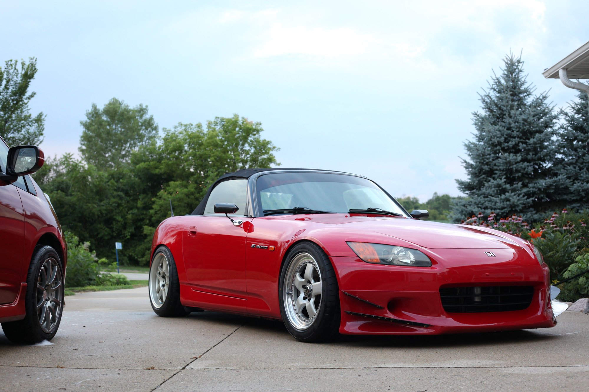

Here is something similarish in terms of fit, my least favorite stage of my car.
17x7.5 +30 w/ 215/45 up front. 17x9.5 +43 w/ 245/40 in back. Front obviously much more similar bc the 9.5 will shape the tire differently than an 8.5.

Ahh I've seen your car around this forum a few times. How much camber were you running? And I might be trippin but it looks like you pulled your fenders.
Fronts are lightly pulled. One rear is pulled bc paid a guy and he did an awful job.
I think I had -2.5 or so at that point.
