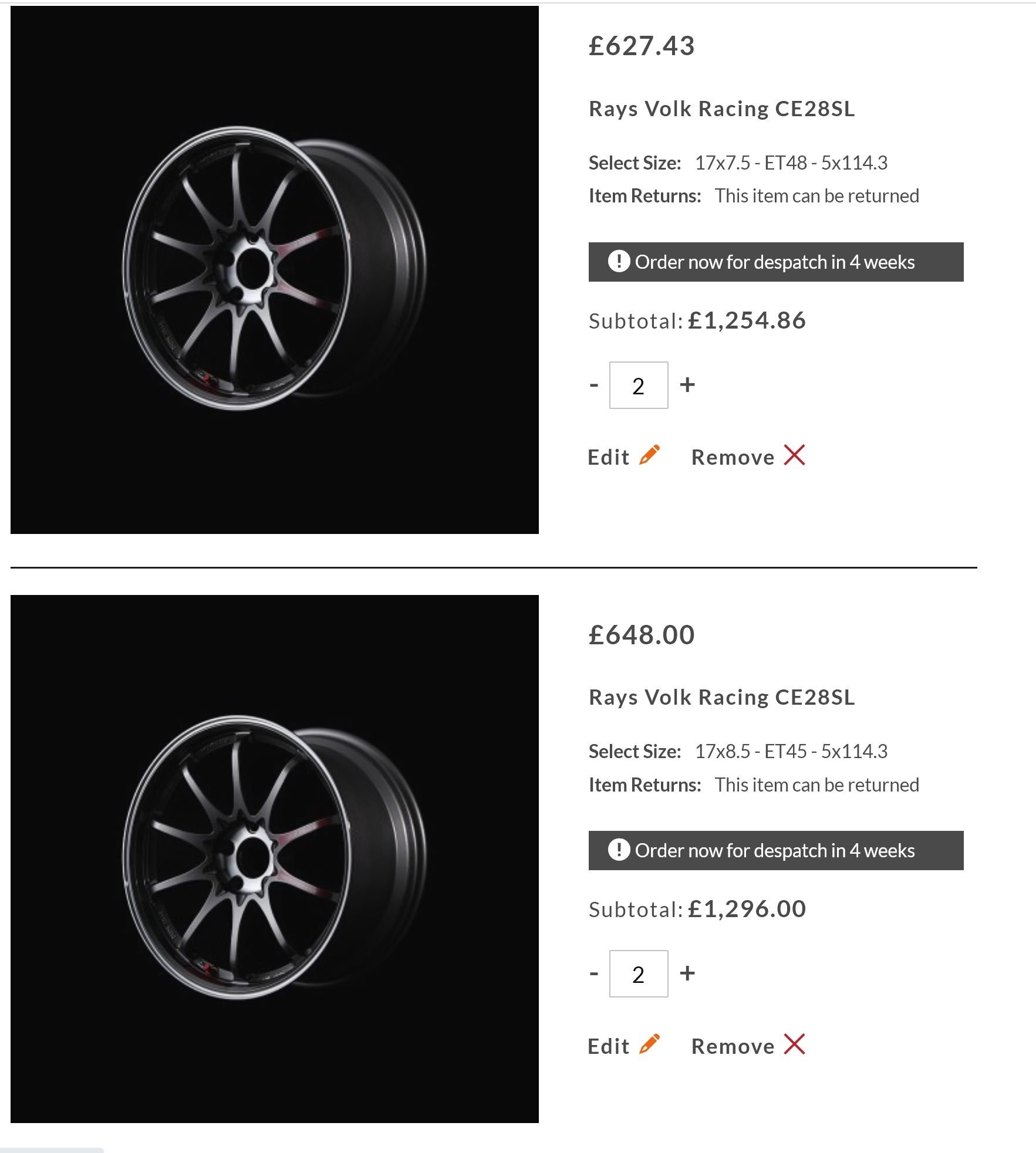

Hi all, question, will these fit? I am assuming no spacers, no fender rolling. Still same tire setup front 215/45R17 and 245/40R17 back?
Thanks in advance!
front: Rays Volk Racing CE28SL Select Size17x7.5 - ET48 - 5x114.3
back: Rays Volk Racing CE28SL Select Size17x8.5 - ET45 - 5x114.3

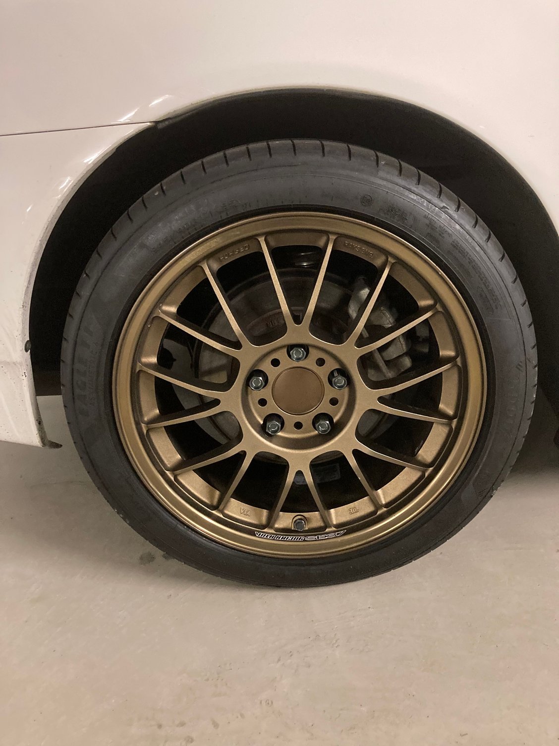

I’m running the same setup (offset, tires, width) with SE37Ks and stock suspension, no rolling. I also posted here to get another opinion and all advice was super helpful.
In Switzerland (and Germany), all car mods need to be inspected and certified by the government. They passed my clearance saying there was sufficient space and have not experienced any rubbing. But I’m just one car.
Rear with +45, 8.5 and 245s

As mentioned - I’m at original suspension height. If you’re lowered or plan to drop your height, you will need a roll. I also got my alignment done and my shop added some negative camber as well.
