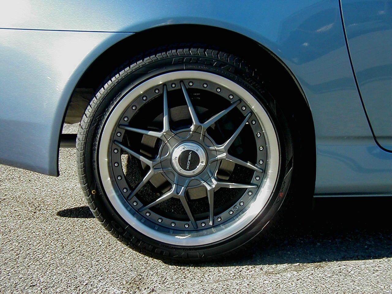

hey russ u have any pics of your car?
once again thanks
Old May 1, 2003 | 07:14 AM
Russ's Avatar
Posts: 2,956
From: Land of the landeaus
Here tis.
These wheels/tires will be gone soon though. I have a newbie combo being put on in a week or so.
Don't know what I'm going to do with 'em. The Kumho's only have 8,000 on 'em.
