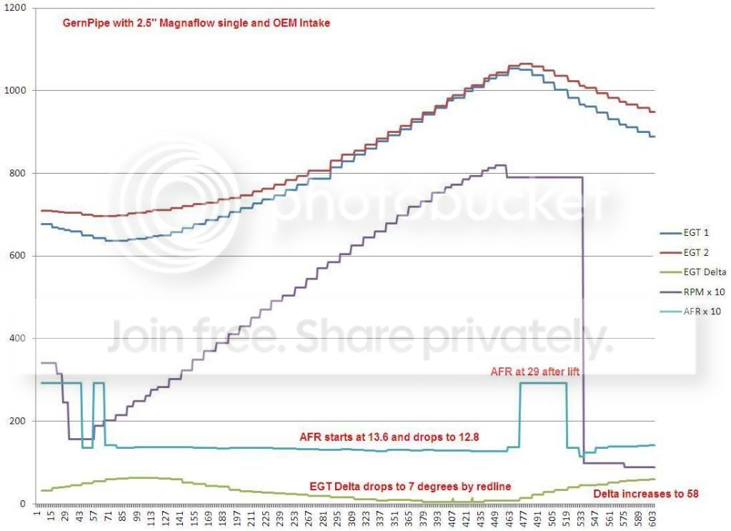

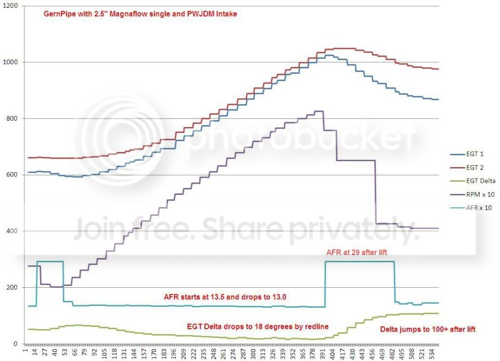

I was going to wait until I had more confidence in my hypothesis before posting these results, but figured it wouldn't hurt to just post the graphs now. I'm going to hold my conclusions until later.
