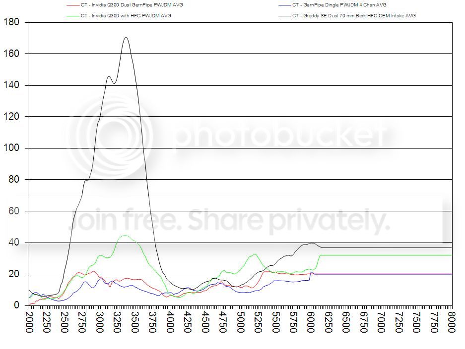

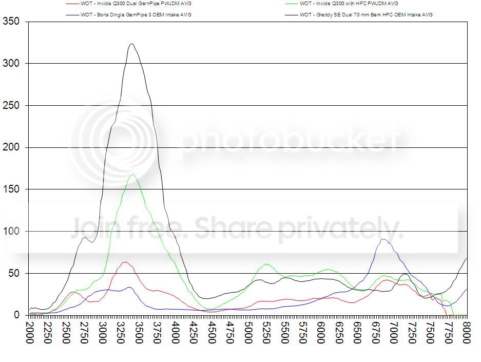

@Driv300mph - Thanks for the updates and videos. I also appreciate the opportunity to test your Greddy. I had planned to use the Greddy for a couple days, since I didn't really have time to swap exhausts back. However, after experiencing how bad the drone was yesterday, I knew I simply had to swap back immediately. I didn't get to bed until after midnight, but it was worth it. I can't say for sure that it's the worst drone I've ever heard, but the only time I think I might have heard worse was when I borrowed an N1 Single back in '02. Thankfully, God gives us the ability to forget horrible things over time.
Here's the Drone-O-Meter plots from the Greddy at full throttle and cruise throttle.

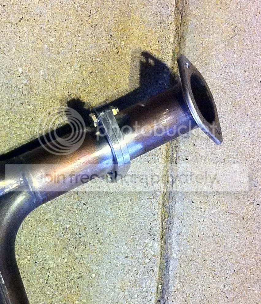

Here is the flange that I added to the Greddy, but still need to have it welded the rest of the way.
