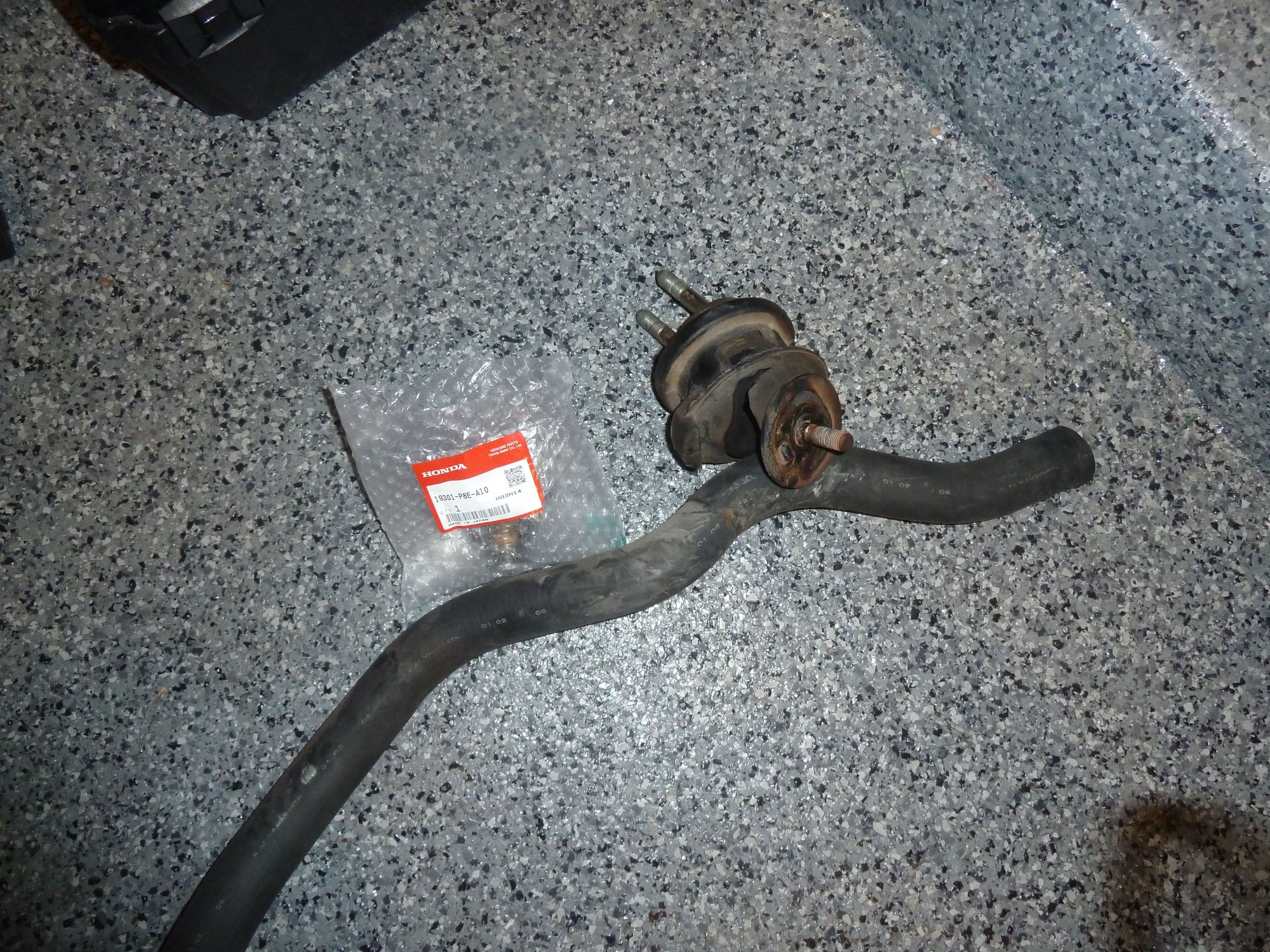

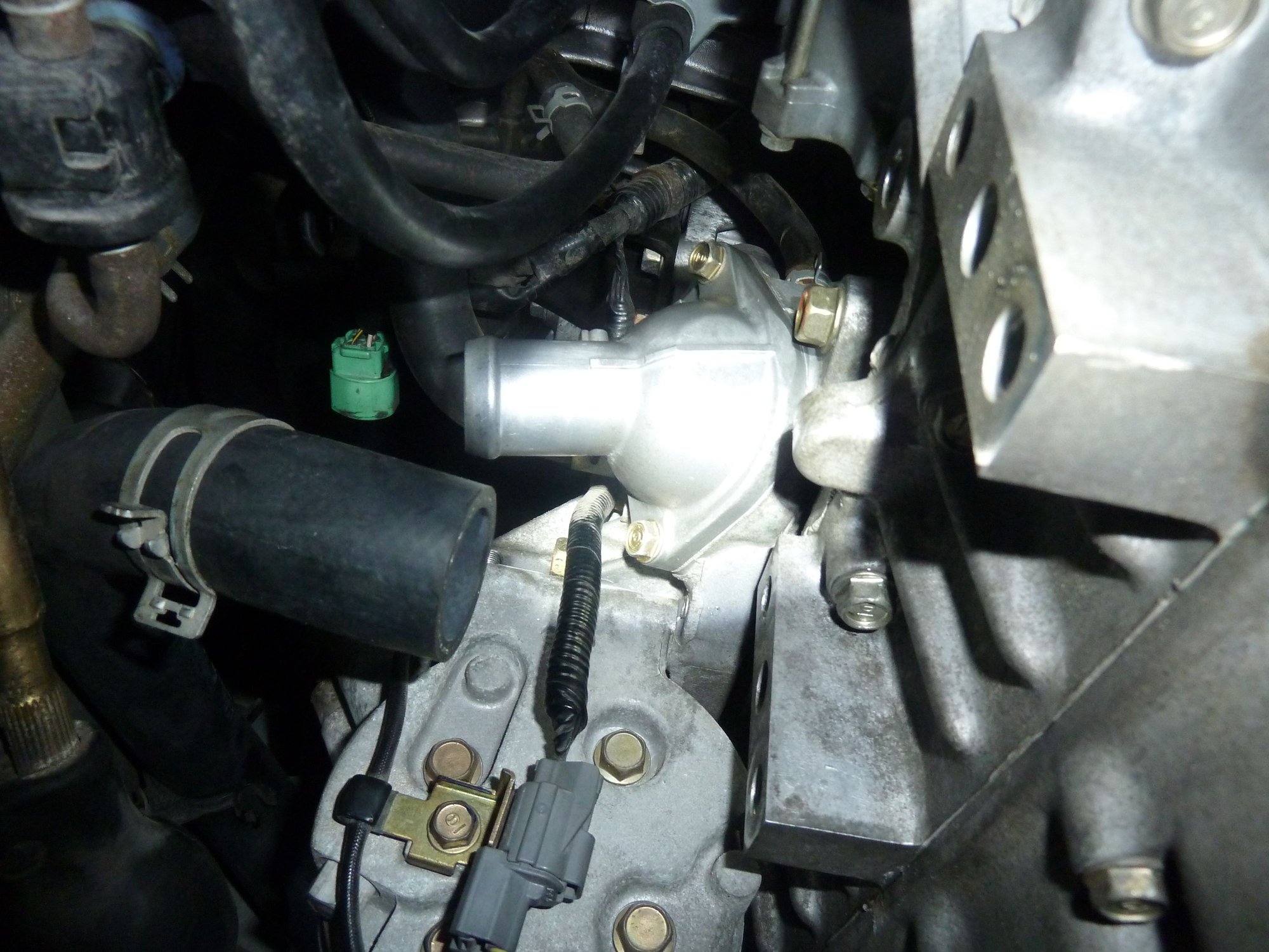

Started the work to replace the clutch. I had a number of while in there projects planned to do. I got the new motor mounts in, replaced the thermostat, lower cooling hose, water pump, the bearings for the tensioner pulley and guide pulley.
Access to the thermostat is really good when the driver side motor mount is off. If you are changing out the motor mounts and don't know how old the thermostat is totally worth doing it at the same time.

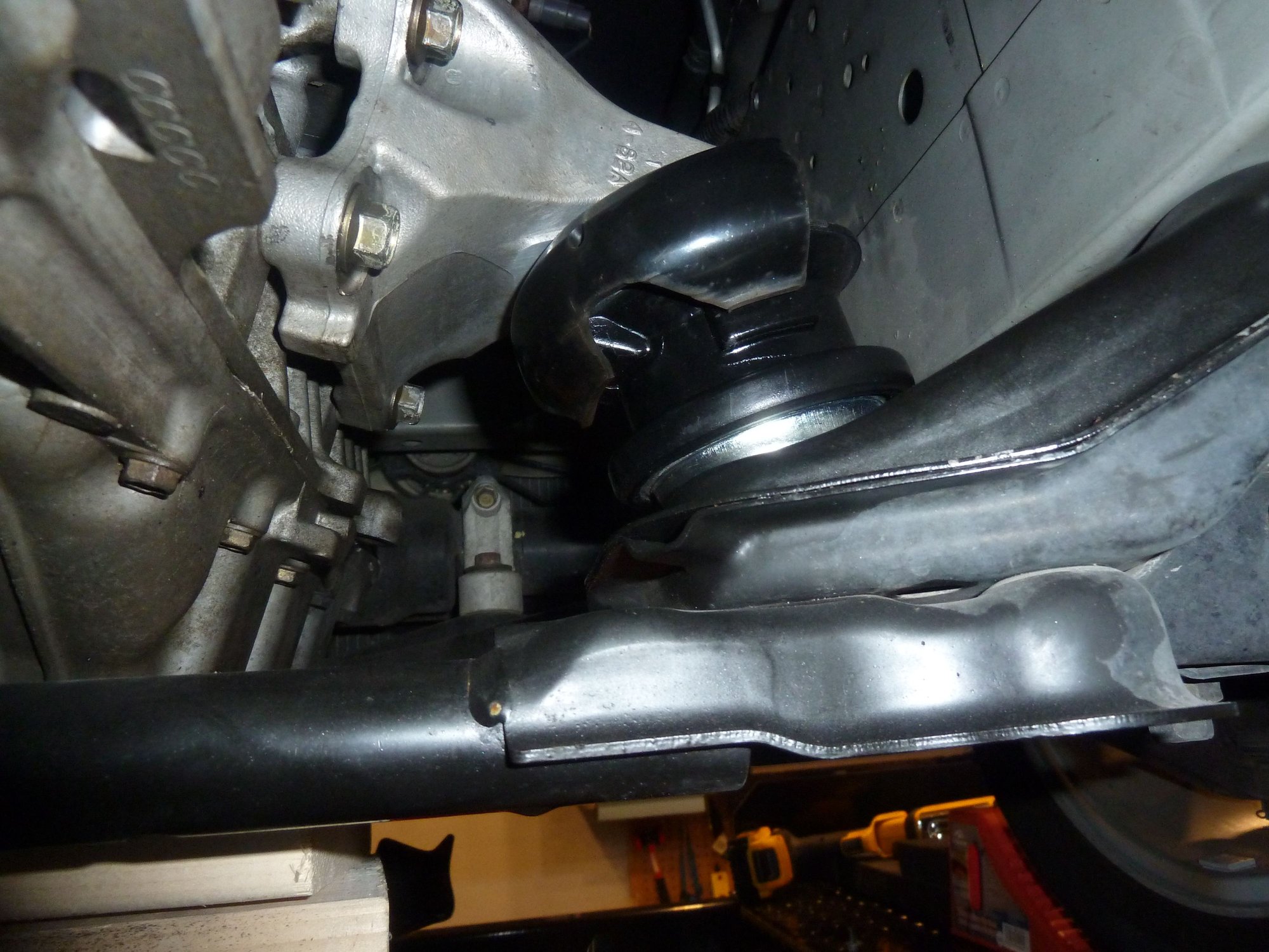

New motor mounts in place! Was a pretty easy job. I needed to loosen them in order to get the manifold out so made sense to do them as part of the clutch process.
The driver side motor mount was done! Validation that this was a good idea to do "while i was in there"

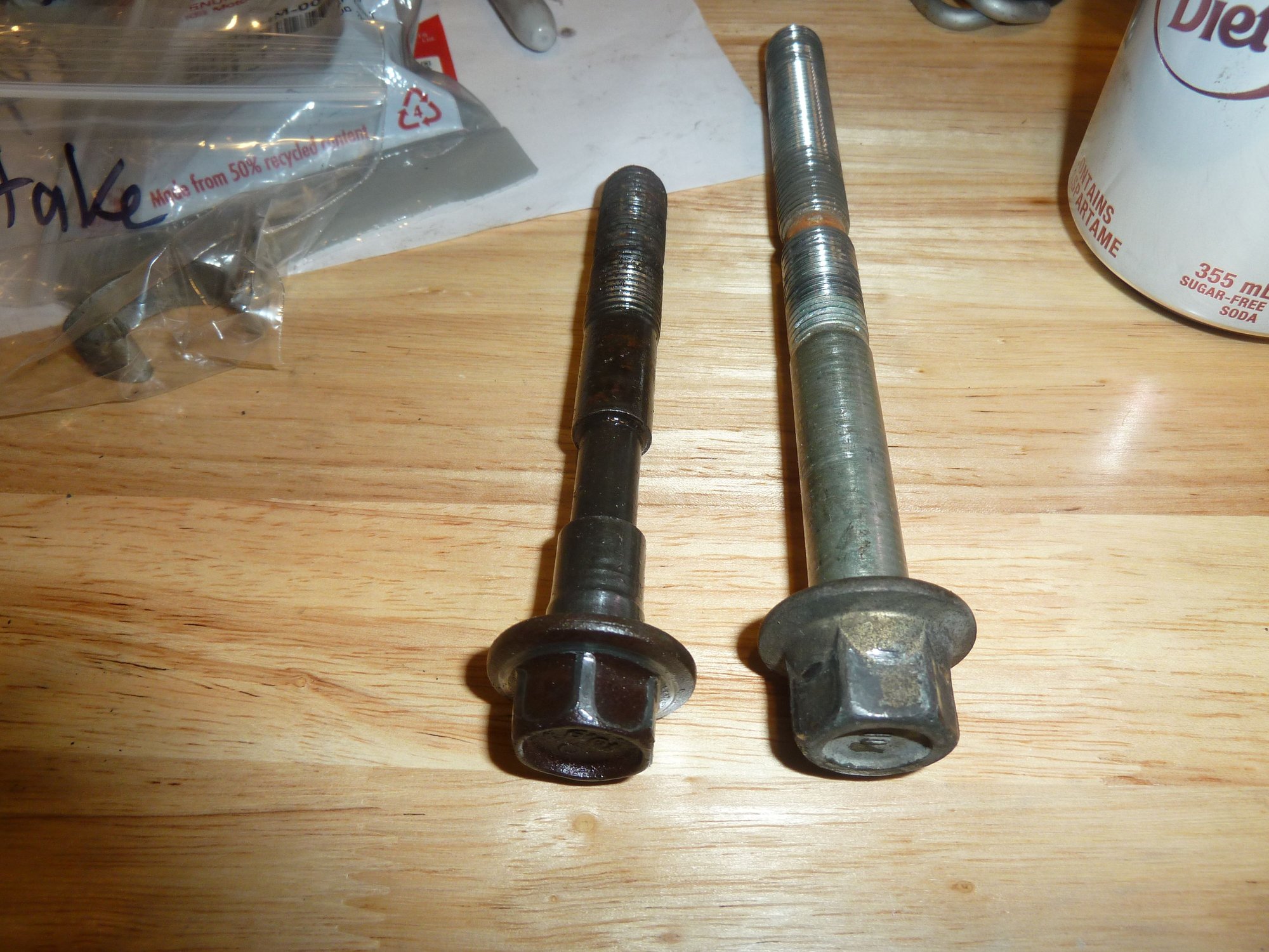

After days of fighting with top start bolts, manifolds, driveshaft bolts we were one subframe bolt away from getting to the top transmission bolts. The front driver side subframe bolt moved 1/4" and would not budge. This made me very nervous. I was paranoid about breaking the bolt and/or stripping the threads. I decided that I was in over my head and started putting everything back together. I took my time and cleaned up and replaced a lot of worn hardware along the way. I started doing more research on the subframe bolts and found a couple of threads on this.
The advice in these threads was to loosen it as far as you can, put in penetrating oil, tighten then loosen again. After doing this about 10-20 times I finally got it out!!!!
The one on the left is what I fought and finally got out. The one on the right is what the bolt should have been. 2 of the front 4 subframe bolts were mixed up. I was very concerned that this bolt didn't even look correct for the middle bolt. I purchased new bolts for all 4 of the front subframe. I cleaned inside the bolt hole and hand threaded my new bolt in. It went in without resistance and I was able to torque it to the correct specification. So I think I am out of the woods! I CANNOT EXPLAIN THE FEELING OF RELIEVE!!!
So I think we can continue with our goal of replacing the clutch now.
