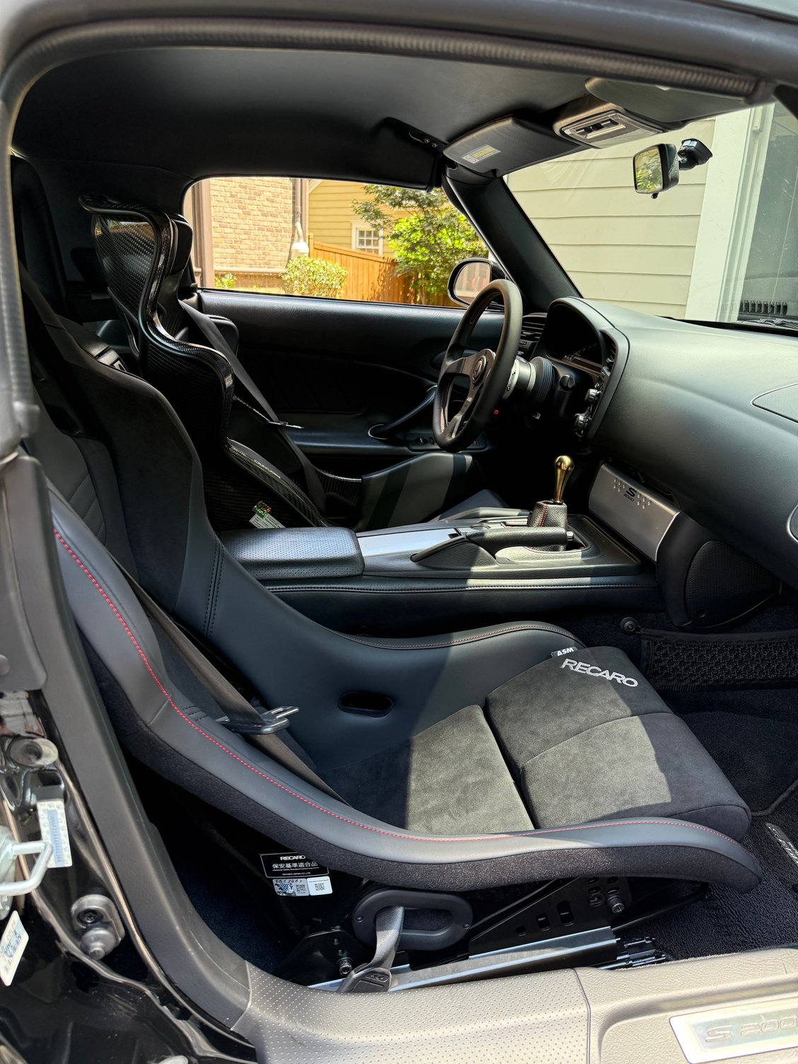

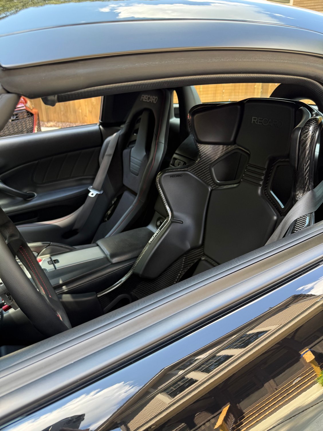

Got the RSS installed, it’s a nice match for the RMS! I’d definitely say that Recaro has cut costs in the upholstery when compared to the RSG though.
All in all it’s still a nice seat - I’d say comparable in quality to a Bride now vs. the RSG being slightly nicer.

Man, wild combo. Fun setup!

The RSS looks beautiful!! what seats rails did you use?
Old Nov 14, 2025 | 04:30 AM
  #146
awhit17's Avatar
Joined: Nov 2013
Posts: 433
Likes: 127
Thanks! Recaro Japan has some dedicated rails for the RSS, so I used those.
The dimensions are almost identical to an RS-G, so anything that works with an RS-G should also work for an RSS. I’m pretty positive that the RSS rails just have more adjustment on the side mounts and are otherwise identical to the Recaro JP RS-G rails.

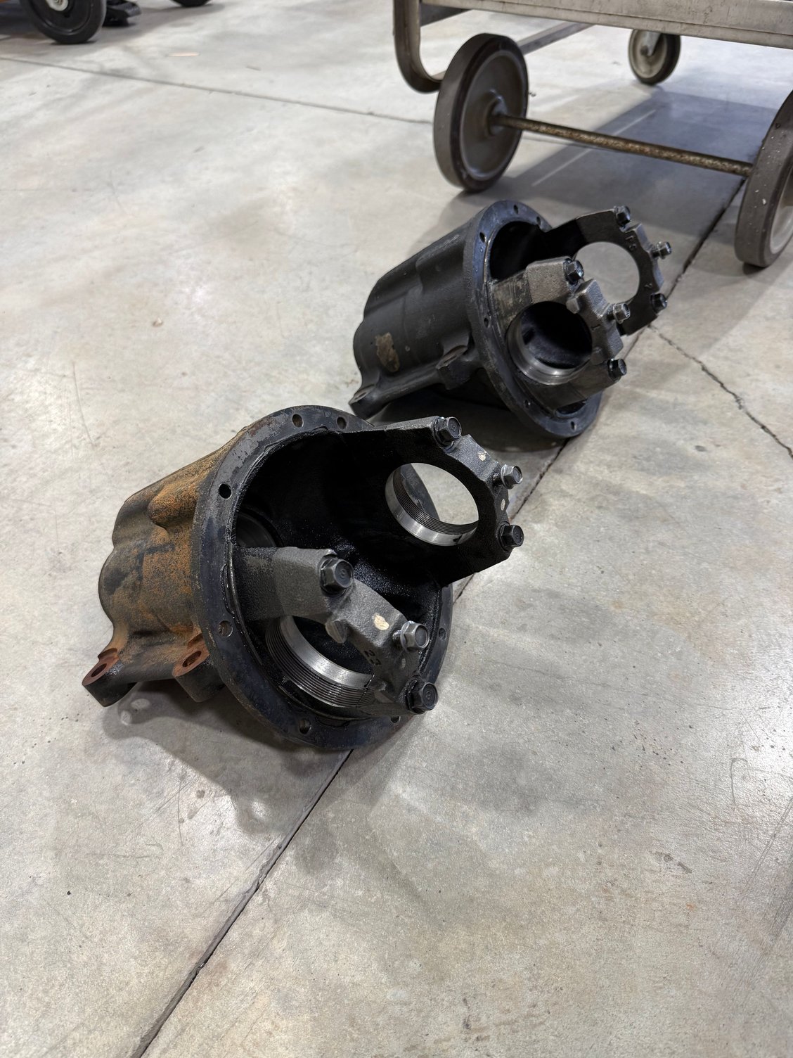

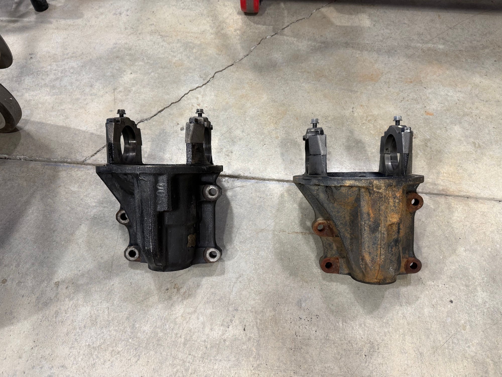

Starting to pursue my winter plans. A friend and I picked up 2 used diffs and got them broken down and ready for a refresh. One of these is an AP2 diff and the other is an AP1, but both will be going into AP2s. As per usual with S2000 diffs, both of these had wrecked pinions.

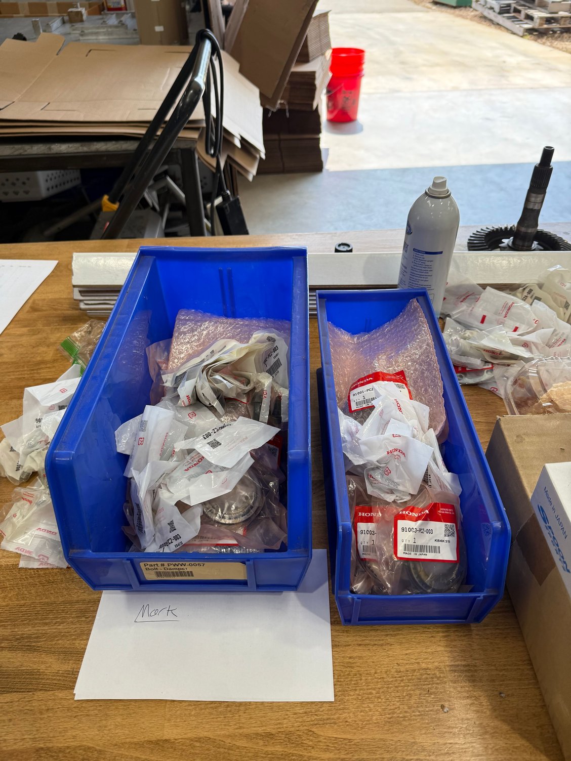

Since you only live once, both of these will be rebuilt with completely new OEM parts, all the way to the bolts and companion flanges.

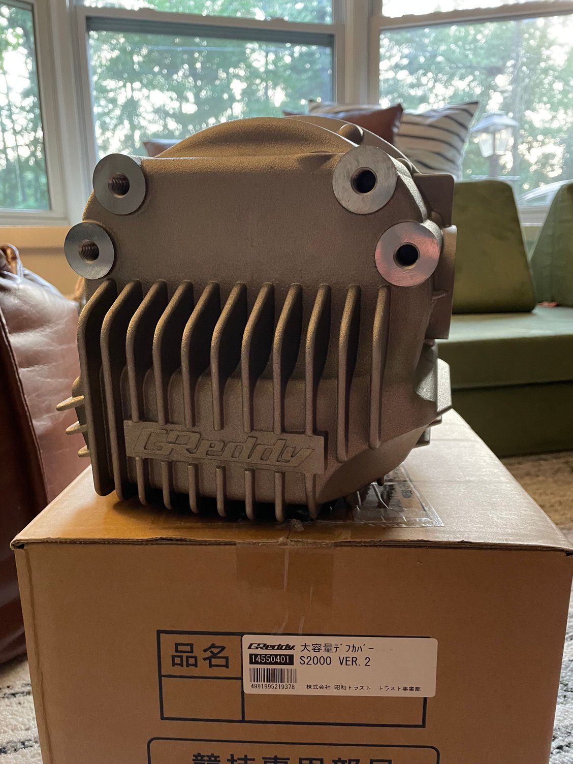

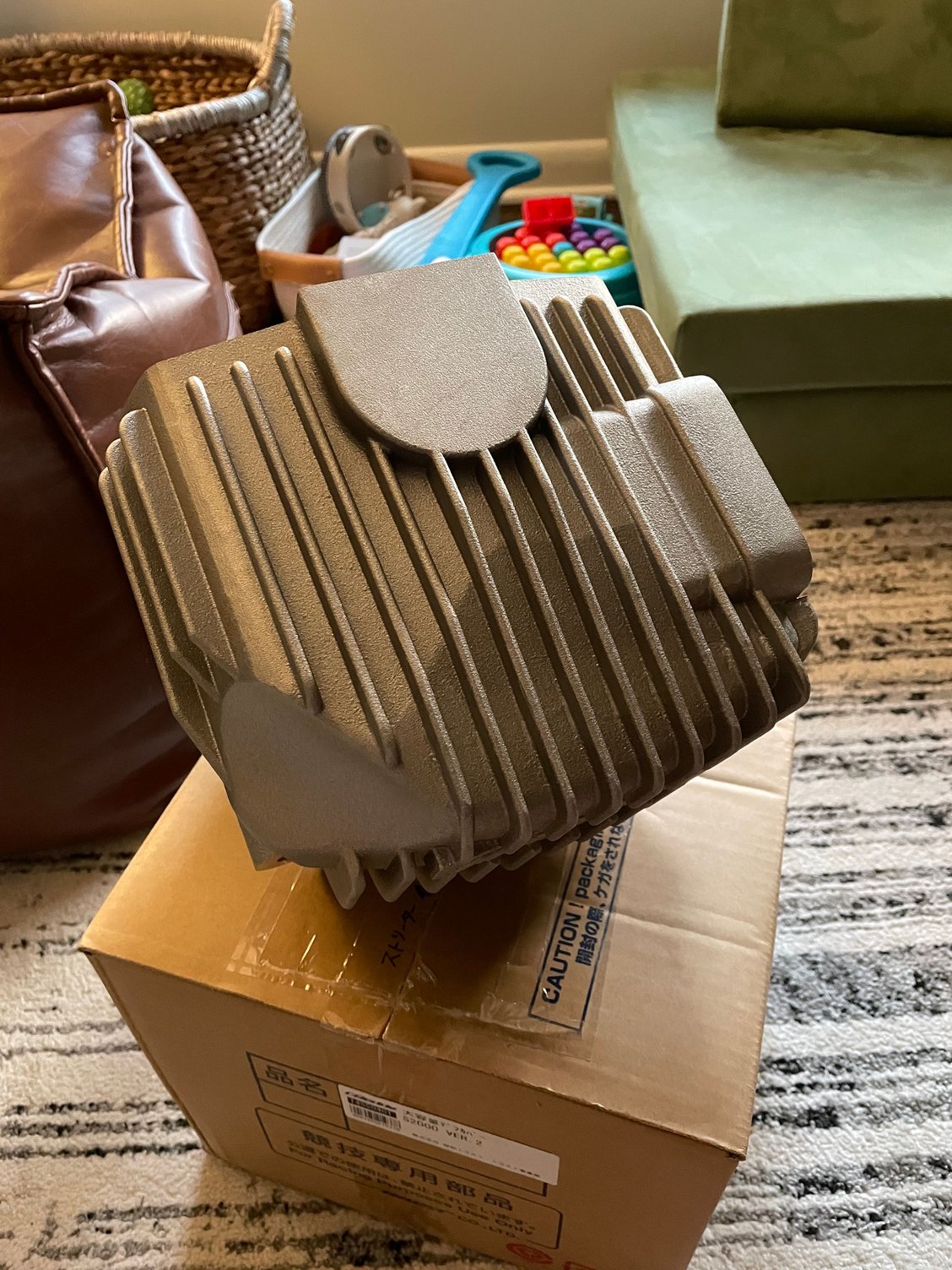

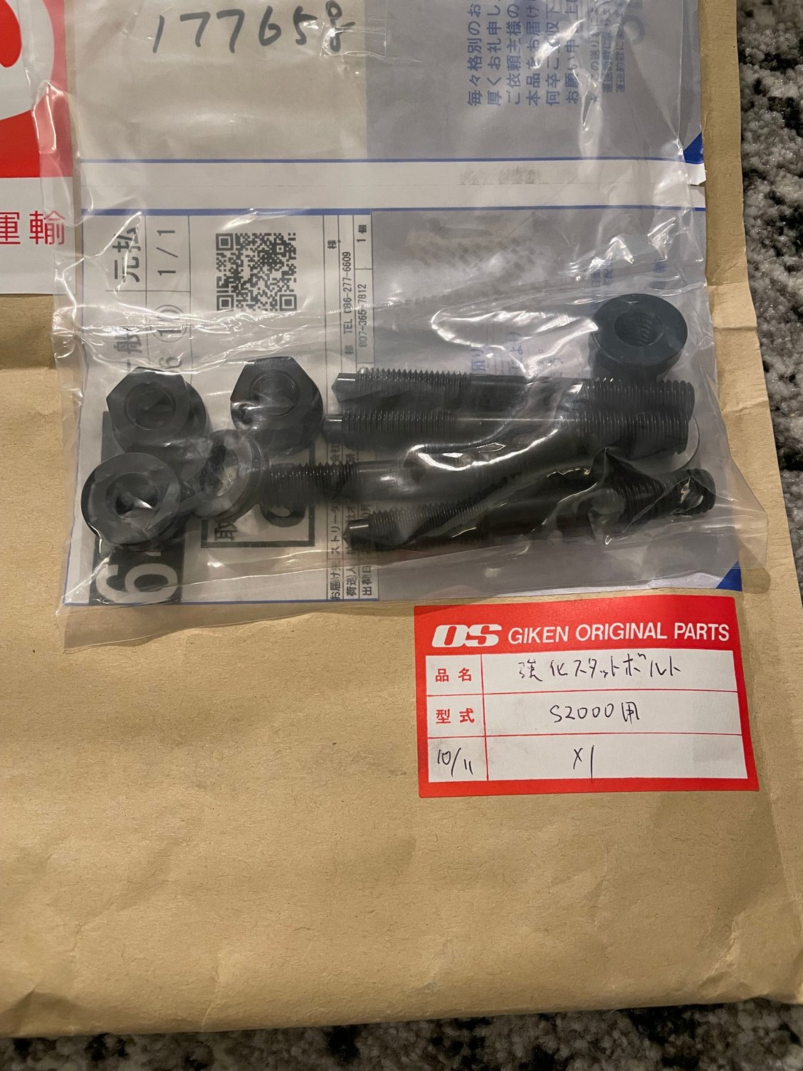

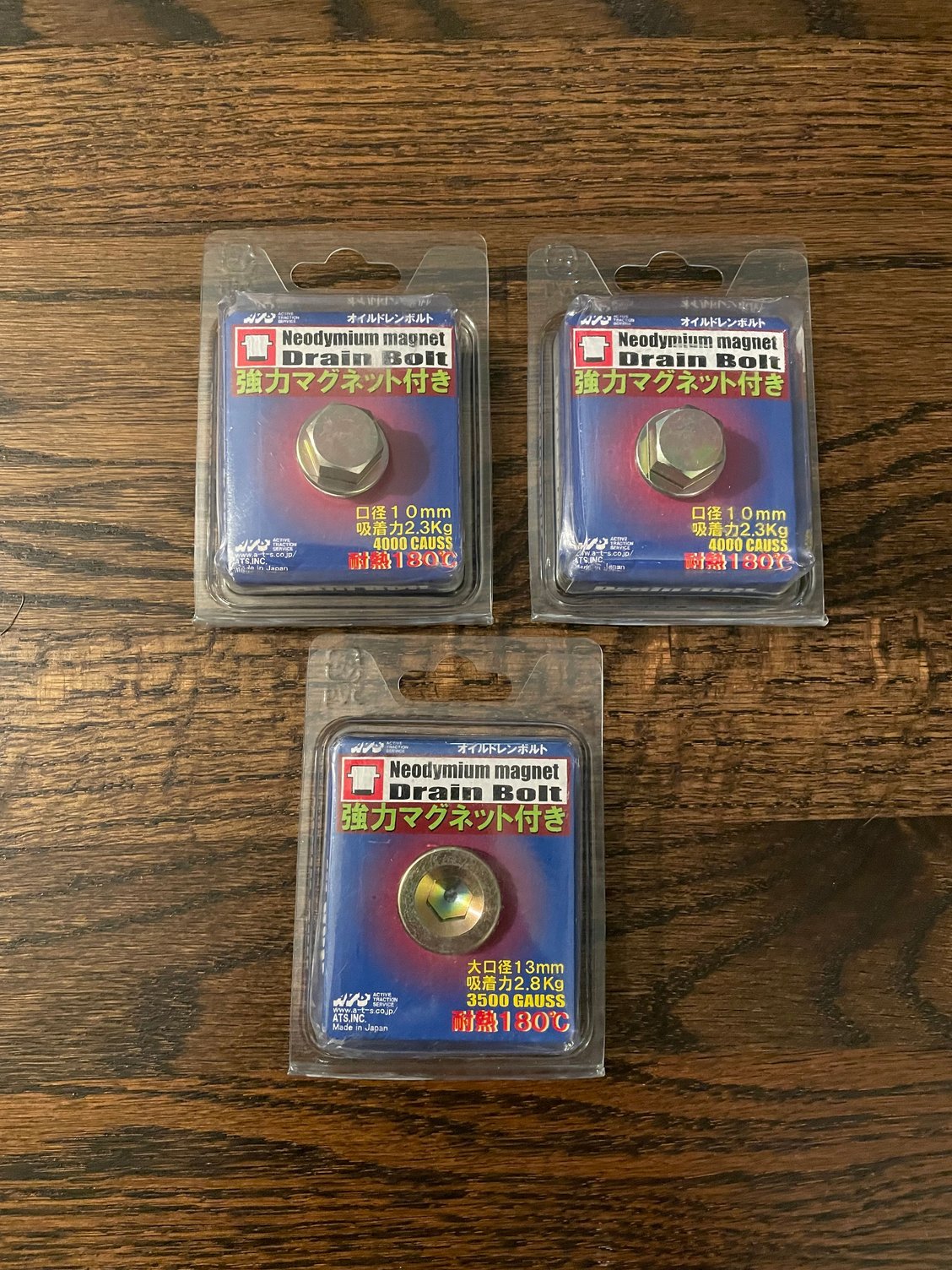

I also pulled a few upgrades out of the stash to use as a part of the rebuild:
  • OEM Mazda 4.3 ring/pinion
  • Greddy v2 diff cover
  • ATS solid pinion spacer
  • OS Giken bearing cap stud bolts
  • Arvou-spec ATS Carbon LSD
  • ATS drain plug
All of this is now off to be assembled with the plan to get it back in the car before things warm up. I think the 4.3 will add just enough spice without being obnoxious, and I’m particularly interested to see how the LSD plays out. I have always thought the ATS stuff was really cool and their durability has come a long way since they came out forever ago. Soon-ish we will see!

4.3 and a ATS LSD sounds like a great pairing. The carbon ATS are easy to tune. Just add some friction modifier in certain increments for how you want the LSD to behave. The ASM (USA) guys have it figured out.

both of those seats were so comfortable to sit in. makes me want to spend money on a pair of the passenger seats. absolutely comfortable. great seeing the GA crew!
