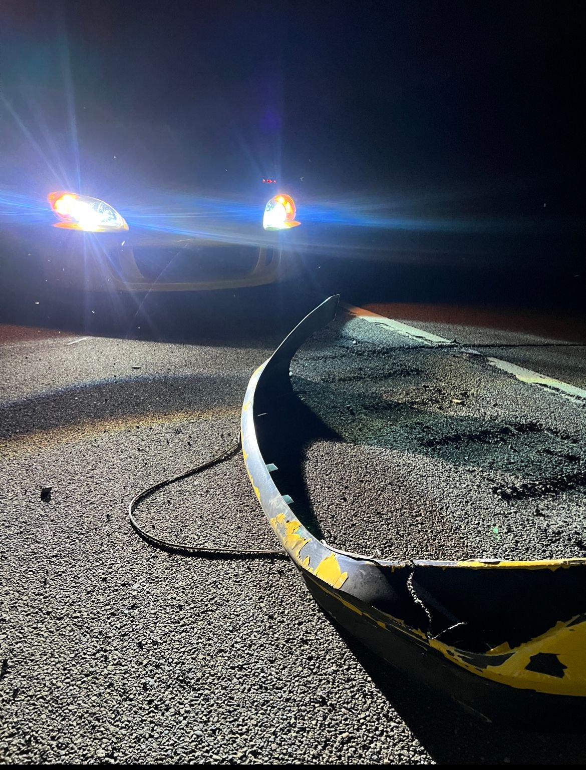

Shortly after I decided to finally be an adult about time attack and grab myself an AIM Solo2 to help me find more time on the track. At the following event in NJMP I put it to the test. The Solo2 help me get down to a 1:31.2, and be consistently on that range, which is about 8 tenths faster than what I've ran here even with cycled out tires and a massive headwind. Again, the car ran flawlessly, but I have to confess that I started getting overconfident behind the wheel; from multiple off-tracks, to a money-shift from 4th-3rd and a few near spins. This resulted in an eventual ejecta-seato lip and a cracked titanium Tomei test pipe

My friend who painted the trunk and lip was a slammed and couldn't do the install for me. Luckily, the bumper had the marks to drill the mounting holes for the CR lip. Not a hard install.

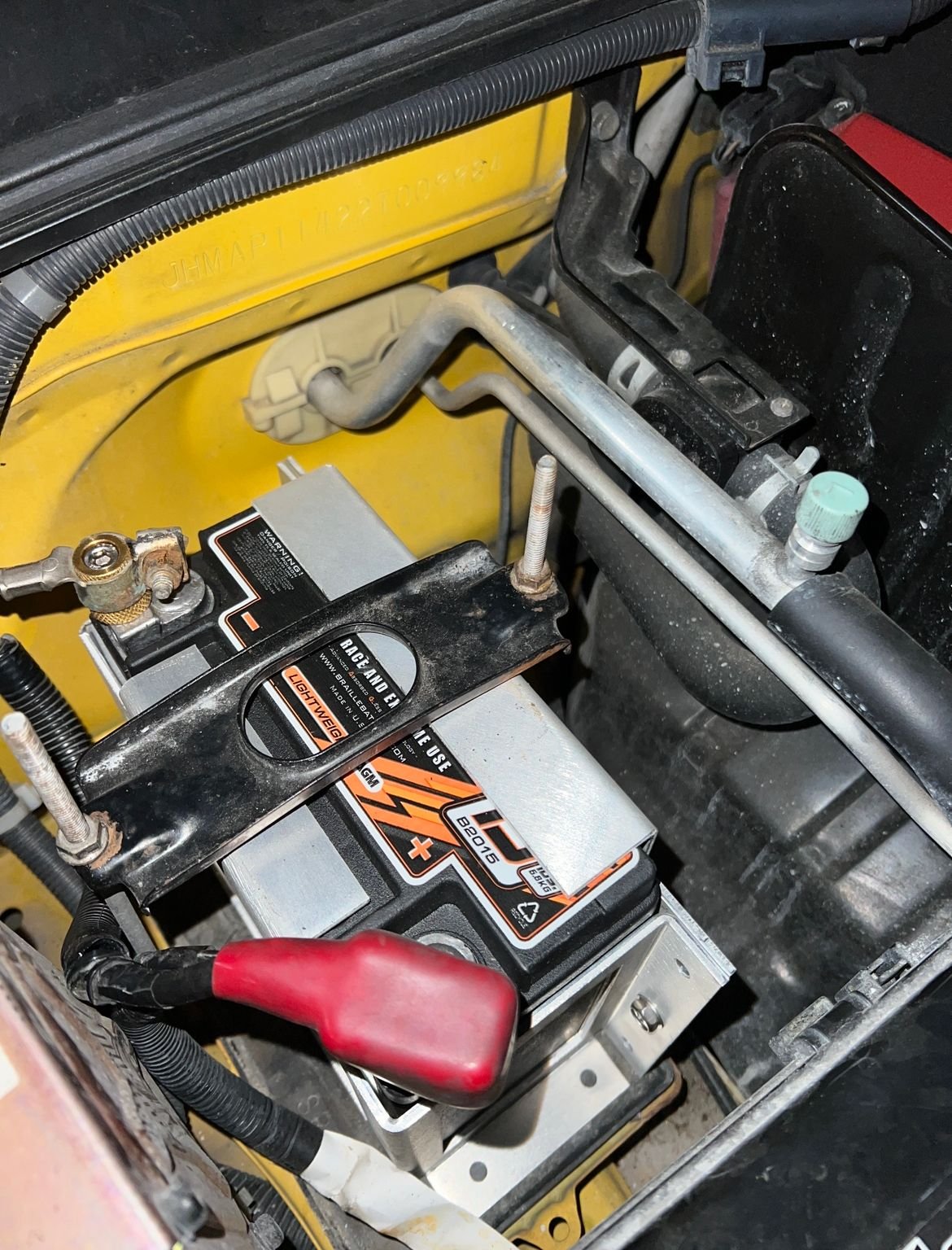

Got around installing this Braille battery that I was gifted last year. It weighs 15lbs, a little lighter than the OEM 27lb one that I’ve been running.

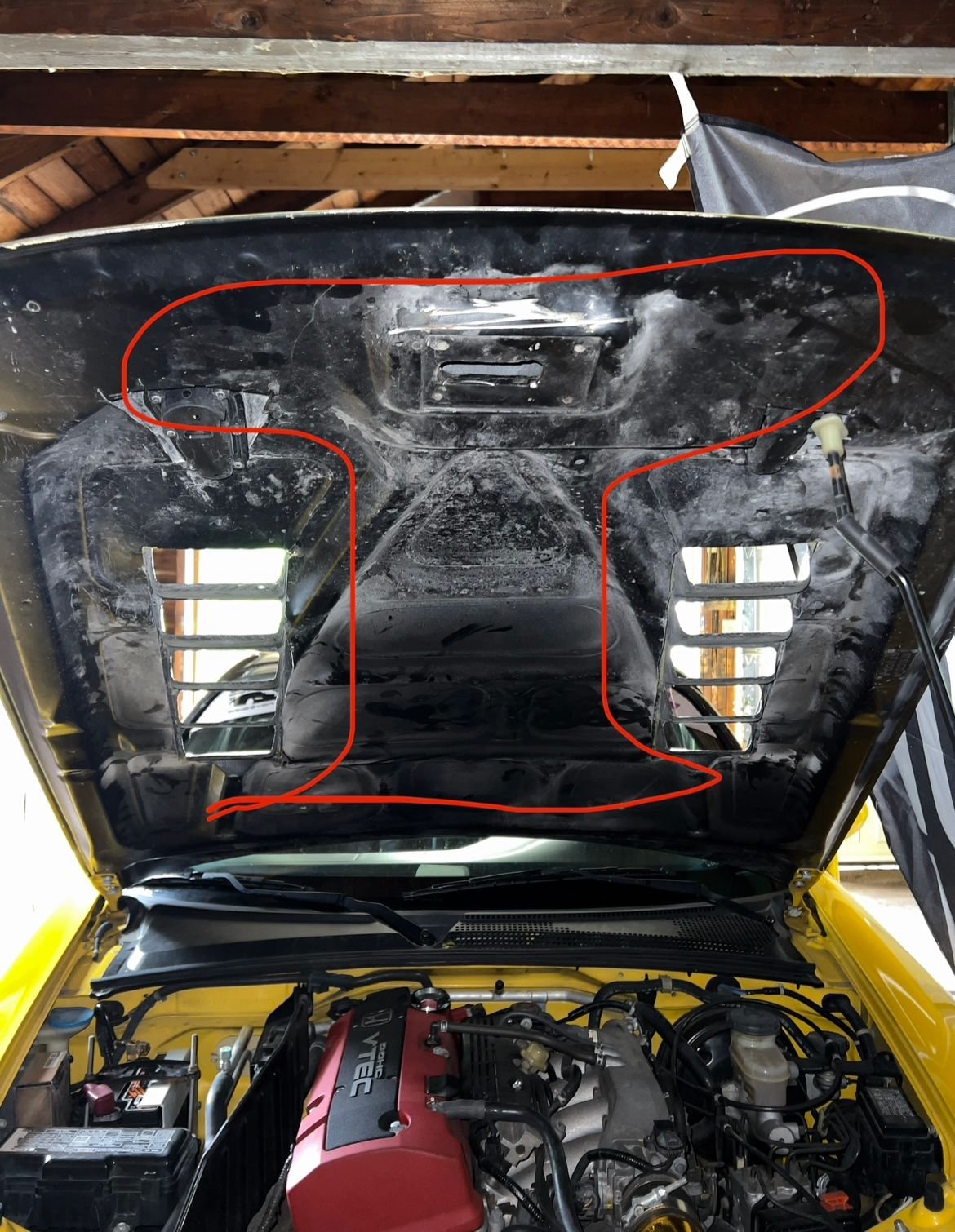

The next order of this is cut some material off this hood and hopefully cut down some weight off it. I’ll be happy if I can get it down to the same weight as the aluminum OEM hood.

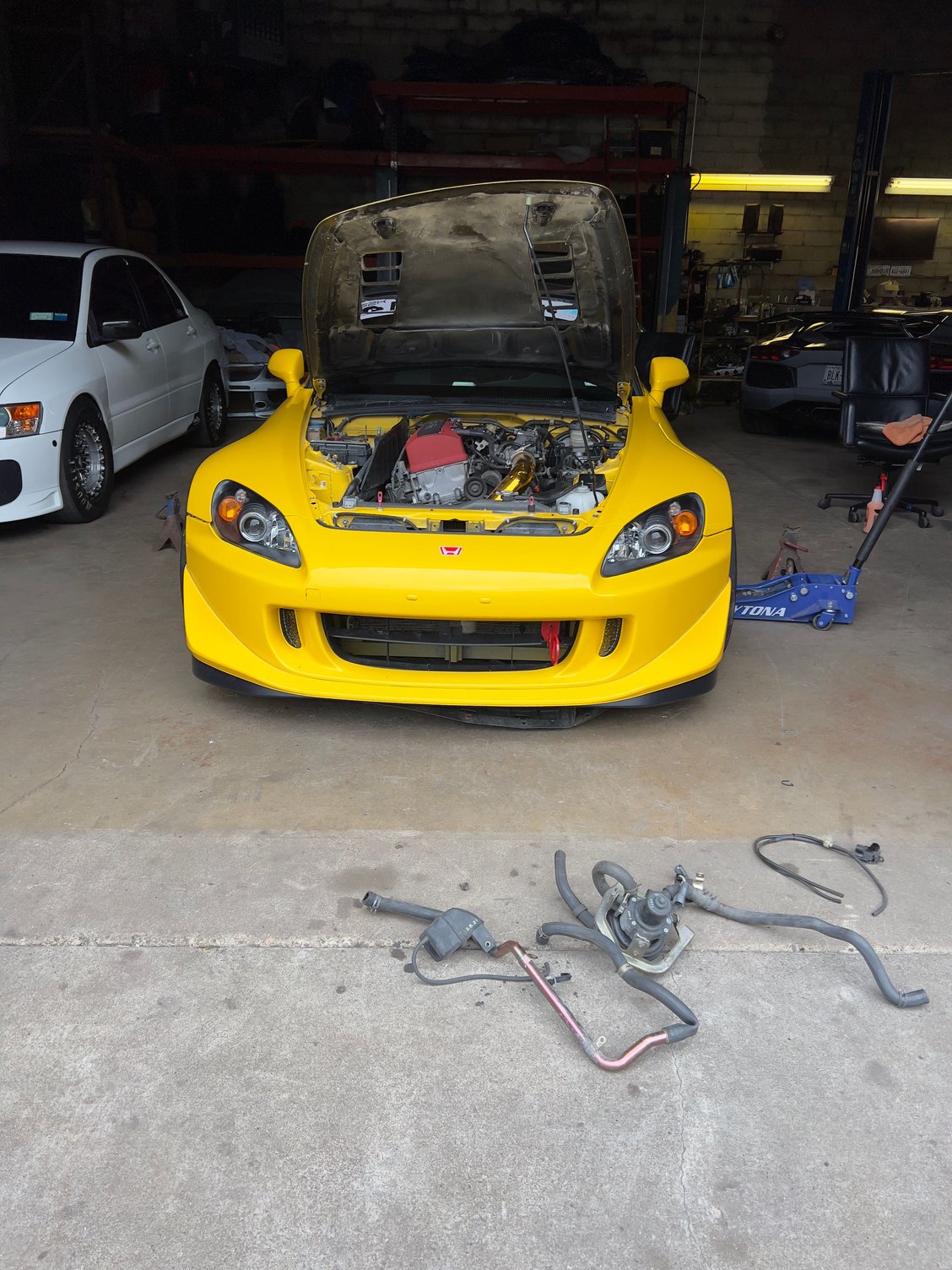

Spent a couple of hours the other day shaving off some unnecessary weight off the front of the car.
Airpump system -9.1lb
Windshield wipers and motors -5.9lb
Hood Structure -3.7lb
I had the air pump delete simulator laying around for over a year. I was able to install it and seems to be working fine. Next up, will be the passenger airbag removal, and depending how much the plastics behind the cabin weight, those might go too.

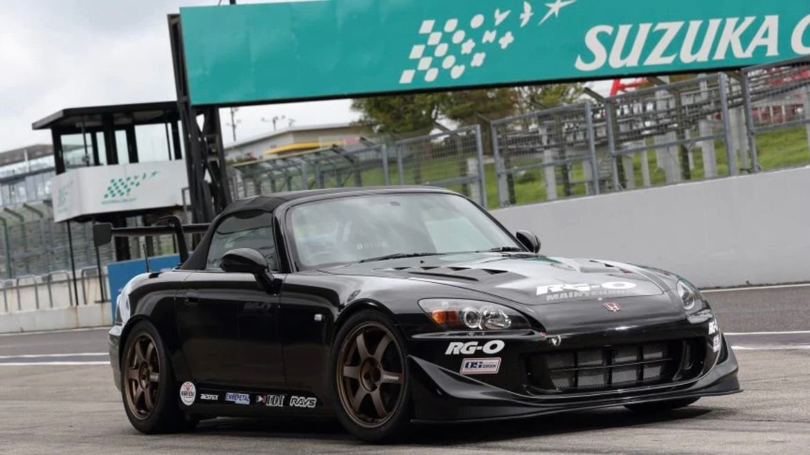

Lately I’ve been drooling over the aero profile of this RG-O race car. Flows well with stock body. I don’t think I’d want to wait the 18 months it takes to order
