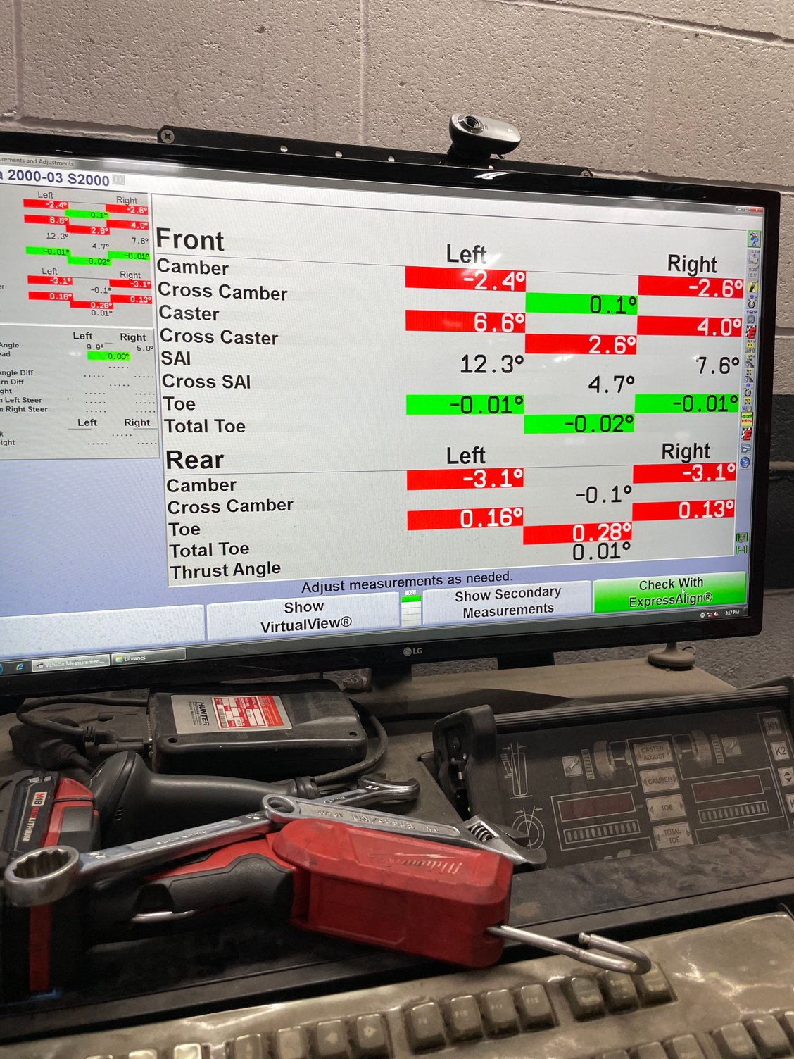

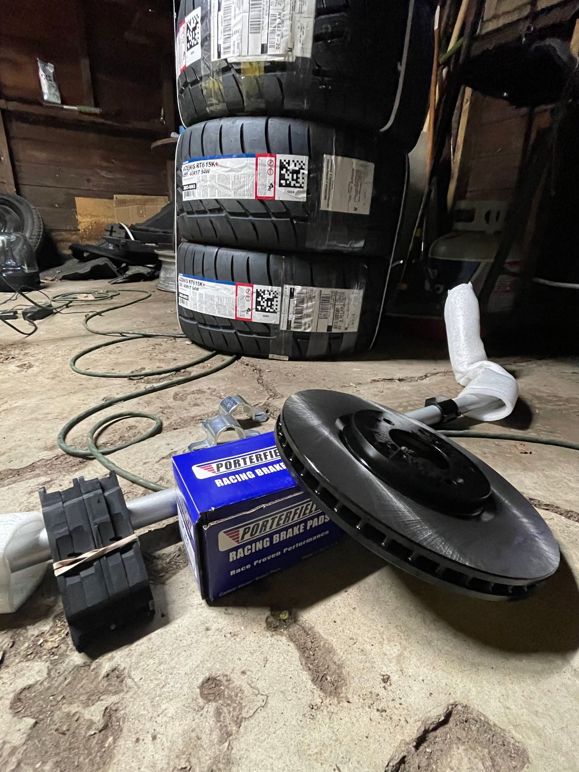

A few small upgrades just before touch down at the track this weekend
Porterfield R4 pads
Centric blank rotors
New Falken 615k+ tires
Whiteline front swaybar
SBG lowering forks
Running into issues setting caster. This was the closest I could get them too. The car drives ok but lost a lot of steering feel. This is something I need to get to the bottom of asap. I was also hoping for about a degree more camber at the front.

Check your compliance bushings. When mine were seized (and eventually torn) I was having a lot of trouble getting the caster and camber I wanted.

The control arms are new, with new alignment hardware. We must have installed something wrong I think. I were able to get decent numbers even with seized adjusters before

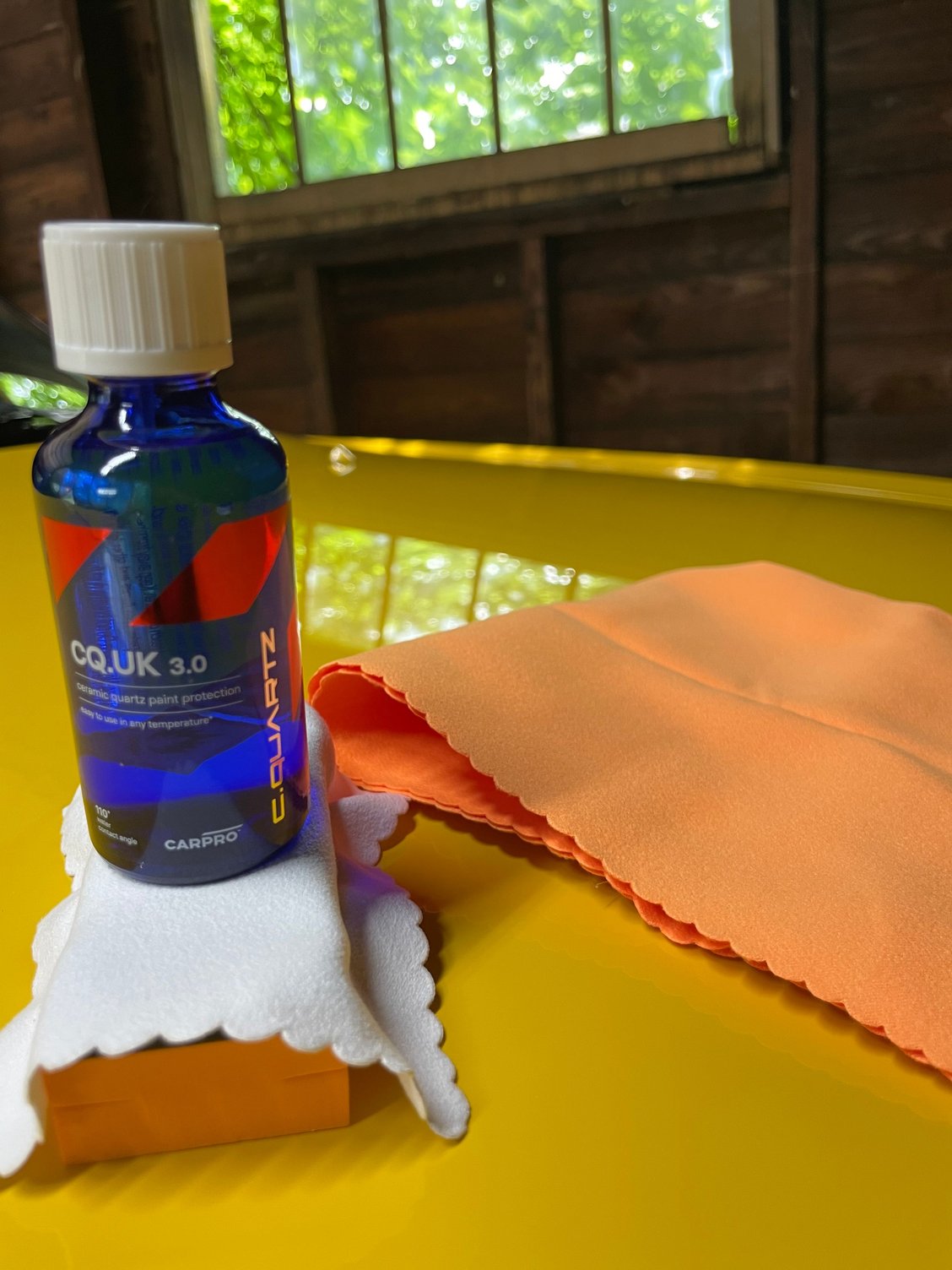

Removed the wax and applied CQuartz UK3.0 Absolutely love the results

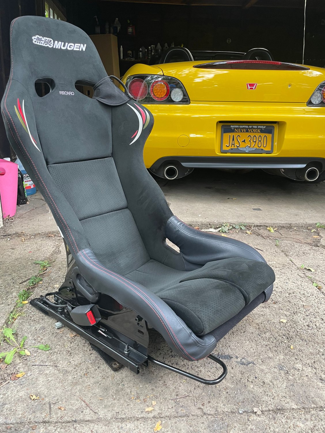

In September I was able to pick up a Mugen MS-R seat with Recaro Japan Rails from @Orjinal. The seat was in great condition and I fit perfect in it. It is every bit of what JDM bling is, with the added bonus of being fully functional at the track and dropping about 8lbs off the car.

I'm glad you're happy with the seat.

Great to see that it went local and your car is coming out wonderfully and that the Mugen Recaro seat found a good home. I was wondering where it would go and it's satisfying to see that it went to a racer and not a stanced car.
