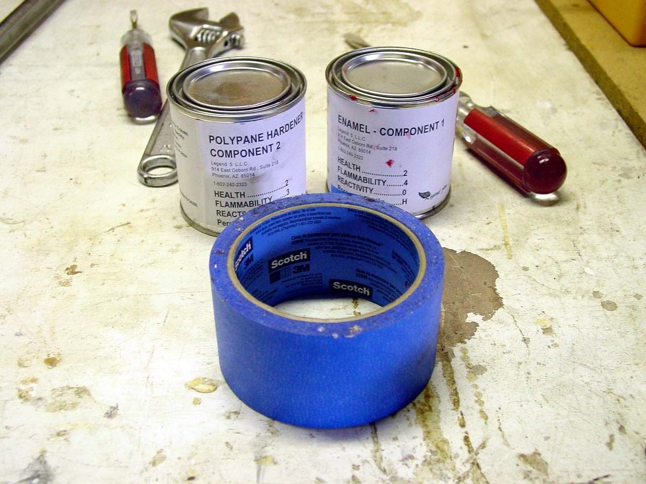

Legend 5 paint, a two part enamel paint available in a group buy from MPTuningUSA here.
Then the masking. I just used painter's masking tape on the rotors (its the easiest tape to get off).

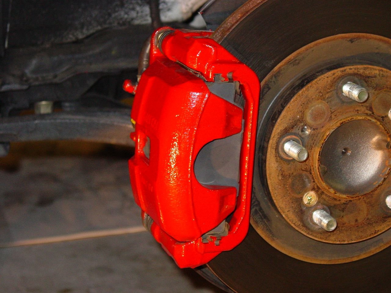

Then then I mixed 4 teaspoons of paint and one teaspoon of hardener which was more than enough for a first coat on all four calipers. I chose to take the calipers apart and remove the pads. I did NOT disconnect the break lines to avoid having to blead the brakes.

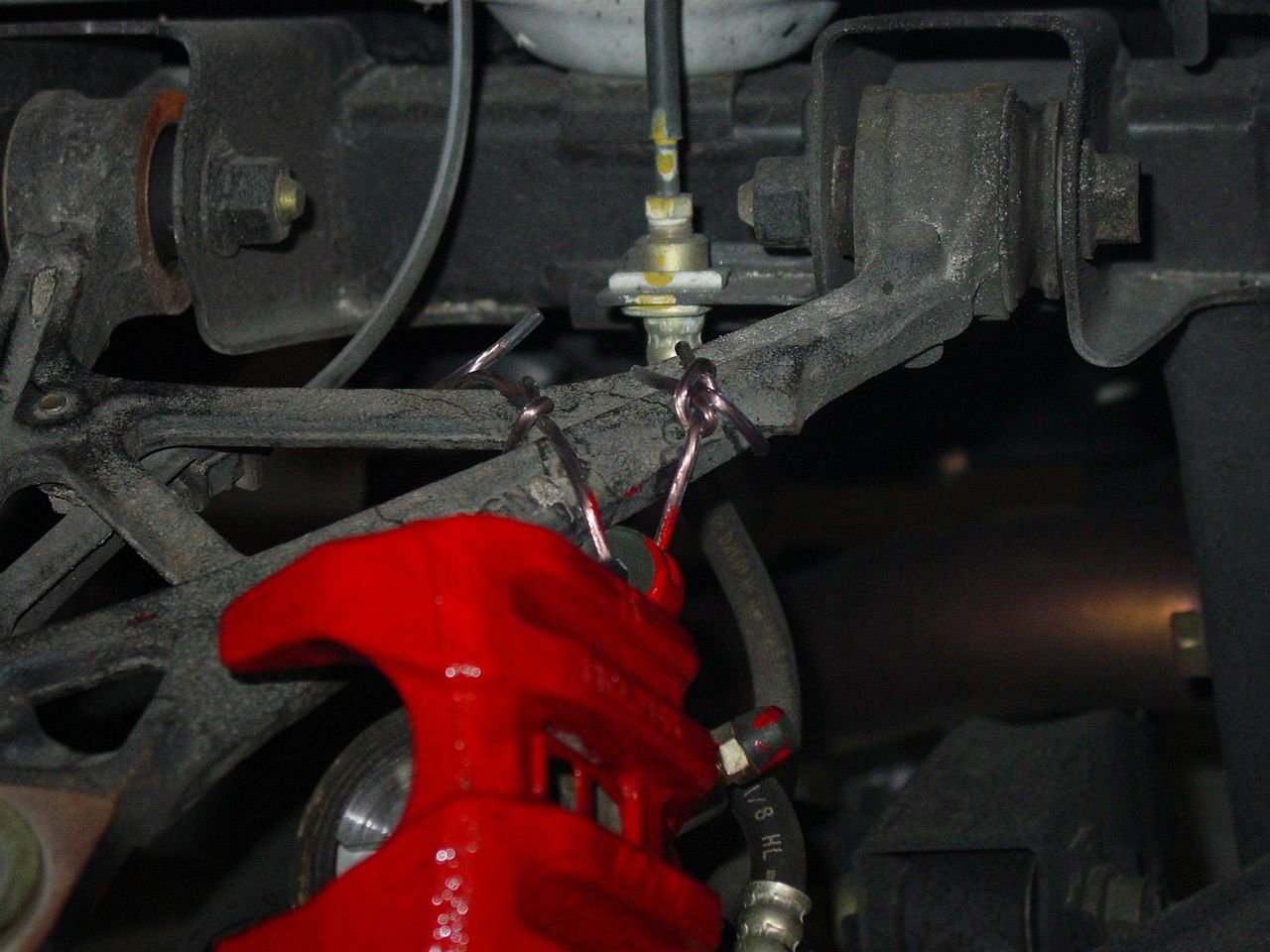

VFROOM came up with an ingenious way to hang the calipers from various suspension parts to help hold them while painting.
Brush on a light first coat. Let dry for at least 4hours. Then apply the second coat. I let the second coat dry a full day before putting the wheels back on.
