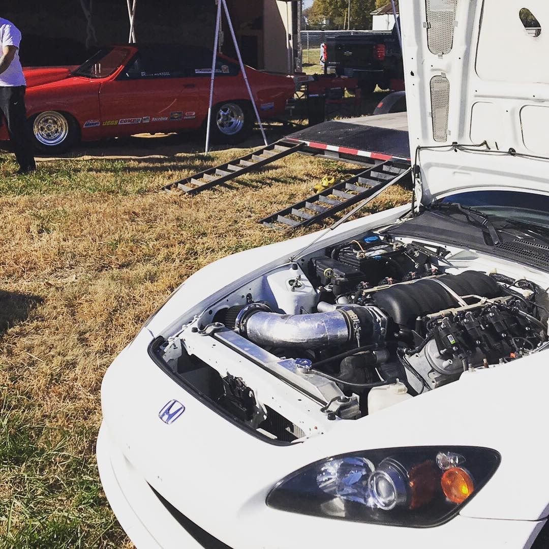

Little update. Ended up tearing the harness out, sent it back. I received it late yesterday; same shit. Finally realized the ECU wasnt powering on at all. Realized they didnt splice the power from the right wire on the c101 where the mfg. does. Spliced it in and voila! Got fans, coolant gauge, and no immobilizer flashing anymore. Everything is good now except for alignment, exhaust, and I believe my throttle pedal is just dead. I might have welded onto it a little to much. Maybe the sensor got fried.

No annoying vibrations that I can blame on the swap. I have a little exhaust vibe going on only because it seems to hard to find an actual exhaust shop that knows what they are doing. It just sucks you dont get what you pay for these days. The exhaust is the only thing I didnt do to lol (go figure) its messed up.
Idk if I can actually complain about the steering from stock but it does have a wider turn radius now. (Only thing I can complain about)
I have been to KC, Topeka, TX, wichita... finished the swap with roughly 91k and im at 103k now lmao.

Awesome pics the swap came out super nice.
