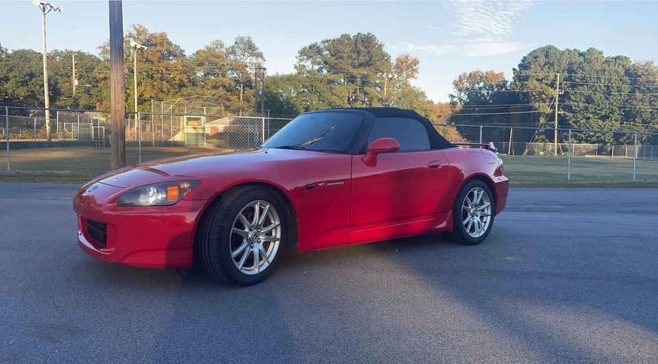

So now, how about a formal introduction.. I am Scott a 67 year old man (well in a week) that has just purchased a 2005 in the New Formula Red color which I understand to be the fastest color! It seems in excellent condition with a few items that need tended to, which is expected in an 18 year old car. I have had it a whopping 2 days now and am still learning about it and how it drives. Highly impressed so far, thanks for letting me in the club!
Scott
[and how do I get one of those car pictures I see here ? ]
Here are a couple pics of the car..

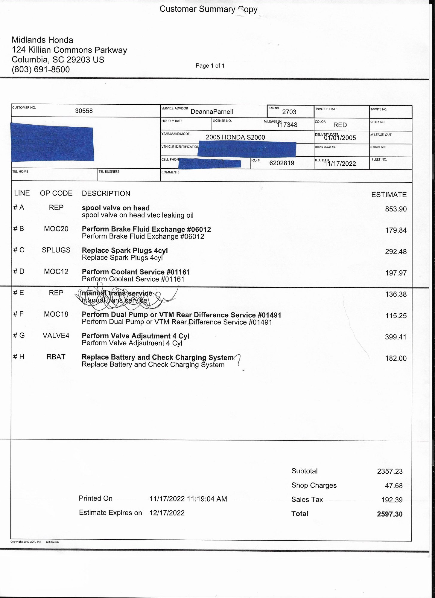

Just got back from a Honda dealer getting a spare $150 key!! Holey camoly! While I was at the dealership they did a complimentary 122 point inspection on the car indicating about $2500 in repairs needed, including $300 for 4 sparkplugs! Not to concerned about all the things it supposedly needs but thought I would post it here for fun and maybe get your guys thought on it. The service writer scratched out the trans service and told me I should never do that or change the fluid in it, I thought that was weird. Very nice lady however.

Absolutely change your manual transmission fluid.
Never take it to that dealership again.

Yesterday when I took it into the dealership to get a new key I attracted a small group of employees checking it out oooing and ahhing.. Also if you look at the estimate above what it that spool valve on head leaking oil ($853.90) anything to worry about and how hard is that for me to do? And $300 for 4 sparkplugs??

Three hundred does seem like a lot to change plugs it is a pretty straightforward job unless they are the originals then they may be a P.I.T.A. to remove.
Not sure what a spool valve is hoping someone else chimes in on that.

Not sure on the spool valve either, and I didn't see any leaking.

All the maintenance recommended by the dealer is good to do but you can do it easily especially in that mammoth garage. Recommend a small lift (similar to QuickJack) or at least high jack stands for most chores.
Have no clue what a "spool valve" might be.
Maybe the shop has language issues? I'm sure the "rear difference service" refers to the differential. This is listed in the maintenance schedule in both the Owners Manual and Maintenance Manual (which you downloaded earlier this week). Required differential oil is listed in the Owners Manual.
Yes, you will want to change the brake and clutch fluids. And the antifreeze. Change the engine, gearbox, and differential oils. Photo essays for all are in the library here. Investment in tools is minimal. Use the specific Honda S2000 oil filter.
Sparkplugs are pre-gapped. Unscrew the old, screw in the new. 10 minutes.
Valve adjustment is a Saturday morning job. Putting the car on a low lift or jack stands will save your back.
