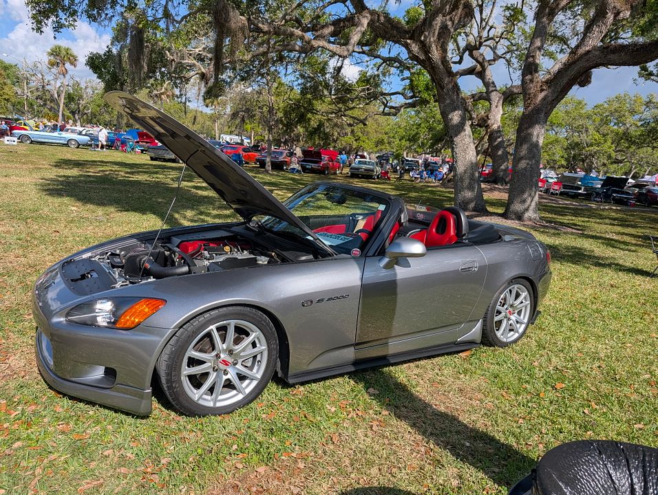

When I bought my (used) S2000 11 years ago I started looking for a hardtop. They're beautiful on the car. Prices kept me at a distance until I accepted the S2000 is a convertible and even the soft top makes it claustrophobic! I can barely see out of the thing with the roof up. Especially hard for me to back into my driveway and garage unless I lower the roof and reset the mirrors. No problem as it only takes six (6) seconds. If I really want a coupe I'll buy a BRZ.
2001 cars are very early cars still exhibiting much of the "race car" theme of the year before which didn't even have a clock. 2000 and 2001 cars have a reputation of snap oversteer in tight corners -- these are not front wheel drive Civics. Honda spent years dialing this out with major changes every two years, the even number years. Just watch braking in the corners until you're experienced in how the car handles. If the roof is shot there are aftermarket roofs with a glass rear window like was standard starting in 2002. Also the 2004+ OEM 17" wheels will just bolt on, not mess up ABS, and will provide more tire choices. Aftermarket wheels are hard to fit due to the offsets and stagger of the Honda OEM wheels. I'm not aware of anyone with regrets updating to the AP2 17" wheels vs the smaller wheels. Tires are staggered on this car, front wheels and tires are narrower than the rear.
