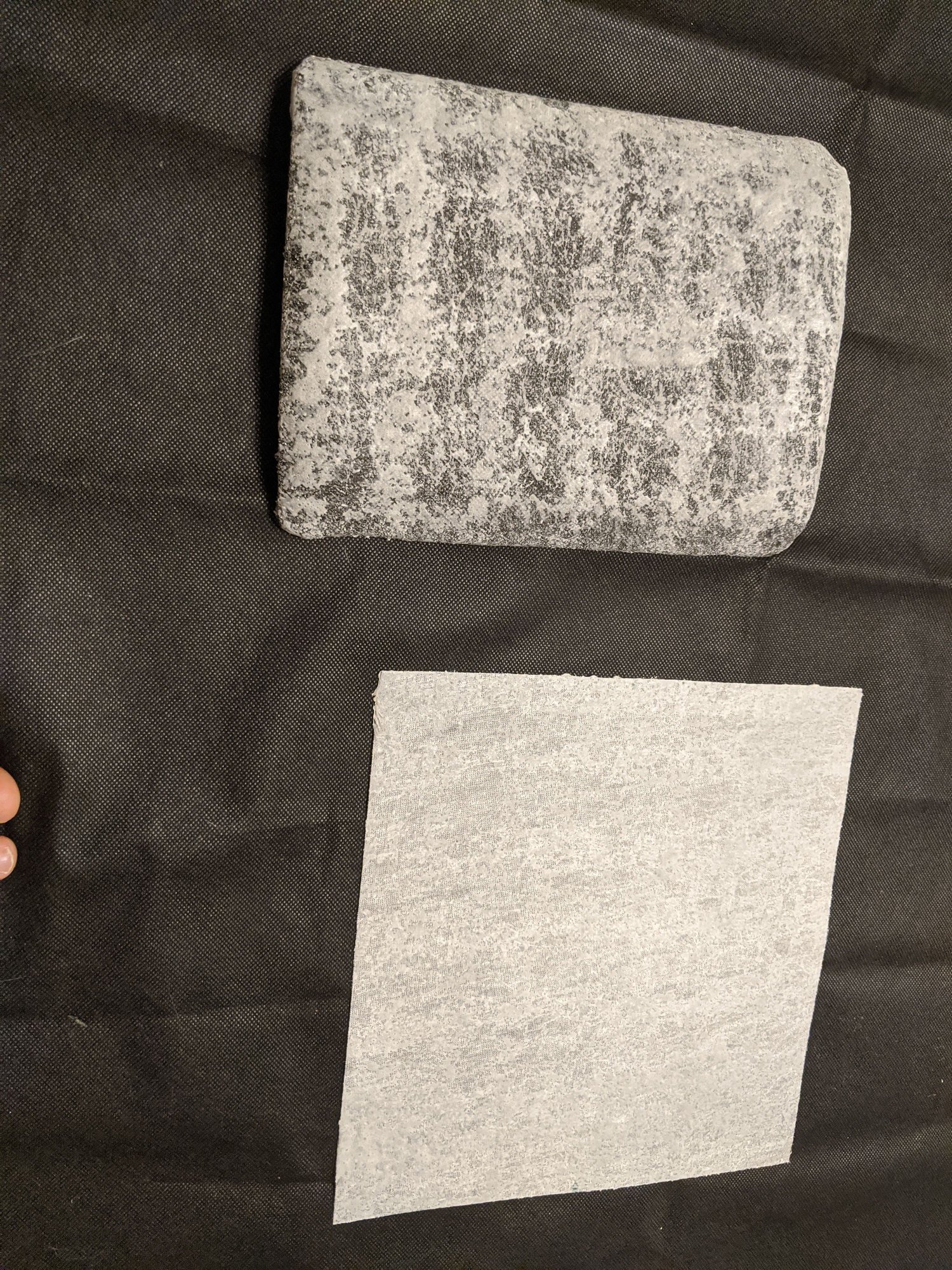

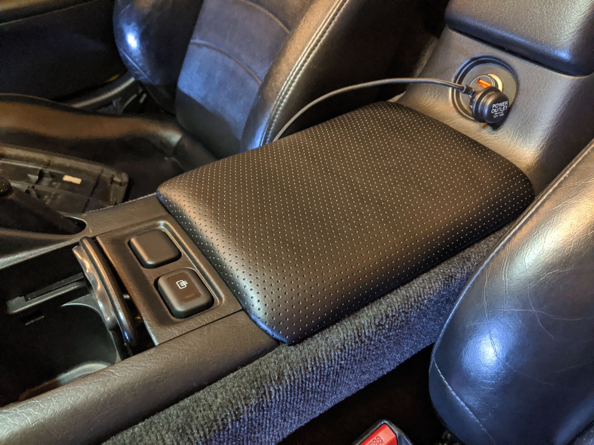

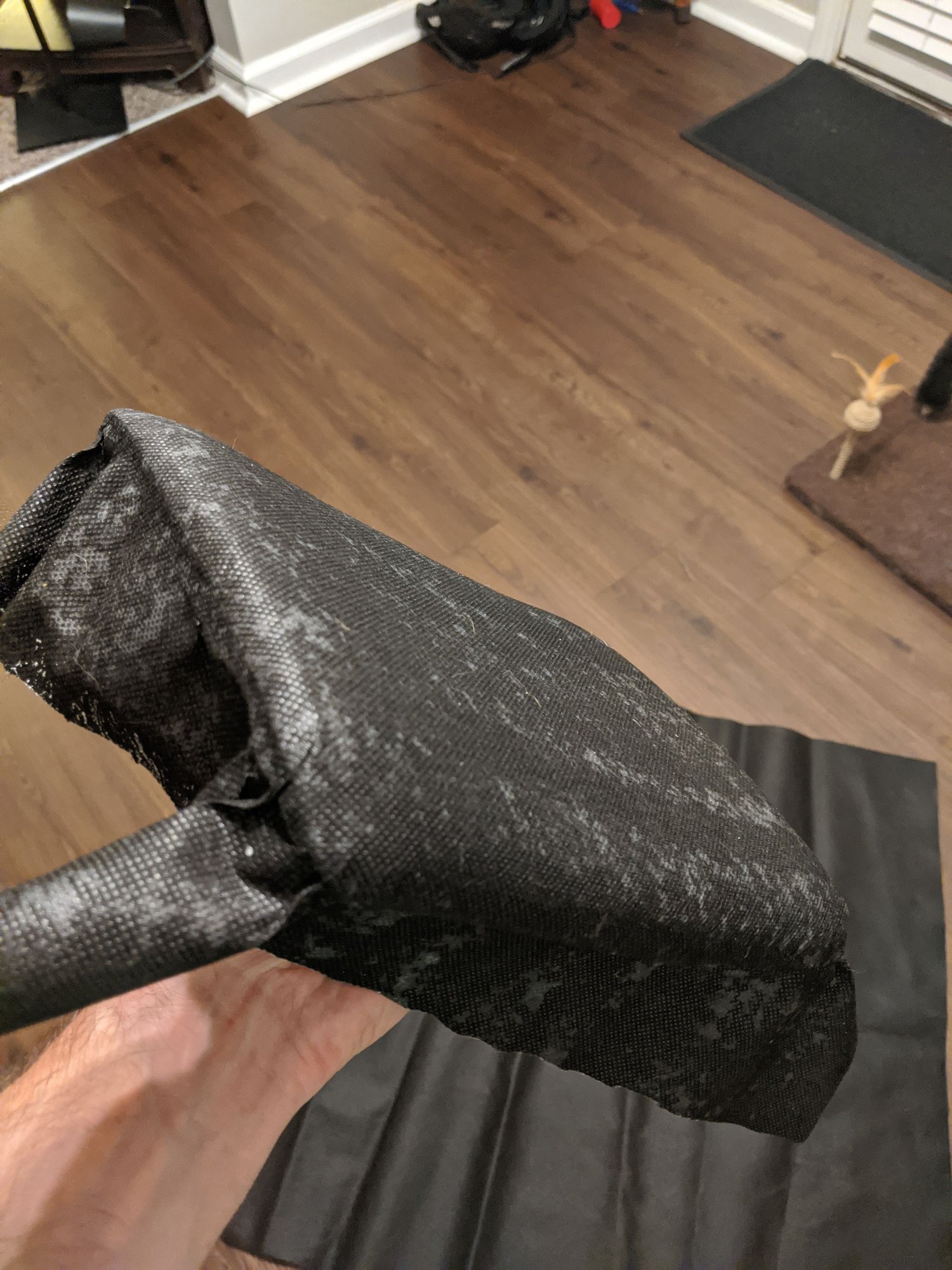

Welp, was drinking and got bored so. Figured this has been upstairs for a year and I was working on pulling wires in the center console anyway so..
Bare Plastic and foam
Foam adhered and trimmed
Liner sprayed
Liner on
Trimming and adhering the edges
Liner done
Last layer, marked to line up
Wrapped and trimmmed
Old vs new
Thickness difference - oh yeah my elbow
PS Incase anyone is curious. The liner layer was to form the foam so that the leather liner could be applied straight without pulling and deforming the perforation lines from straight.

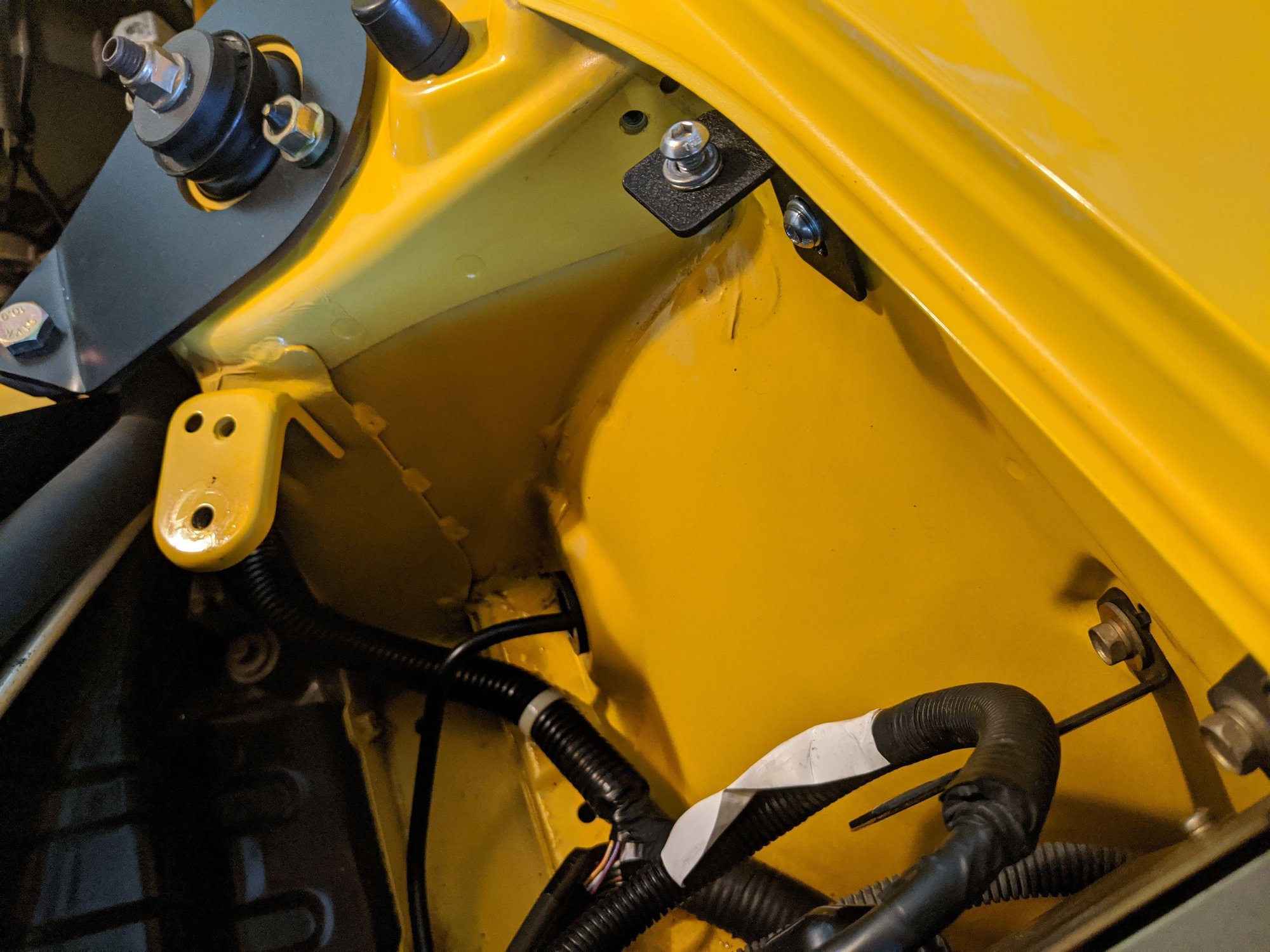

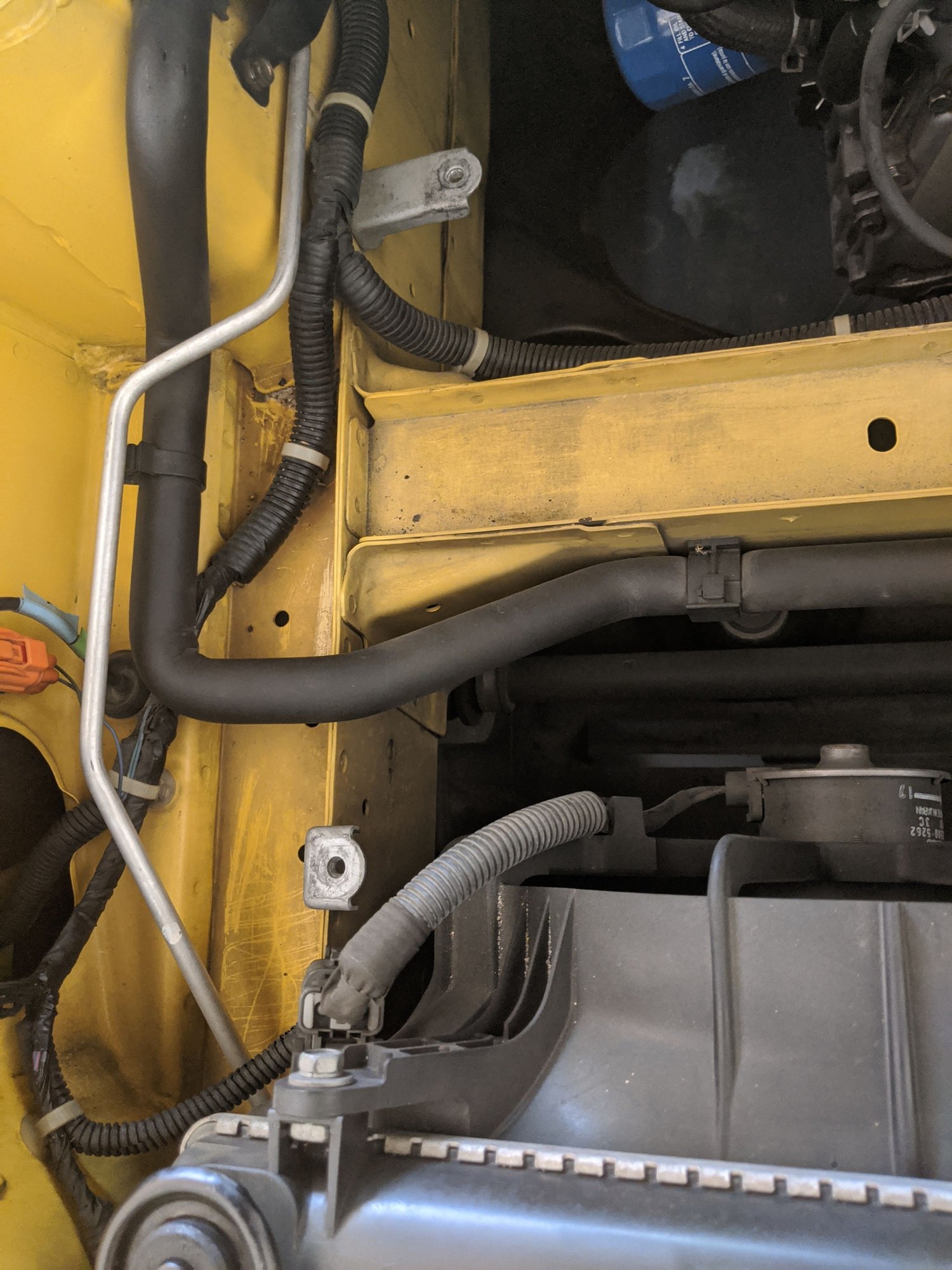

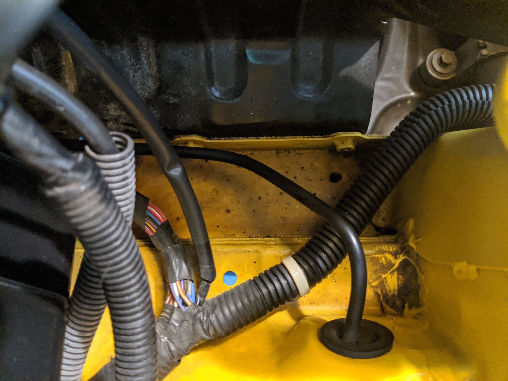

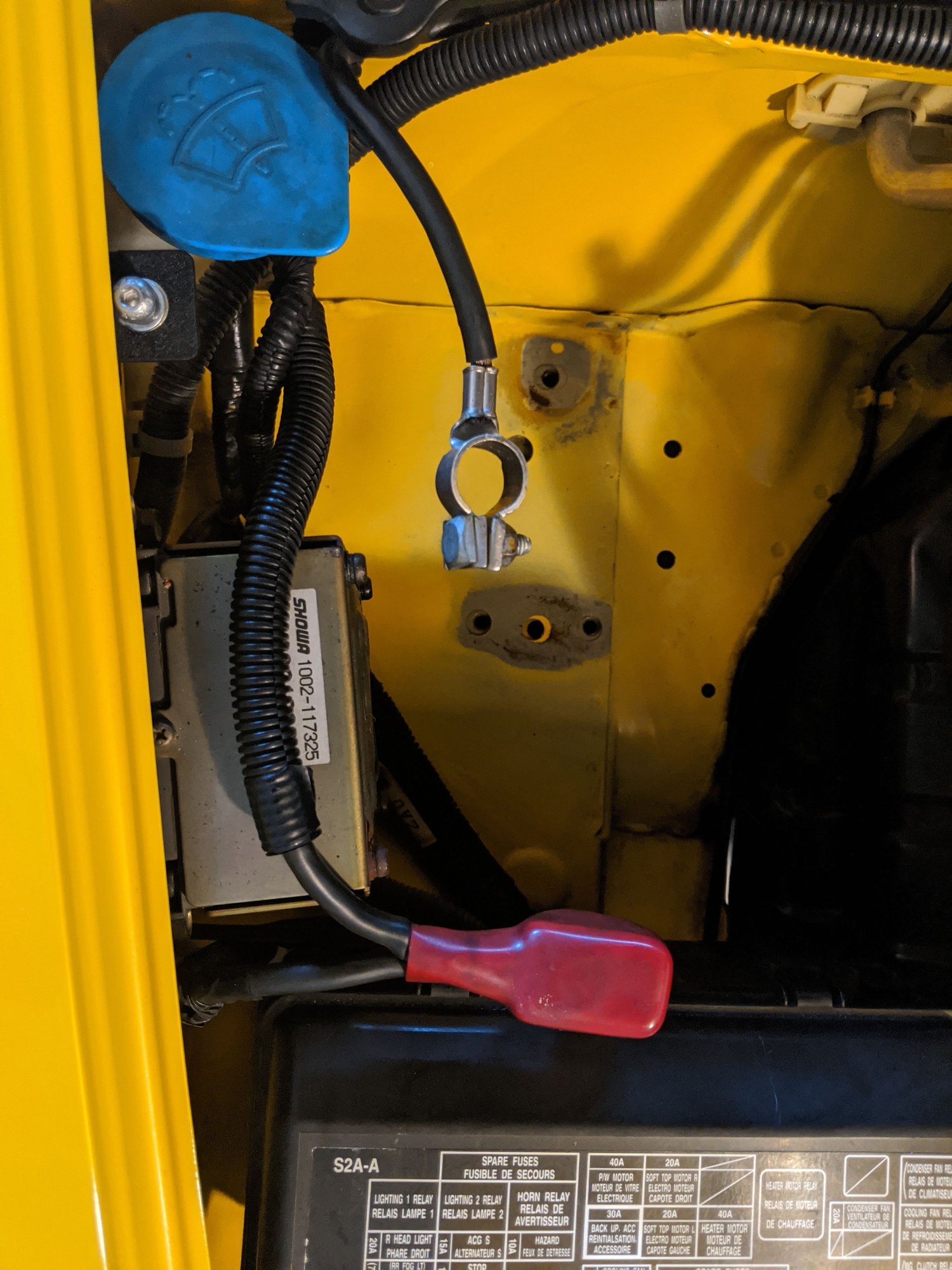

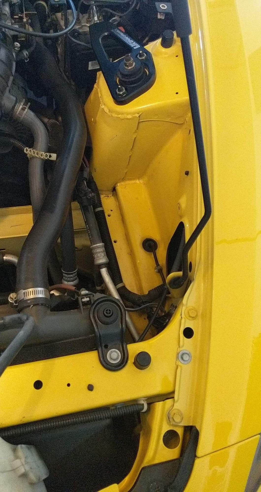

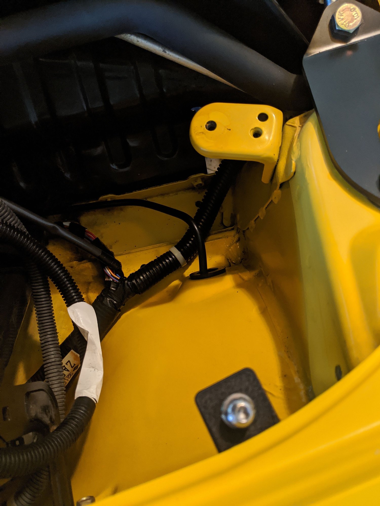

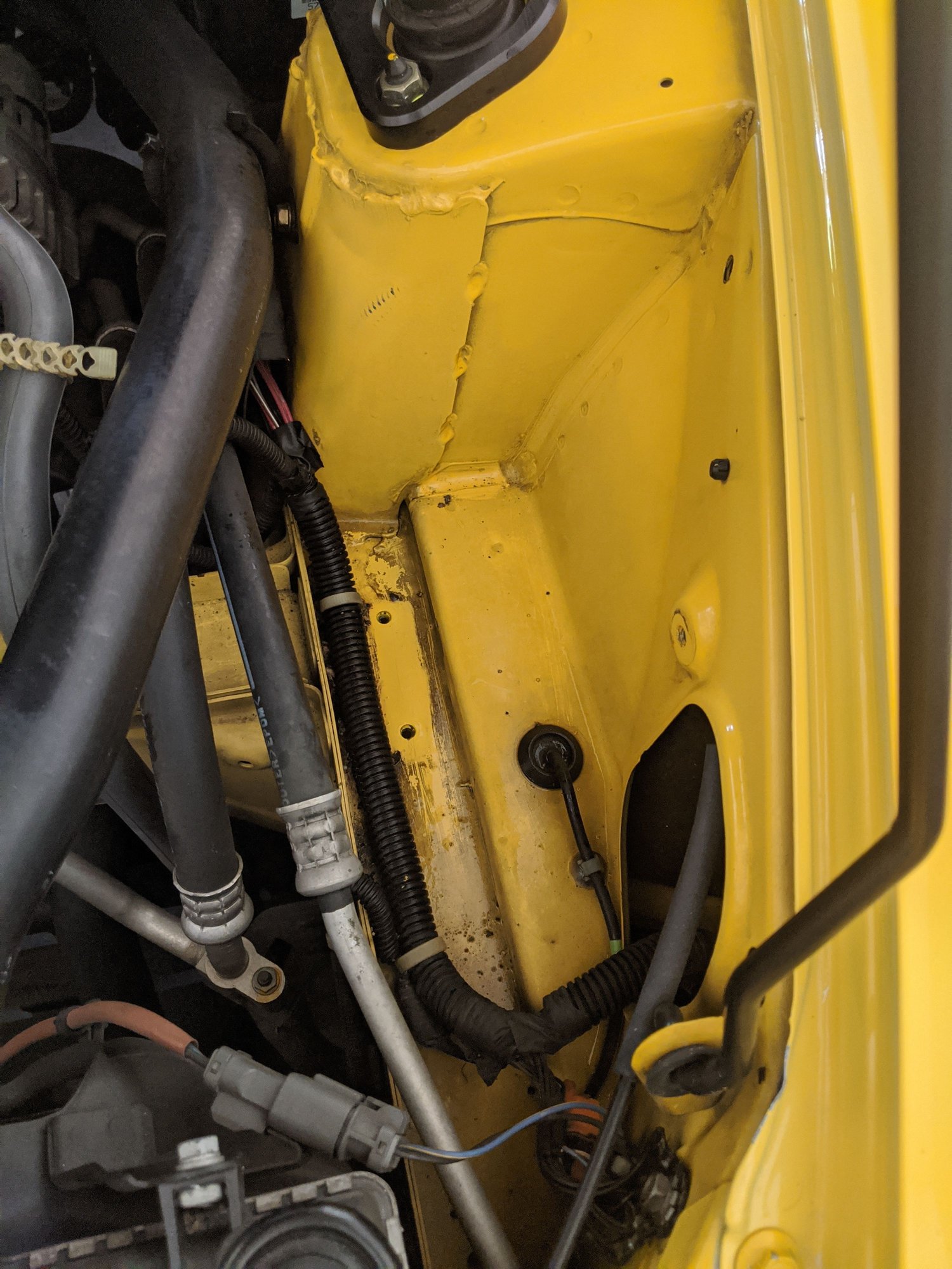

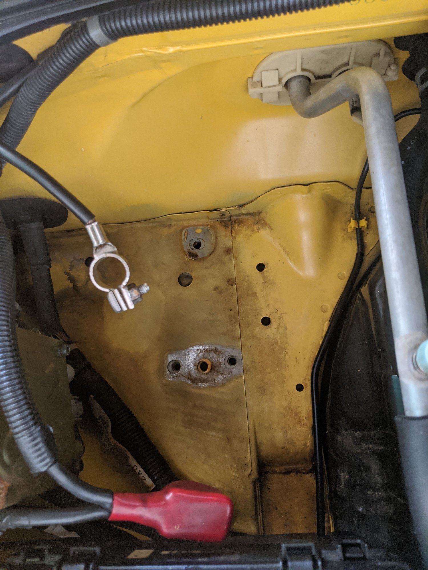

I went to pull the amp power wire today through the firewall. And ended up on a completely different project. -_-
I pulled the battery and went "oh God" and proceed to pull alot more out and start claying the bay.. because you know I like torture.
Still got a few more corners on the driver side to hit but maybe now I can pull wires and be satisfied it's not so damn dirty. Phew. My arm hurts. Lol.

My car has yet to reach 25K miles. Still, the car is about 18 years old. I doubt the bay has ever been cleaned. It looks ok, but honestly not great. I want to pull the battery, pull the air box, cover up any sensitive elec. stuff and have at it some afternoon. It really makes a difference. I was thinking a hose, a weak de-greaser in a spray bottle, and some soft brushes would probably do the trick. I should have done it the other day when I had the heat shield out while doing a VA. That also opens things up a bit. Anyway, your bay is gorgeous. No one would believe it if you told them how many miles your car has on the clock. It really looks great.
Did you use clay? I have not used clay much. How does that help the job along?
Old Jun 21, 2020 | 07:12 AM
  #290
Deckoz's Avatar
Joined: Jun 2018
Posts: 714
Likes: 158
I used clay, and a watered down Super Clean(Degreaser) as the clay lube lol. Degreaser wasn't doing it on it's own. And clay wasn't doing it on it's own either. I've previously degreased with a brush and power washer, but it never really pulled this stuff up.
I went through a whole clay bar, and several rags. So on the scale of how harsh was this? Pretty Harsh. But it's the engine bay and stuff gets baked in. I can't fit a polisher in there, and pads and rags, would get contaminated too quickly. So Clay was used to keep the cleaning surface 'clean' by continuing to keep folding clay. And normal clay lube doesn't have much emulsion properties to lift and suspend, where degreaser does.
I'd never use degreaser with clay on the outside of the car. But for this 200k+ of baked on gunk in the bay, it worked really well. As I needed some type of abrasive, a cutting compound would have left me needing to polish, and would have been extremely wasteful of the compound.
This combo fit the scenario.
I used a wet shopvac too, as I did this in the garage, more towards the side of a "rinseless" wash, where i'd soak and adgitate, and suck out all the big dirt/grease blobs before using media(rag/clay) to continue
