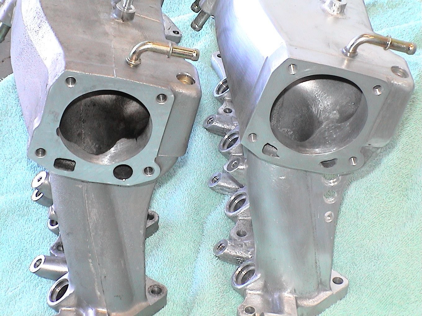

Is that a S2k manfiold - 1st and 2nd one look different. The holes on the bottom part of the TB don't match!
Old Mar 8, 2007 | 09:50 AM
Sideways's Avatar
Posts: 9,033
Likes: 21
From: South of the pier, Huntington Beach, CA
The one on the right is welded and opened up to 70mm. Notice the gasket mating surface increase over the 66mm non welded version on the left. The factory is 62.5mm.
