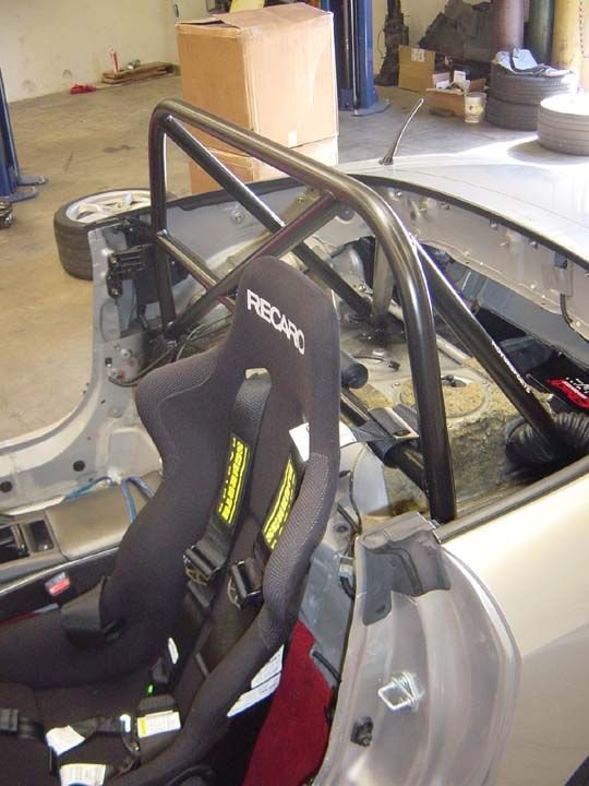

The best bolt in one that works with the softtop/SCCA legal was the Elda Engineering-which is no longer in production to the best of my knowledge. Wael and Bassem, as always, really did an excellent and thorough job designing it, though probably at a loss. Replicating that design would cost more than a custom bar.
A good roll bar will void your softtop. I think you want something like this what this fabricator built...

Yea, i loved the elda bar, that thing is sick. I want something thats going to be functional, because i want to get into racing, and i want it to be used with the softtop.

Custom Bar is your only option right now.
