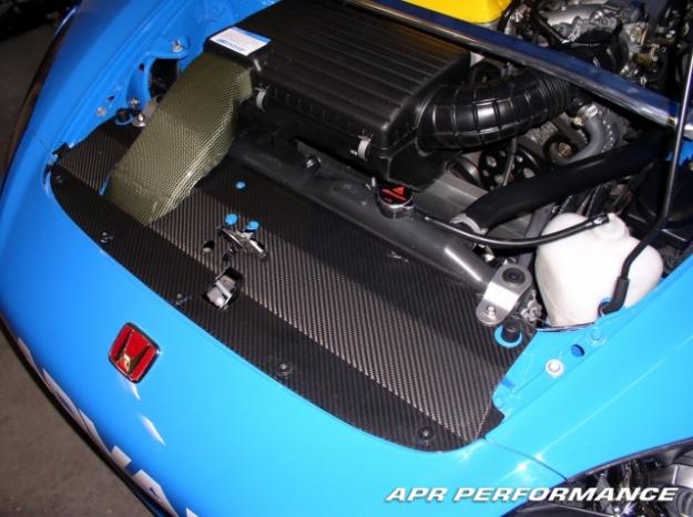

You don't need to remove the resonator just cover up the access hole from inside the air box, I just glued a square piece of plastic over the hole. The only reason I did it is because the resonator is the hottest area of the oem box, seal it off and it will keep hotter air at bay. I would keep the resonator as the air box solenoid bolts to the resonator on my ap1. I run a J's Racing snorkel designed for the oem hood, I think it is a better fitment than the Spoon, some people find that the Spoon snorkel hits the hood leading to stress cracks. I run the oem air filter.

Nice ASM bar
btw, how much of the radiator shroud did you have to cut? just the top part to open up a slit?

Thanks, yeah this bar is my favourite out of four or five that I've owned, it actually feels like it's doing something.
On cutting of the air dam I actually had to cut a bit more than first expected. The J's snorkel angles towards the front bumper as it goes over the front frame bar so you actually cut out a fair bit to get the snorkel through it. Hard to tell in the picture. It was pretty easy to cut though, very soft vinyl.
