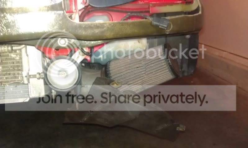

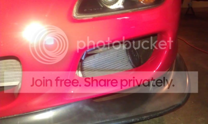

Lastnight I braved the heat in the garage and improved my intake set up. When I bought the car the intake filter was just off a 90* coupler from the throttle body. Nice placement but obviously only inhaling hot air. I installed the intake piping to put the filter behind the driver side bumper opening for more horsepowers!
My friends rx7 that's next to mine in the garage with the same set up. This is how mine will look once the bumper is back on.

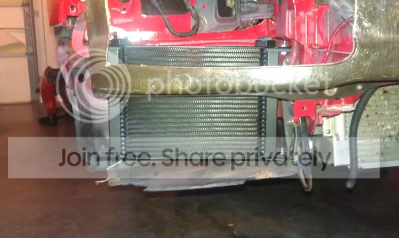

Today I mounted the setrab 25 row oil cooler. The oil cooler is behind the same bumper opening on the passenger side.
A little off level but won't be noticeable once the bumper is installed.

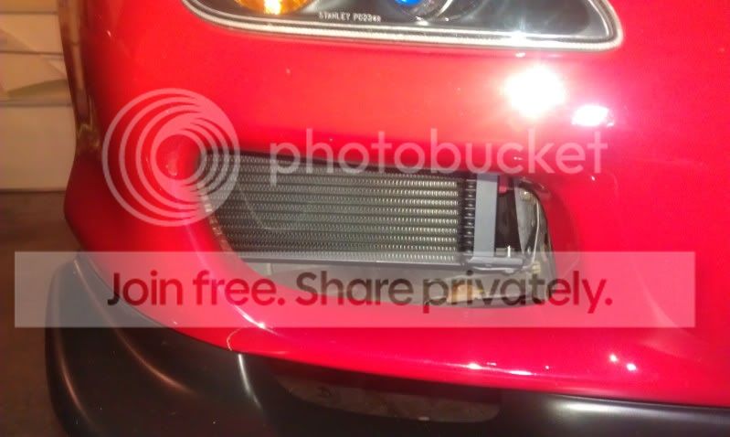

Bumper loosely placed in front. The opening will actually sit fairly close to the cooler, which is great because it'll keep the air directed where I want it.

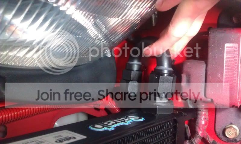

Headlight down, showing 180* -10an fitting sitting on top of the oil cooler. It'll be a close fit but should work.

Watch out for water and heavy rain with the air filter down there, you don;t want to water lock the engine.

I don't typically drive the car in rain, that's one of the reasons I decided to move it there.
