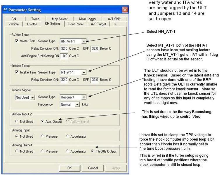

you shoud not have any settings here if you are using the stock injectores 0 CC/min and 0 delay what is shown is the setting used for the Greddy turbo kit and close to what is used for the SOT roots supercharger
Analog output shoud be set to deactivate in your case unless you are modgulationg the TPS for some reason

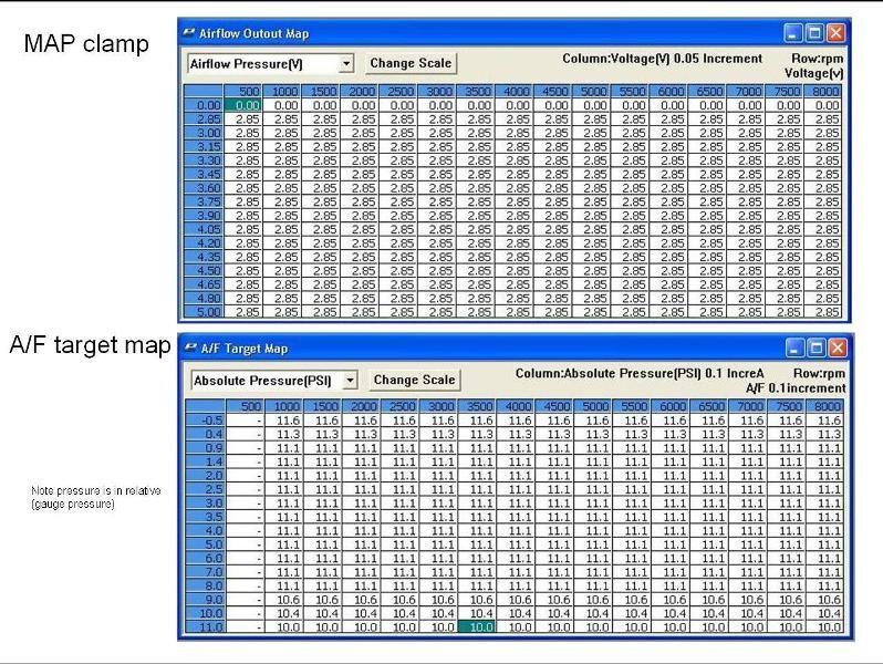

Using air flow output map is only one way to clamp the map sensor boost limiter is another way. and A/F map (if you end up using this feature) shoud be in Relative pressure not absolute

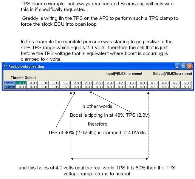

This is shown here just as a reference in case you are using the ULT to change the TPS for some reason. The AP2 Greddy kit used the TPS map below; likewise the SOT Supercharger is also using this map to change the TPS ramp since boost comes on with as little as 20% throttle
