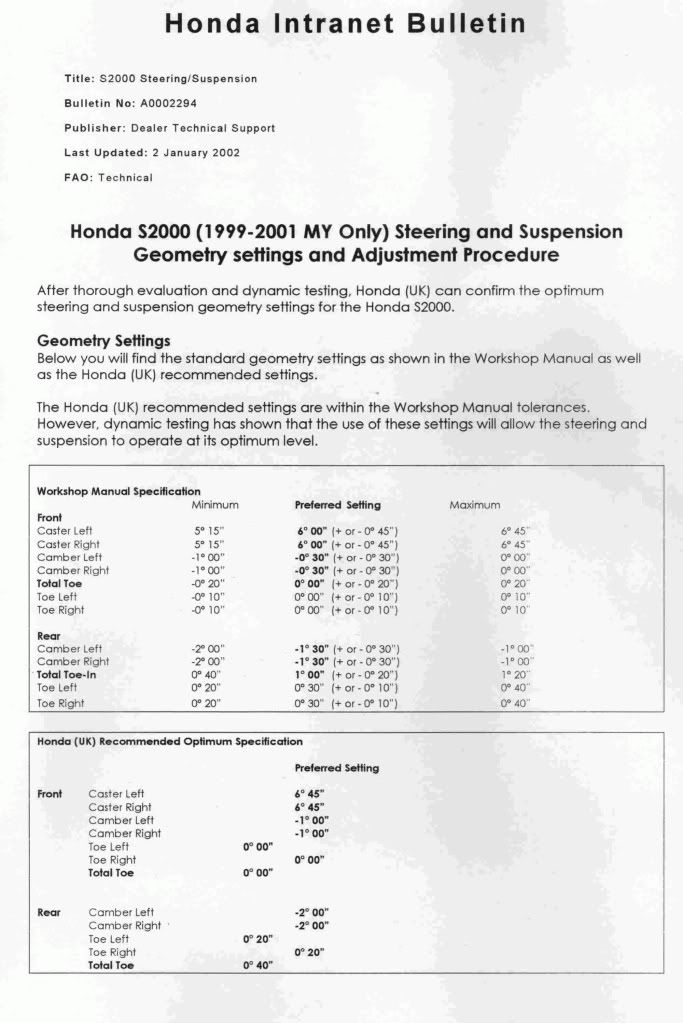

Already ordered new wheel setup, 17x7.5/+50 & 17x9/+63. Will be running 225/45/17 & 255/40/17. I am thinking about going back to OEM CR specs or maybe even UK specs. Then again after I make these changes it will most likely change again when I purchase coilovers, but this is what I'm thinking of right now. For now, since this new wheel setup should have no rubbing issues I might just go for OEM, just to save tire life.
Just wanted peoples thoughts on the specs
or any recommendations
I'll throw the UK Spec Sheet in for those who aren't familiar.
Definitely need more camber up front. Bump it up to -1.5. Look in the R&C thread and you'll find most guys are running a bit more camber up front. I think with only -.5 you're probably not utilizing the entire contact patch and probably starting to roll over to the sidewall a little bit. I suspect with hard driving you'll find the outsides of the tire wearing more than the inside. I'd say rear camber looks just fine. I'm not sure if I'm the best judge though as I run a lot of camber all the time. Not excessive but more than most.
Oh yeah I didn't even see your rear toe setting. For toe I always just use the factory setting front and rear. It seems to work very well and doesn't seem to make the car unstable. I also run a non-staggered 255 setup. I have not done any high speed driving trying to make turns above 80mph though so I can't really comment on stability with my alignment but I will say the car feels absolutely great at 65-70mph.
