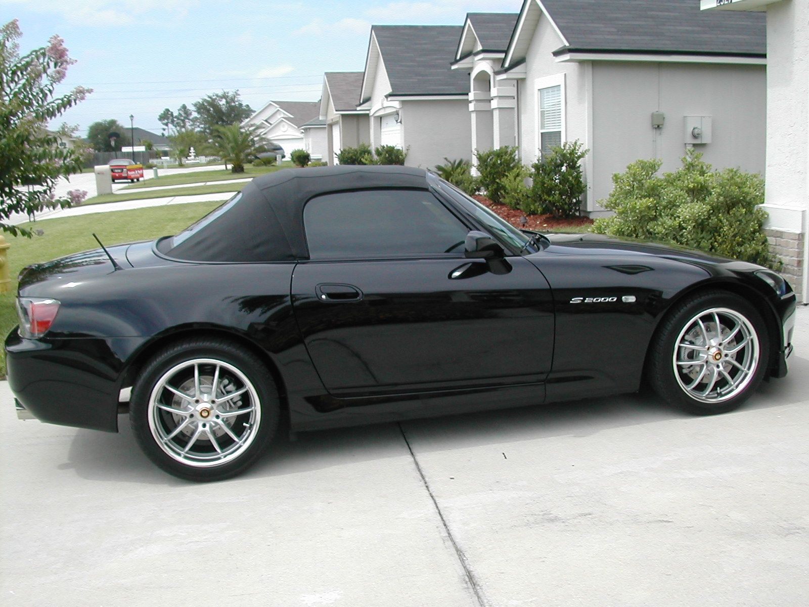

Check out the Spugen. Here are two pics. I have them as well but don't have any good photos of mine. I'm VERY happy with mine. Daily driver, no tracking. Plus I did pads, lines, and fluid. ...and here's mine but not a good shot of the rotors (sorry!)
