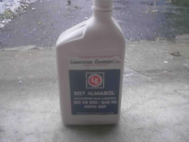

Hi Guys! Finally had the time to do a diff and engine oil change. Especially with this rainy day there is no driving
Wow, The diff change went pretty nice with that pump. I used to use a tube and attach to the bottle on other vehicles that I've done this but with this pump it was easy.
Used LE-607
And for the engine, now that I have 15,XXX miles I decided it was time for synthetic.
