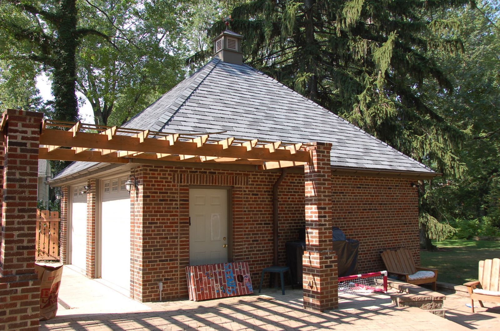

Damn, must have missed this during your original post. I love garages, built one about 6 years ago. Below are some things to consider (local codes may be different):
1. If you are going to have living space on the second floor, you need 2 means of ingress/egress (and jumping out a second floor window doesn't count as one). You will also need heat/cooling, water supply and drainage, electrical, insulation, etc. Think of it as building a mini-house.
2. Be sure to run stubs for all utilities/conduits, even if you don't think you'll need them right away. And a switch inside of your house that controls at least some of the lights in/on the garage is a good idea.
3. If you are planning on having a floor drain inside the garage, it needs to be hooked up to your sanitary system and a plumber needs to do it. If you have a drain outside of the garage, it can be done by the concrete guys and dump into your storm sewer/gutter system.
4. Its a good idea to have at least 6"-12" of either concrete or mansonry immediatley above your finished floor (inside). This makes hosing/sweeping much easier. Also, interior vinyl covering inside the garage is a good idea, especially if you plan to wash cars inside.
5. If you plan to have a lift, you will need at least 10' below the roof/ceiling joists. And make sure your contractor/supply house understands this. When I ordered my lumber, the yard glossed over this on the plans and sent me 9' wall studs. I didn't realize it until I was building the headers for the front doors . . . and three walls were already up. I was 2 long days into things and just went ahead with 9' walls but this really put a crimp in my lift plans.
6. Determine what items you have to have and which you are willing to comprimise. Also, you can stage things. For example, I wanted wood carraige-style doors but they were costly. I opted for inexpensive aluminum one with the thought of switching out for wood at some point down the line.
Below are some pics of mine, I would have loved to build it twice as big but the space that was working with just didn't allow. Good luck.
