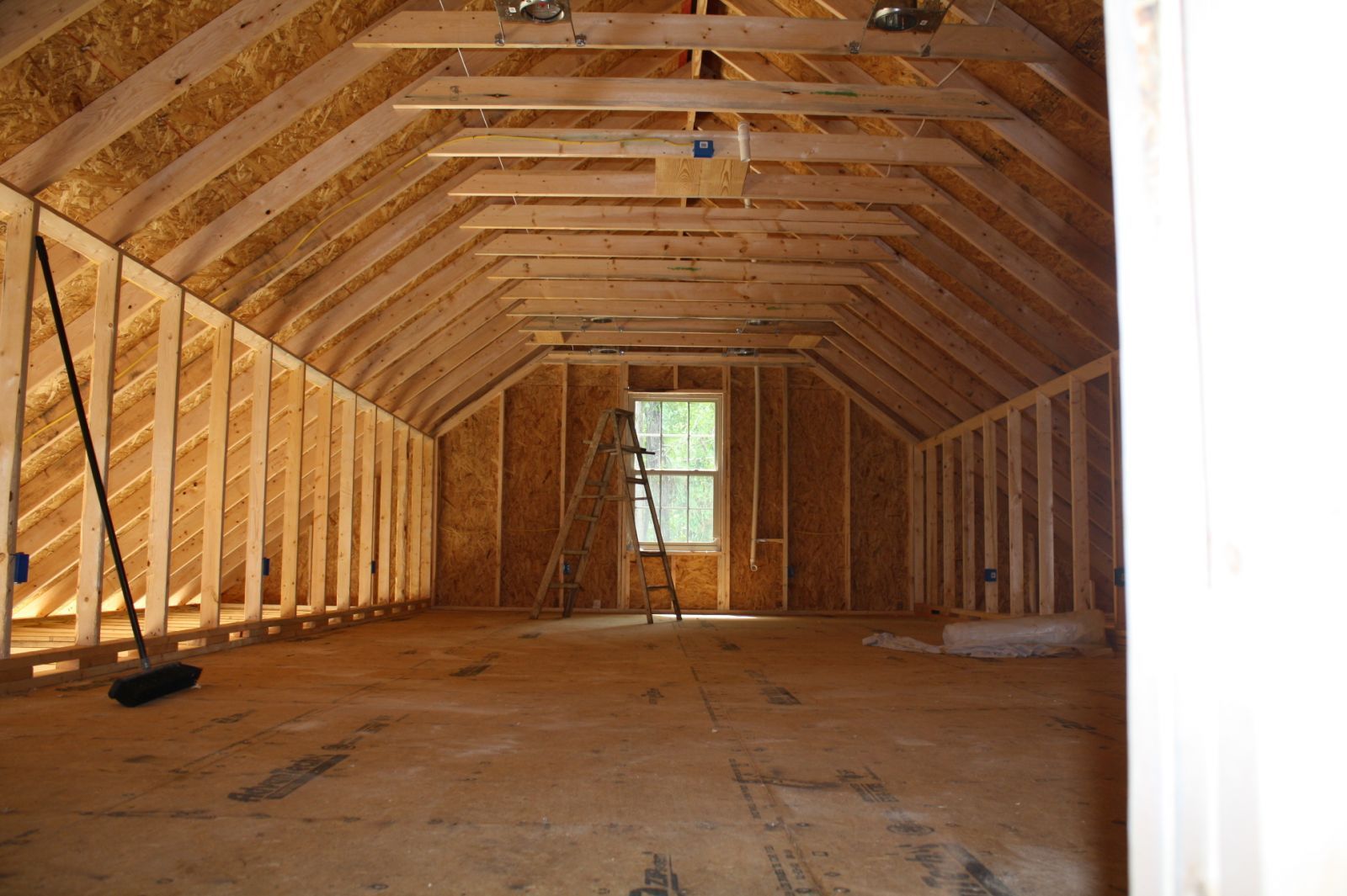

The 9/12 pitch roof affords a 612 square foot room above the garage - A MAN CAVE! I wanted a dedicated music listening room, but friends kept nagging at me to put a TV in the room for the UGA games. The only way I was about to do that was with a projector and a screen that disappears into the ceiling when not in use, and my wife liked that idea. So, it's now a media room, but I'm not going to call it a damned home theater, nor will it be set up as one. Code requires that stinking window right where I don't want one, and after the final inspection it's a goner.

Is it wood floor?

The picture of the room only shows the AdvanTech subfloor. On top of that will be a layer of mass loaded vinyl, a carpet pad and some berber carpet. The underside of the floor will get sprayed with a special open cell foam, as will the walls and ceiling. It's all getting sprayed and then closed.
None of that can happen until after the electrical is complete and passes inspection. That awaits getting the breezeway to the point that the garage can be connected to the house mains. That part only began on Friday, but it's already taking shape. We might be ready by tomorrow afternoon.
We haven't decided what to do with the concrete - probably going with an epoxy coat.
