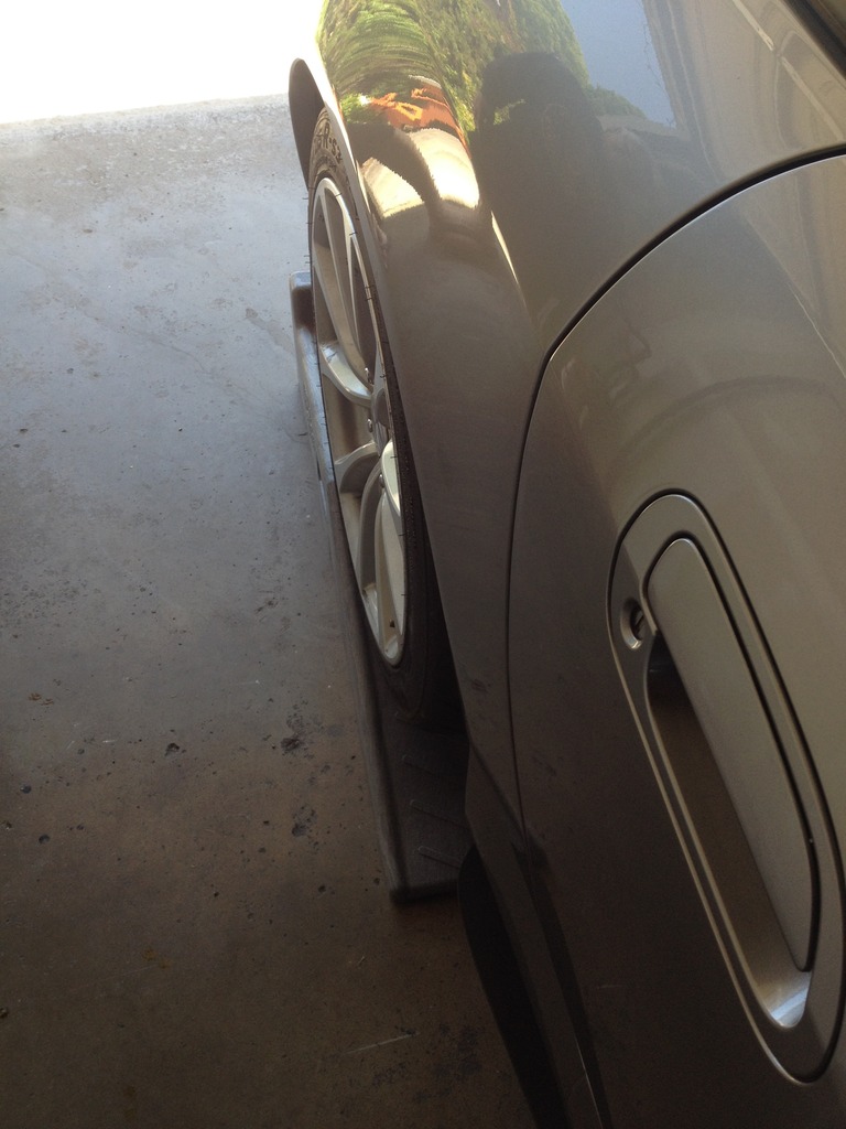

Update....
For late comers like me, I hope this information helps and hopefully, there really won't be a need for you to flip every pages regarding this topic or specs.
So the project kics I was told are on back order. I was really excited thinking I'll have it on by today. But it turned out to be beneficial for me, at least with my needs at this time.
I had some time today and slapped on a couple of 6 mm spacers on the rears. Again, I'm about 1.5 inch lowered on all four corners using Neuspeed springs. So the guy at Elite Performance and all of you guys were correct that I will rub unless I do camber adjustments and/or a fender roll. But I really do not want or prefer a fender roll at this time. Anyhow, here' some "Iphone" shots of how's a 6 mm sits on my car on a 245/40/17s/OEM size. I think, if I do go for 255/40/17s, it'll sit just right on the rears.
Thank you!

id be weary of anything larger than 5mm on stock studs... be safe and use the hub centric spacers or get extended studs to use the 6mm correctly.

Originally Posted by Memo6453
Originally Posted by SaintS2000' timestamp='1464897482' post='23983219
[quote name='1nate7' timestamp='1464367441' post='23978184']
That will absolutely rub, especially if you are actually running an oversized 255/45. Proper rear tire size should be 255/40.
My bad... it's gonna be 255/40. I corrected my original post! Thank you!
[/quote]
Right... stock studs aren't long enough. But I'm confident with having 6 mm there's more than enough grip.
