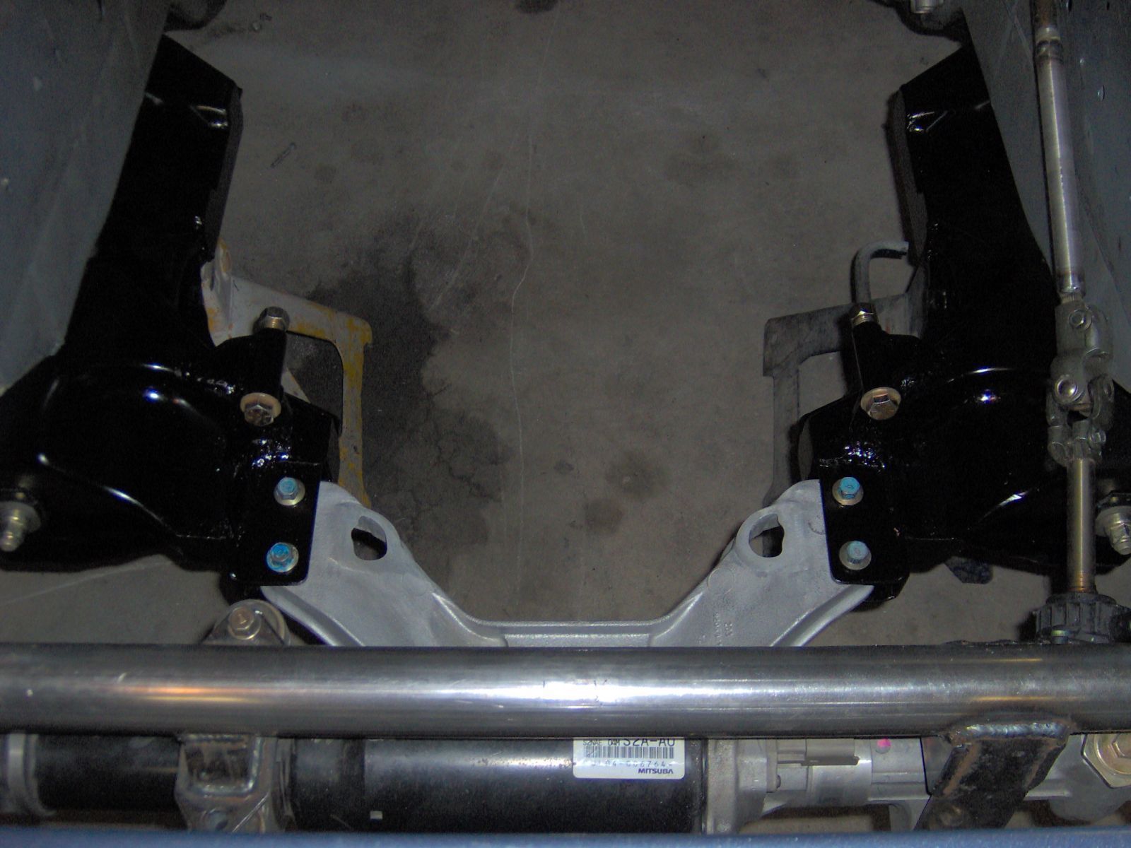

Tom, where did you guys source that front lower cross member casting?
BTW, nice!!!
We made a new cross brace and attached the rack to it instead of the factory subframe so I could move it slightly left and squeak as much as possible. I also used urethane engine mounts to limit movement. Right now that little rubber dust cover that slides over the input shaft of the rack just barely clears the altenator. All things considered it works great and feels stock
The lower subframe was modified and now has a reciever channel on either side that uses a cast aluminum sub frame connector. As I recall it started out as a GTO subframe and we inverted it.
