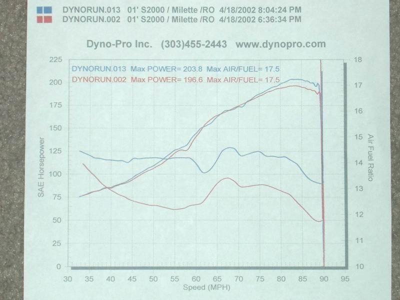

Well, I have pics of my dyno but I'm unable to connect to the server that I can pull them off of so if someone can put them up for me that would be great.
FULLTHROTTLE: I think I may have figured out why the car was going really rich at the Vtec change...my unmt is at +5%. Do you concur? If so, should I just leave it as is since we kind of canceled it out?
My settings (Disclaimer: These settings may or may not work on your car, use at your own risk)
Anyways here's the settings...
Wide throttle
Lvt:
4000 -5
5000 -8
5800 -9
Hvt:
5100 -6
5500 -8
6100 -9
6500 -8
7500 -7
8500 -7
V/T cnt: L-H: 5600 H-L: 5200
unmt: +5%
Throttle- low: 49 high: 50

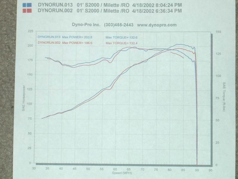

Here are Milo's dyno plots...
