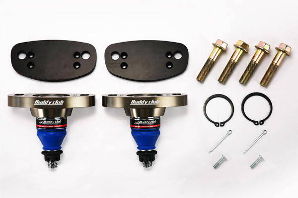

So as the title states, I was hoping to get more feedback and reviews for front camber joints. I am looking at trying to get -3.5 to -4 camber up front. I don't plan on racing my car competitively, mostly go for spirited drives.
I have tried to research as much as possible, I don't think I will be able to achieve the camber I am looking for with J's S1 (but if I can, I would definitely go this route), so S2 sounds like it is more plausible, but I have read a thread about their recent design changes with the S2, making me kind of iffy about it.
The other option is the Buddy club P1 adjustable camber joint. I can't seem to find any reviews on it really, but it seems like a really nice piece and having the ability to adjust it seemed appealing to me and it doesn't seem like it will slip unlike the SPC adjustable camber joint.
