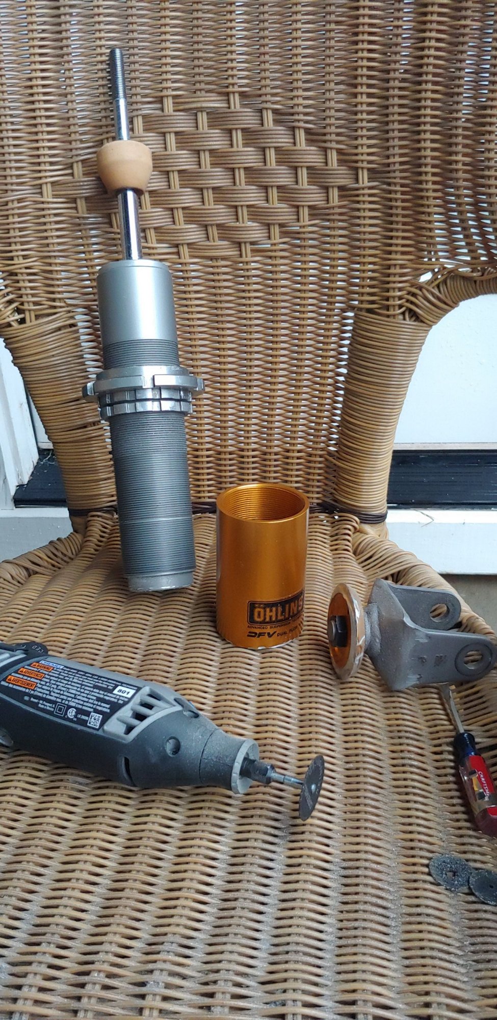

Success
Cut off the bottom w/ Mr. Dremel and the remaining cup screwed off without complaint. Very odd. If anyone else has this issue it's pretty easy to cut through, seems like pretty soft aluminum. I nicked the shock body a few times, but I measured with my "good" shock and fork where I should cut, so no meaningful damage. If yours doesn't unscrew after cutting off the bottom, do two vertical cuts, being careful to not hit the threads. I was planning this but didn't need to.
SBG I'll send an email about some replacement parts.
