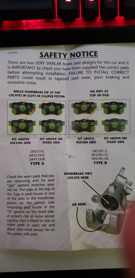

I went with EBC rotors and pads (redstuff). The rear pads came with a safety notice. I checked my old rear pads and theyre two with noise sensors and two pads with no pips. So I think its safe to say I need type B but have been sent type A. Someone with more knowledge want to confirm this before I try to start a return?
The ones Iv been sent have one noise sensor two with pips and one thats just flat (no pip) on the backing plate.
