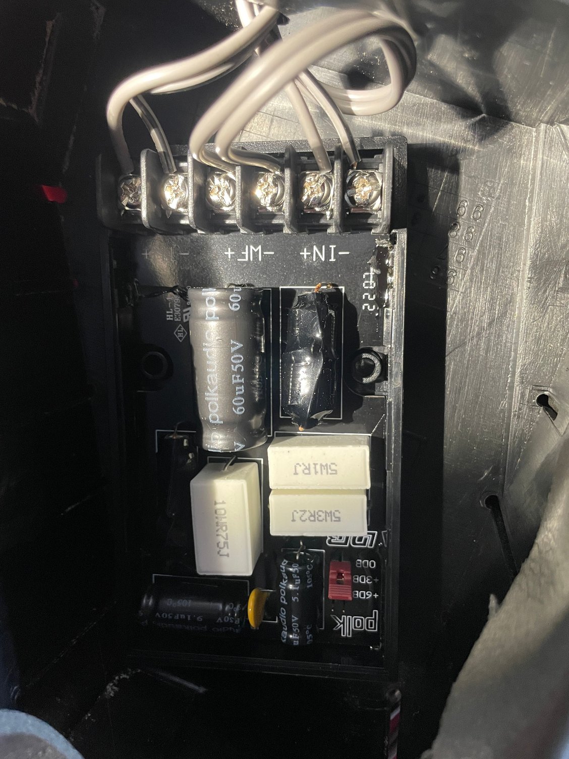

I bought Polk component speakers and a pioneer head-unit for my 2003 a year back. I installed the woofers only and kept the stock tweeters in place and ran that setup for a while and there was a ton of bass and the system sounded great! However, I recently opened up the door panels and installed the Polk crossovers and Polk tweeters. I followed these instructions of the exact same Polk system as I have (https://www.instructables.com/AP1-Ho...r-Replacement/) and am 99% sure I wired up everything correctly but I am getting ZERO bass. I've already tried the simple things like reversing the polarity of the speakers from the crossover to see if that would fix it and got the same result. I also tried the '6DB' setting in the crossover instead of '0DB' and that did nothing.
I tapped into the harness going into the OEM woofer for the Polk crossover. Was I supposed to tap into the input wires a little further back before they split to the woofer/tweeter for the correct input? Any help/guidance is appreciated. Thank you!
Picture of wiring on the crossover below. The wiring is all going to the correct places (e.g., tweeter to tweeter, woofer to woofer, input to input).

See if you are getting AC voltage to the subs with the amp on. Measure at the crossover terminals and the speakers.

Nothing unique to Polk here. This is just basic crossover wiring needed for any component speaker setup.
Wire bottom speaker wiring from car as crossover input. Place crossover in the pocket in back of door card plastic sheet.
Then connect a new speaker wire from crossover to tweeter. Don't use stock tweeter speaker wiring.
Connect crossover mid or woofer output to lower door speaker.
