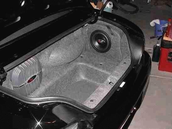

Originally Posted by sunrise089,Apr 29 2005, 02:06 AM
Just a question out of curiosity: from the point of view of an experienced installer, is Jim's amp rack the only way to go? I ask because the option of WLAURENT's enclosure really means it isn't necessary to give up the tool well area, and if the amp could be mounted elsewhere then the space tire could remain. Are any of the mounting alternatives worth pursuing if you are using WLAURENT's box?
I run a JL 500/1 on the wall behind the passenger seat (heatsink fins up). You loose about 1" of leg room - but my wife is only 5' 7" or so = no problem.
You could do the same with a JL 300/4, but you would only get about 150Wrms to a 4 ohm sub (bridge the rear channels).
You can also mount the amp on the wall of the trunk next to the spare tire hump
Thanks WLAURENT. Yeah, I knew you can mount an amp there, its the solution I would probably choose, but I was still curious why Dave almost treated the amp rack as a given. Does the size limitation mean alot of amps won't fit? Seems like with the interest there seems to be in your side mounted sub solution most people would want to go ahead and keep the tire.

I said amp rack because its a great place to keep your amp. I am a VERY firm believer that the s2000 spare is useless, so as far as I am concerned, its not even there. If you really want to keep your spare, then yes, you can mount the amp to the left of the spare tire bulge, but I dont think its as neat, and you still have to put wood backing over there to screw the amp in.
