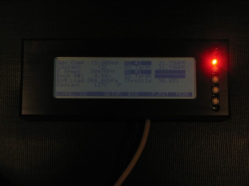

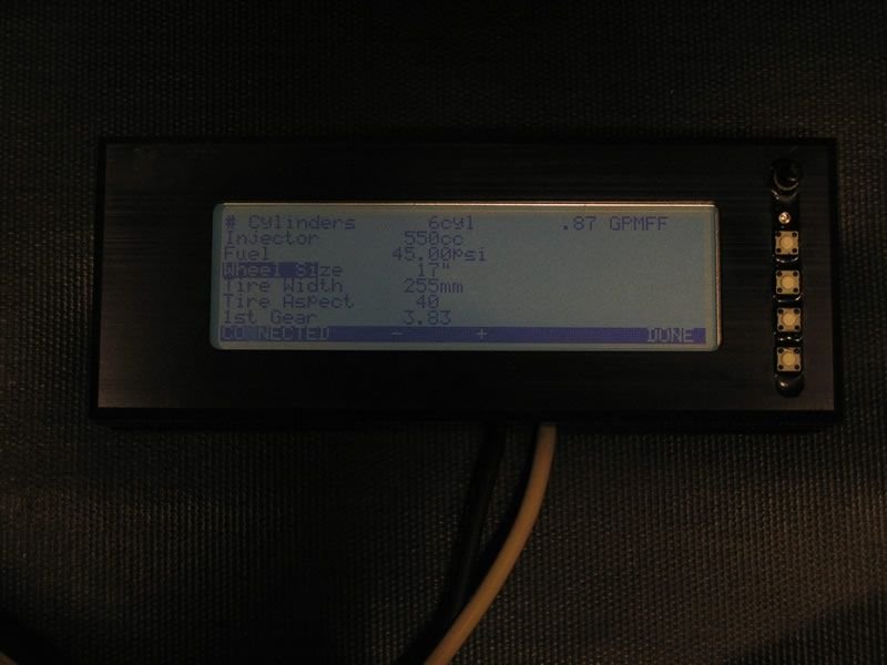

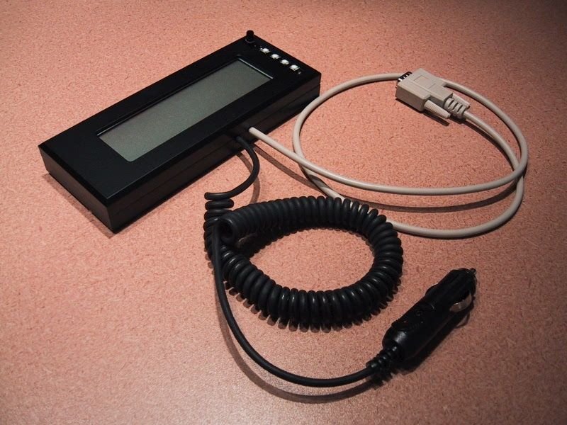

Hey Guys ... obviously I am having the same ECT limitation as others with AEM EMS ... just beginning to track my Vortech SC'ed + 9lb boost pulley S2000 ... decided I would go with this customizable solution from Gauge-Tech
Gives the same output information (not the graphics) that you would evaluate by having your laptop plugged into your AEM EMS ... has programmable (variable) warning notification parameters ("if value greater than" ... "if value less than").
So ... does lots more than just detect the AEM ECT signal and output temperature.
Gauge-Tech AEM Display

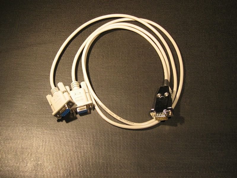

I also picked up the "Y" split serial cable so that you can have your PC plugged in without having to unplug the Gauge-Tech Display

I'll be interested in your feelings about this device after you've tracked the car with it. I'm assuming that it doesn't permit doing a lot (if any) datalogging.
I find that I only have attention for a limited number of engine parameters -- so I typically log the entire session on my laptop and then review the logs between each session. As long as everything is okay, I head back out without worrying.
While on the track, I generally watch only my boost gauge, EGT, and (hopefully soon) the ECT gauge with Modifry's help. I've got my CEL set to indicate a lean condition under 4 psi + of boost.
More than that, I'm not sure I can cognitively process while, at the same time, navigating the line, etc.
But it looks like a neat solution for daily driving so that you can have a quick look to insure everything is running normally. What did it cost?

John are you going to wire that permanetly (without using the cig adaptor)?
