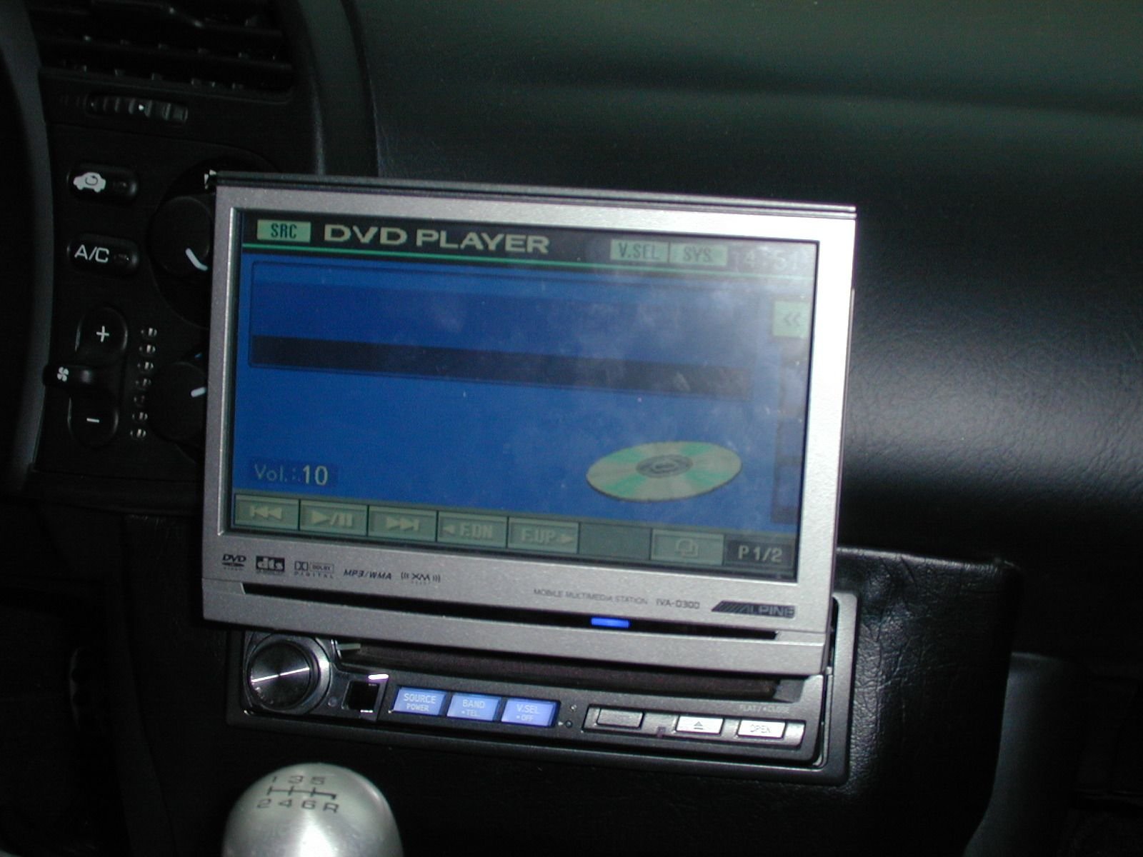

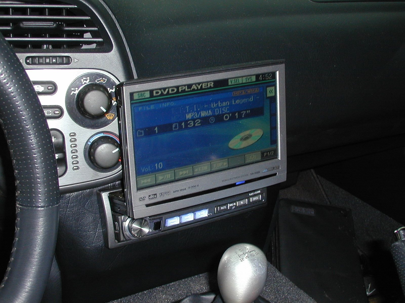

not sure if this looks ok to all of you, but.. I like it and it works
In person it looks much better
ill take some pics in natural light. and post them also.

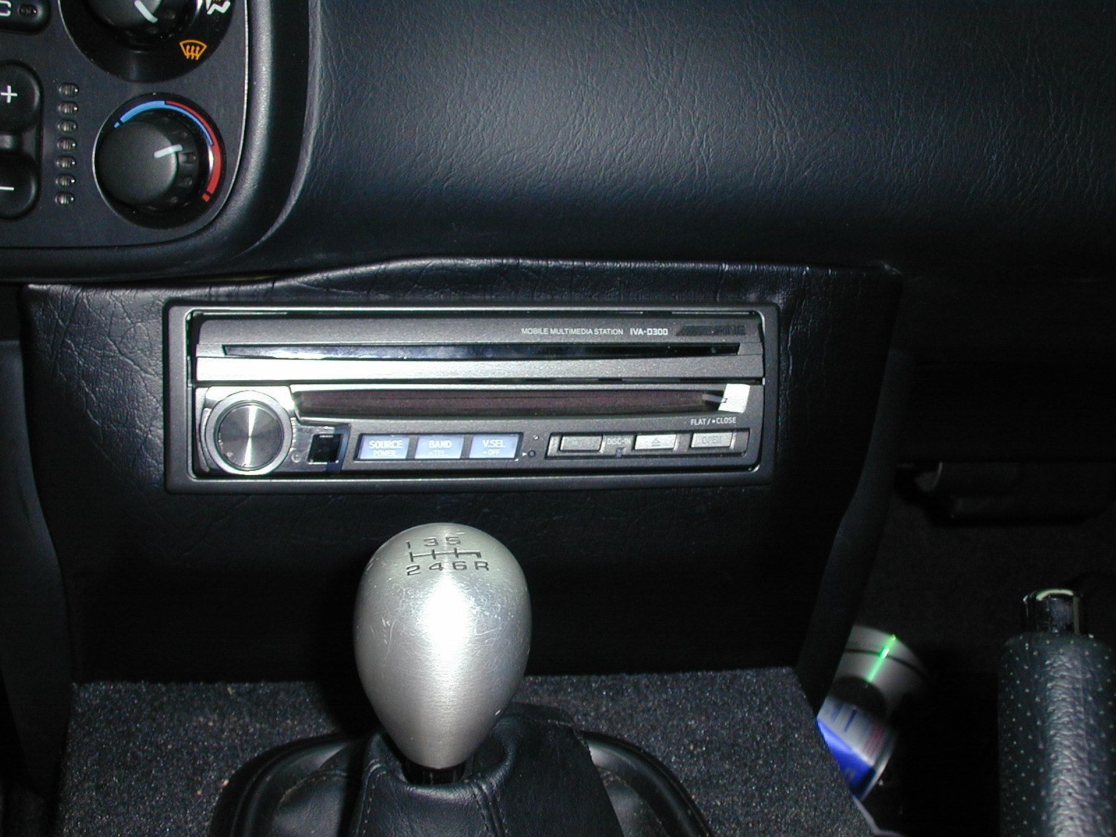

The Headunit itself is mounted at an upward angle. This allows the screen to come out and not be interrupted by the shifter. The basic form is just mdf sanded and manipulated to hold the deck and fill the hole nicely. Then I used bondo (first time i might add) to make the hard edges go away and to add some contours to the form itself. Then i wrapped it in vinyl (first time also) I will take more shots of it and take it out to show its true form. I also plan on making a fiberglass mold for this and see if I can make a few for our fellow s2ki members whom want the ability to put in one of these units without cutting the dash or changing any facrtory anchor points. BTW the screen on this unit is able to be moved in and out and also different angles which helps in the whole installation. The only drawback is the vents are deleted in this install.
