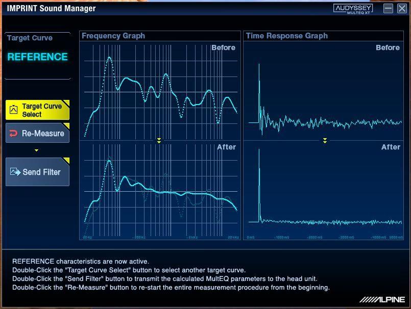

Hello all,
I thought some of you might be interested in this. A few of us in the UK run Alpine 9887R head units which have the self contained Imprint facility. Unfortunately, in order to use it, you need the KTX-100EQ Imprint kit, which costs extra.
As I have one of these kits, I thought it would be good to share its facilities with the other guys, in order to improve their sound. Everyon who's heard Imprint in operation in my car has been mightily impressed with the positive difference Imprint has made (see my sig for details of my kit).
Anyway, we had a mini-meet today to setup the Imprint in 4 cars and I've posted the graphical results below, as they are quite interesting and may help others with tuning their systems.
Mine
Next up, PaulF who has only upgraded the head unit and is running stock components in his MY02 car
and Paper Lawyer with his 2 channel Genesis amp and Boston Components
We then tried to see if we could load up a "roof open" and "roof closed" setting for unclefester's car. Sadly this didn't work, but here are the two sets of measurements:
Roof open
and roof closed
As you can see, there are a few common peaks and troughs. A trough at around 500Hz, a peak at around 1 - 1.2Khz, and then a sharp peak at around 1.8 - 2Khz. There is a general brightness to the higher frequencies (probably caused by the tweeters firing straight at the windows).
This may help some with tuning their systems if they have parametric EQs.
Of course, what these graphs don't really show is the massive improvement in soundstage and, very usefully, the ability to play music seemingly louder, which is helpful in an open topped car.
We also found that the "Reference" curve worked best with roof and windows up, and the "Reference with Mid-Range Comp" gave a nice boost to the mid-high frequencies and worked very well with roof and windows down. The Windows, in particular have a significant effect on frequency response.
I hope some of you find this of interest

interesting to see where our stereo dips and jumps. thanks for posting!

I know it is kinda old, but I have been very busy in the past few months. Is it possible to send me these screen captures? I'd like to come up with a general tuning guide for S2ks by studying the common peaks and dips of these measurements
My experience with Imprint so far is that it helps tremendously with mainstream and compressed music(my mp3 sounds amazing now even without a sub!), but it distorts the sound stage "VERY BADLY" when fed with very well recorded material. I think it would be beneficial to all alpine owners if we can come up with one general manual setting for well recorded music
