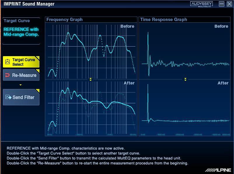

Some more screenshots for you all
unclefester - All worked once we'd connected everything up properly
lovegroova - I've fiddled with the gain on the amp for the components, which are bi-amped
PaulF - now with new amp and sub - HU is driving the Alpine components
You can see the benefits of fester's extensive sound deadening - everything is much smoother to start off with. PaulF and I still have a dip ad 500Hz and a peak at 1kHz, as well as a peak at around 8kHz.

I'm pretty sure that 500hz dip is the boot area flexing and resonating - wonder if that's the same frequency as the drone / boom that comes with aftermarket exhausts, that's something else I don't suffer with.
Either way it still sounds much cleaner after the imprint

Your wish is my command:
Last Saturday, unclefester very kindly helped me out sticking lots more bits of sound deadening material to the boot (trunk) areas, as well as adding even more deadening to the doors - the original installer had done a pretty good job, but more was added to the doorcards themselves.
I've now managed a new Imprint run this evening, now that the wind has finally died down here and the birds stopped singing once it got dark, and here are the results.
You can see that the new sweep is much smoother, which means there's less processing for Imprint to do, which in turn means my system now sounds the best it's ever sounded.
Here's the previous sweep for comparison:

That IS a really smooth curve now isn't it!!
