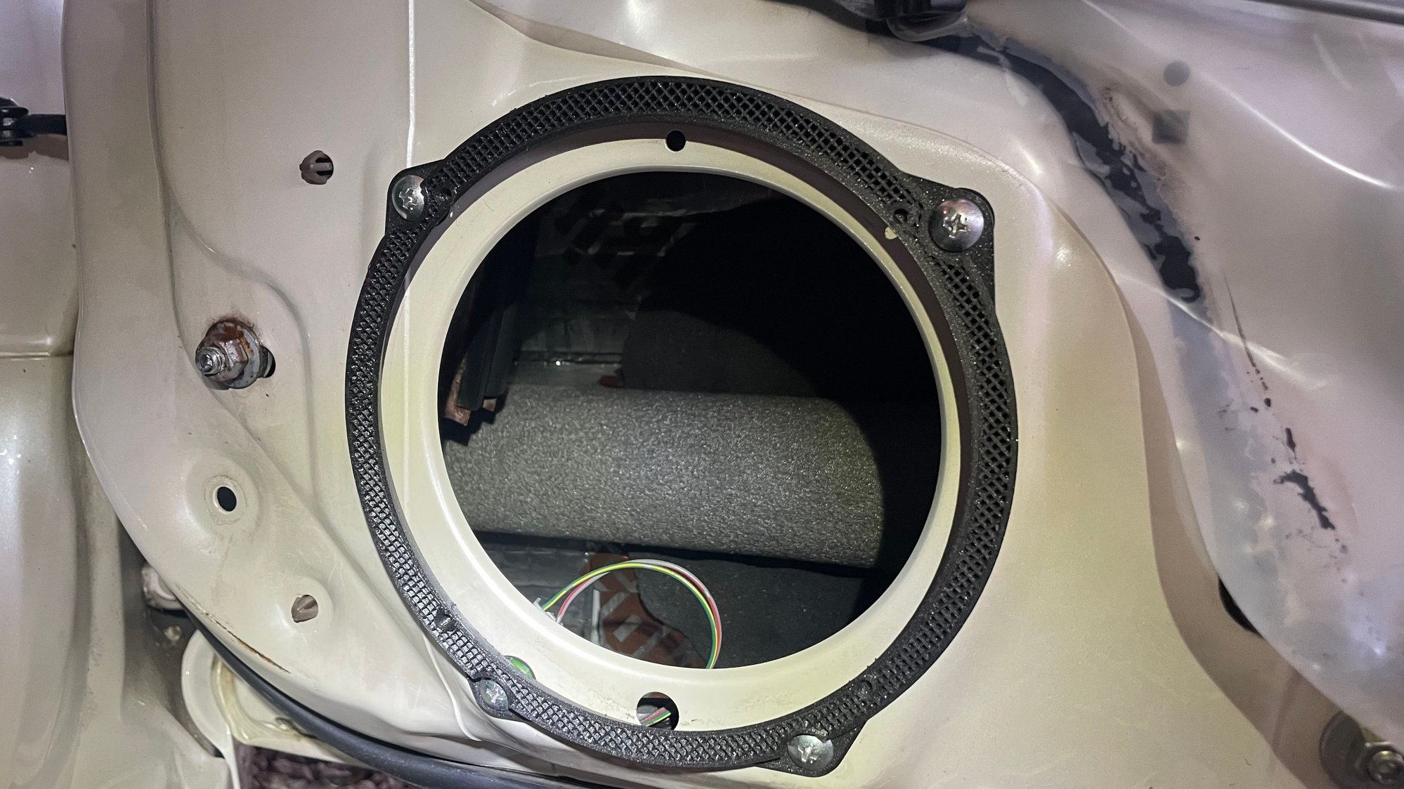

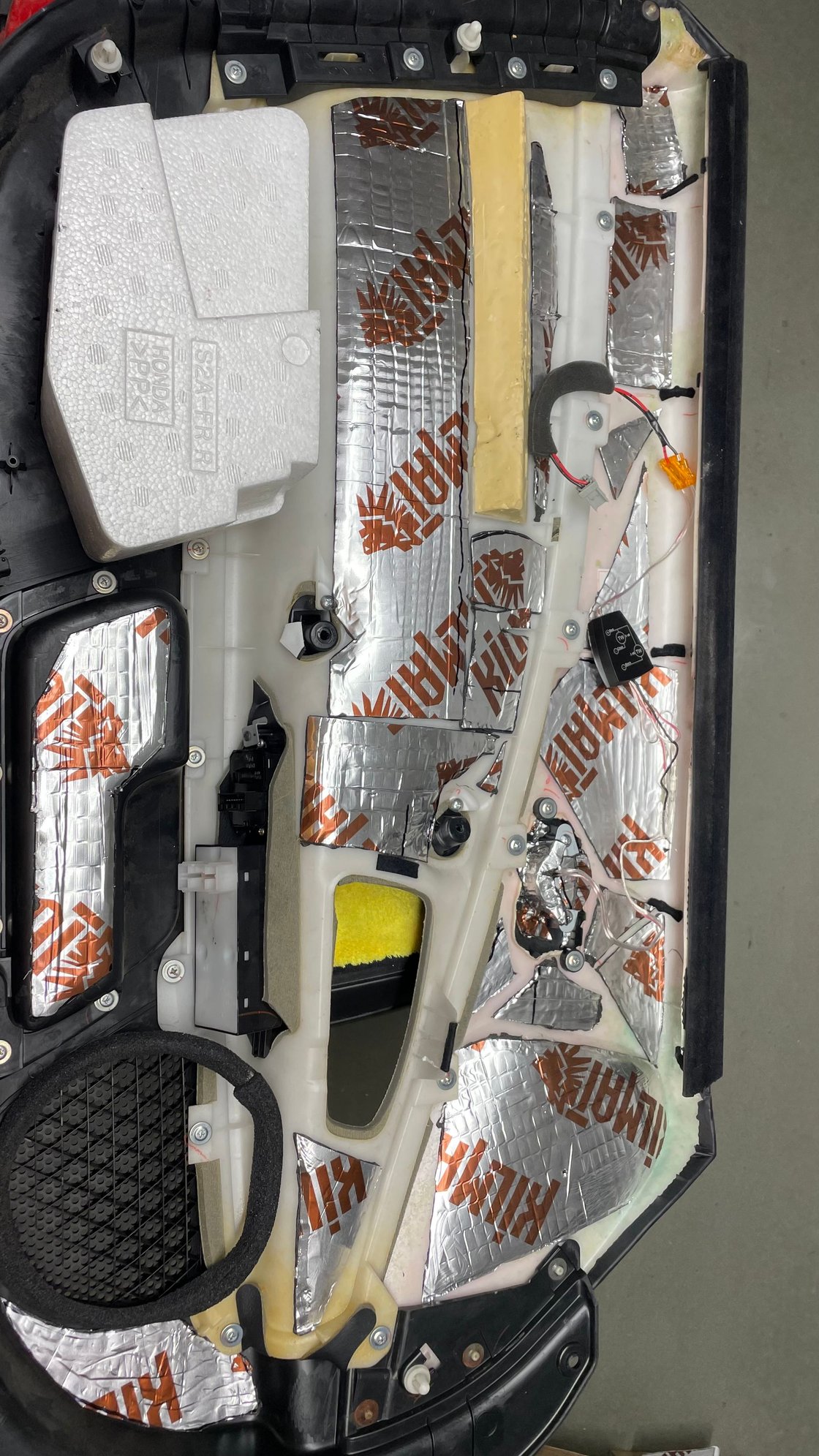

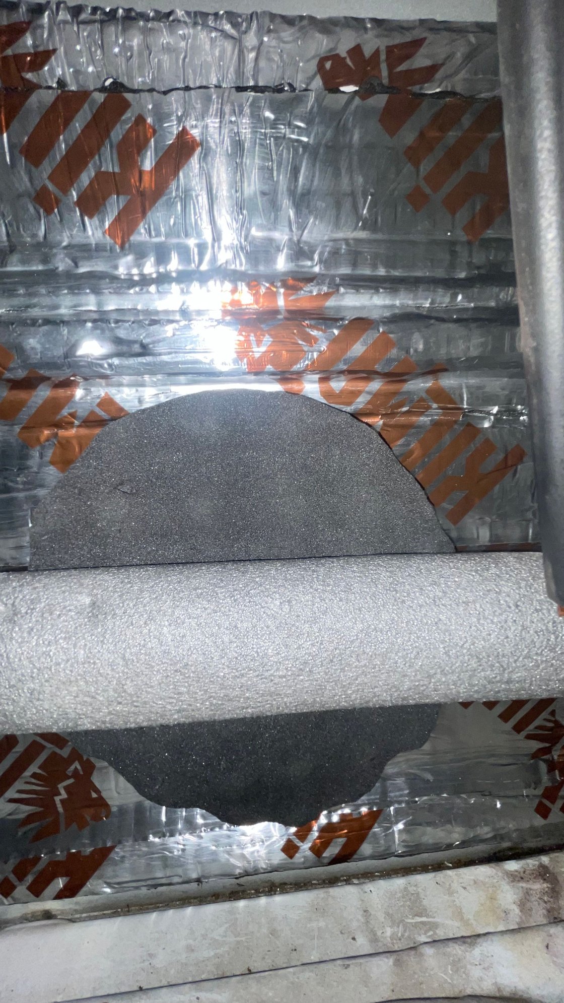

Just did the sound deadening on mine:
Door card
Inside door

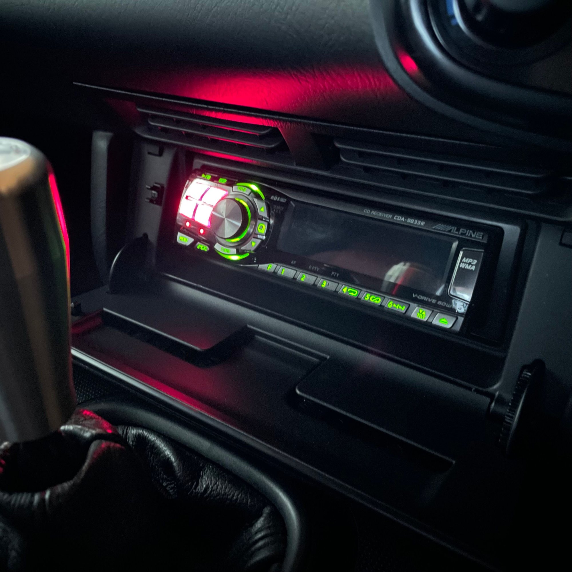

Old alpine headunit
Got my mate to 3D print some prototype rings. Fit perfectly. Will be tweaking them a little for final dimensions
Door with Kilmat and foam

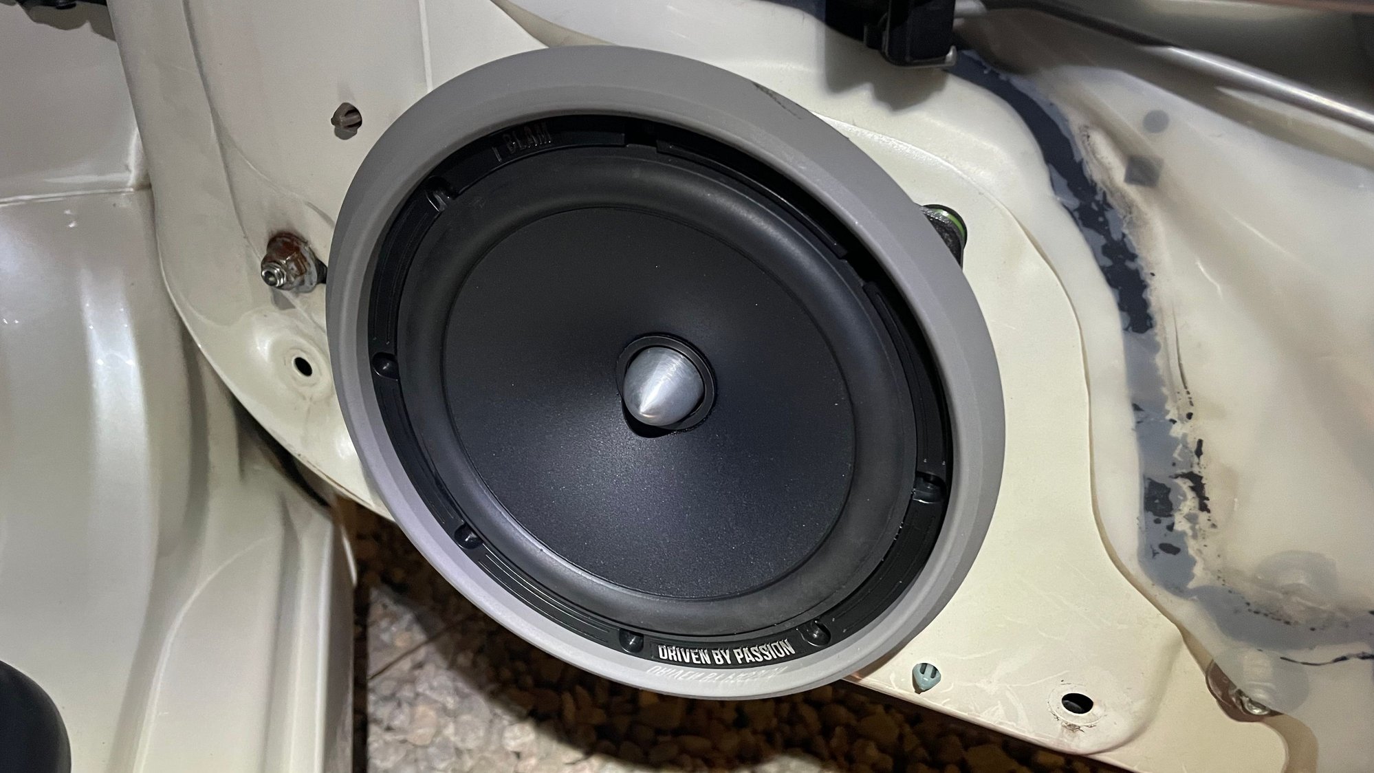

New speakers and silicone surround

Sadly, you did it wrong.
The damping tiles need to go on metal. They work by adding mass, changing resonant frequency. Eliminating oil drum effect. Mercedes solid door shut.
These tiles don't actually block sound waves. Thet prevent large, flat metal surfaces from becoming speakers, publishing road noise into cabin.

if you look closer they are all over the outer door skin which is the primary use, added more to the door cards for extra mass. Sounds excellent with no vibration on the door card. right or wrong?!

Thanks. The pics were slow to load, so I only saw first one when I commented before, didn't realize there were more.
The only thing wrong ismore weight added than needed. The stuff on the door cards not really doing anything (use thinsulate at 100% coverage here), and door panels you only need 25% coverage. More doesn't really do anything.
Also, you have to thoroughly roll out the waffle pattern. The stuff only changes the mass if its part of the panel mass. Which only happens if its so completely adhered that it becomes one. Rolling out waffle makes sure of that.

Sounds good. Yes some waffle still left in areas, harder to access with the roller tool!
