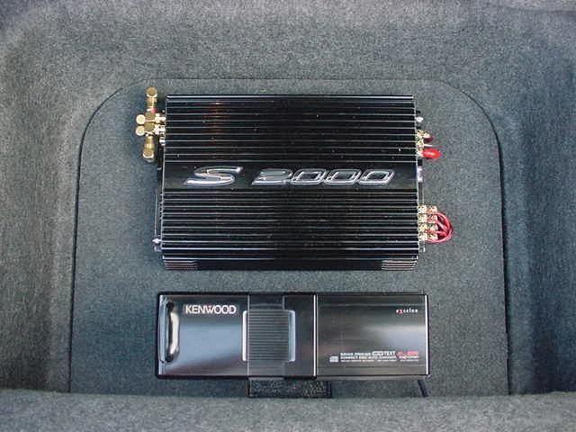

Old Jan 25, 2002 | 07:29 PM
M3KVB's Avatar
Posts: 143
From: AUSTIN
I drilled a 1/2 inch hole in the of bottom of the trunk well and attached a nut and bolt with 8 gauge wire to the amp. The key is to keep the ground cable as short as possible.
