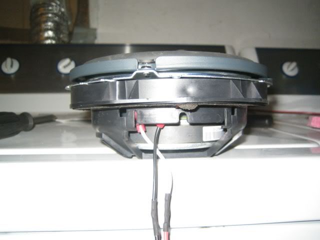

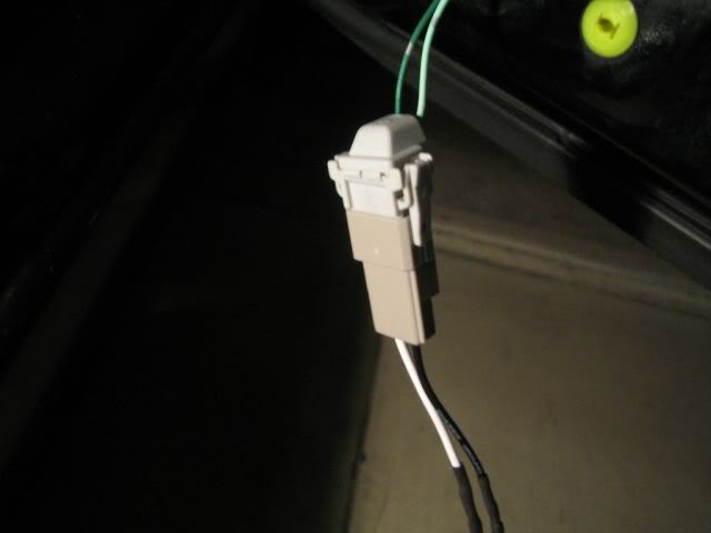

thanks to this thread, my install of infinity reference 6.5" components 6020CS went fairly smoothly as well.

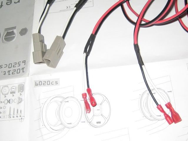

i ended up purchasing the factory harness adapter from crutchfield. seems kind of lame, but i did not want to do any cutting into the OEM harness. it was worth the $20 including shipping. if you can find the mating plug cheaper, great.
so in preparation of the install, i cut the crutchfield harness at the middle of the wire. then i soldered about 40" of speaker wire on both sides of what was left. so that i had a pair of harness plugs and extended speaker spade plugs to plug right into the main "mid bass" speaker.
infinity comes with some mounting brackets. i used the metal one to fit into the OEM speaker pod. all together, it JUST fits, with just a bit of compression needed. the bracket leaves the speaker clocked at an angle a bit, but its ok.
plug the harness in and route the speaker wire also thru to the middle of the door where the door switch harness comes out.
then i opened up the infinity crossover. just two tabs on the side. this allowed access to the mounting holes. and i used the small screwdriver i had to punch a hole (didnt need a drill) and use some screws to hold it down. put the cover back on.
tweeter install is just as easy as shown above. i used krazy glue as well.
tape the wires up as nicely as possible. (not really)
just want to say thanks and i also recommend that crutchfield harness.
i also would like to add that im now a believer that OEM speakers relaly do suck. ok, theyre not horrible, but these components are MUCH better. after installing just one side, i did a L/R test and definately could hear the difference. and am now enjoying a lot more bass with less distortion. i do hear SLIGHTLY a bit of hiss at quiet moments, but not a big deal when driving im sure. and i think im going ot use the -3db crossover option for the tweeter. but otherwise, im really happy i replaced the stock 02 speakers.
