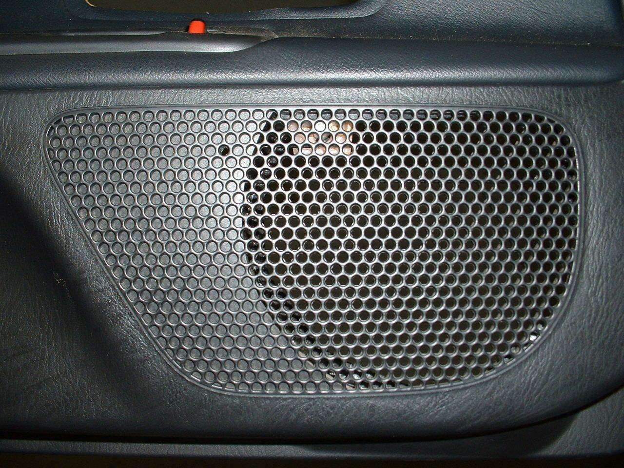

The Alpine type R's barely fit. Any experienced installer at a good local shop will be able to make the modifacations. Below are pics of one I have done for a customer recently on an S. It does require minor cutting to the door skin itself. Mostly not because of the depth, but more because the Alpine basket is a little bit oversized more than a regular 6-1/2". I did have to install some spacer brackets to keep the back of the magnet from touching the window stop at the bottom of the window.

The system does sound great! This customer went with an Alpine 5 Channel amp, which does 50watts X4 RMS and 200watts X 1 for the sub. He put the type R's in the front, the Type R's in the S-pods and then for the fifth channel added the Type R 10" DVC Sub. He also opted to go with the Alpine Cd deck model CDA-9815. The material around the mounting and inside the door is very similar to dynamat but a better material I have been using for all of my installations on S2000's. It helps stiffens up the door panel and makes the driver perform better and gets rid of the coffee can sound that normally comes from that location.
As for the tweeter location you have a couple of options. Below are some pictures of another customer with a 2001. I put the tweeter next to the woofer but attached to the door panel and not the door itself. This does lower your sound stage dramatically and is not recommended, he did not want to spend the money on the tweeter pods. On this vehicle the customer stated he was not pleased with the results and will be upgrading to the tweeter pods soon. Some other options are:
