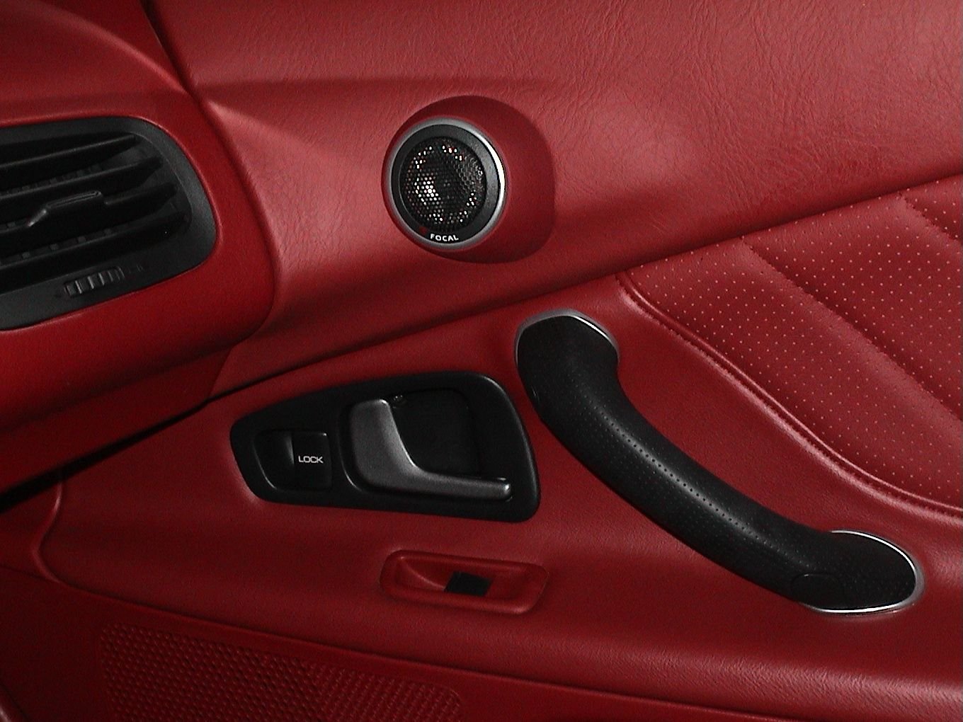

I can answer the first part of your question. Yes, I, and others, have changed-out the stock tweeter. I have Focal tweeters in mine. I actually drilled-out the faux grill and put the Focal tweeter cup in the stock location. It looks quite nice.

This is the first time I've added pics, so I hope they come out alright. I believe they are the TN45s, if that's what comes w/ the 165K2s. I can't move the tweeter at all. I assume this method is better than using the stock grill (didn't try it first), based on how much more transparent the Focal grill looks. However, I have the tweeter level (on the crossover) set to -4dB, so I probably would've been OK using the stock tweeter grill and upping the tweeter level (-2dB or 0dB) to compensate for any loss in output. If I could do it again, I'd probably at least give the stock grills a chance before drilling them out, considering how powerful these tweeters turned-out to be.

Nice pics! You did the right thing, I'm going to do the same soon. I don't like the stock grill cause it has a very thick mesh pattern and I belive that distorts the sound. Try putting something, like a finger, on the tweeter grill and move it on the grill back and forth and see how it changes the sound.

Copycat Looks great!
