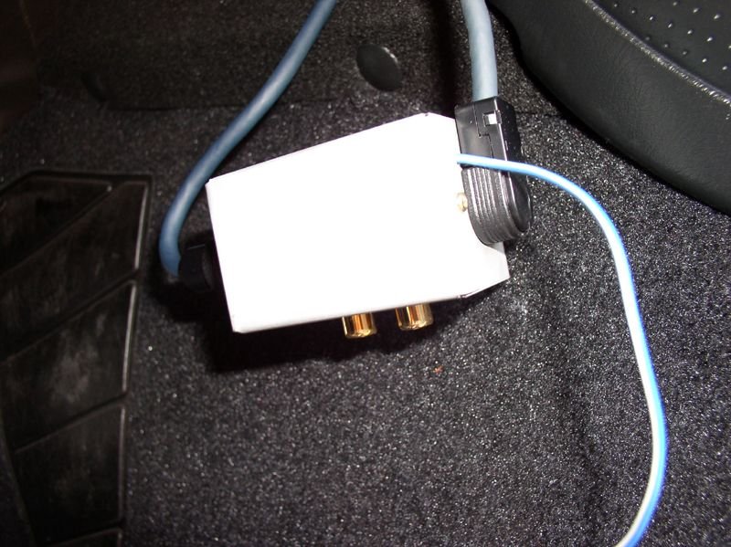

This is the Alpine adapter. Notice the 2 RCA jacks, for the AUX...one Ai-Net goes to the changer, xm, and stuff, and the other to the headunit.
the blue wire is the trigger wire for the AUX audio...basically an audio remote wire.

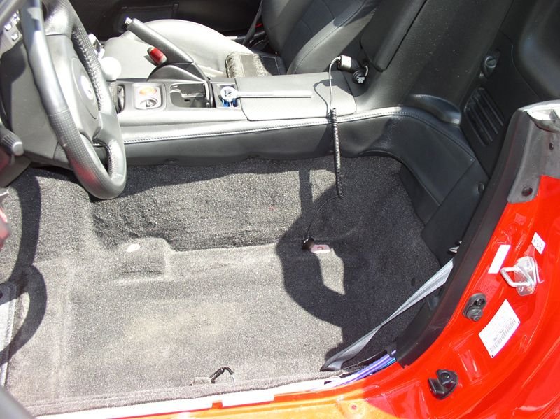

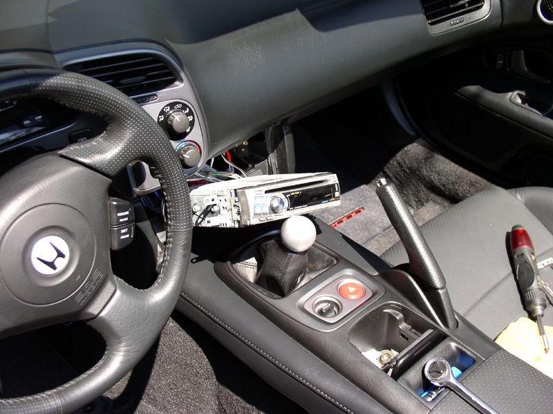

Gutted my dash to run wires, splice wires, and store my acorns for the winter.
Seat was removed for wiring, and mounting the player. If you look closely, youll see at the bottom of the pic, the stock seatbelt sensor wire, which has a perfect hole in the carpet for a stealthy installation. And boy were there a lot of wires.

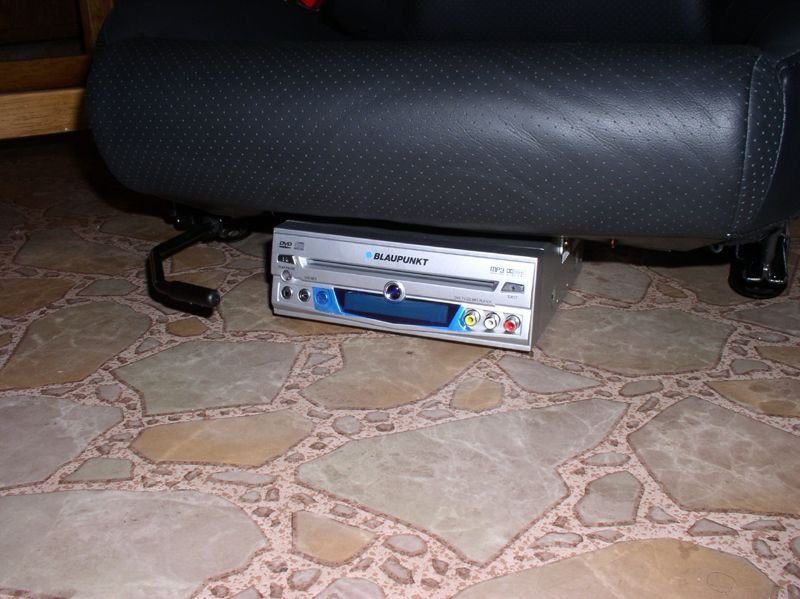

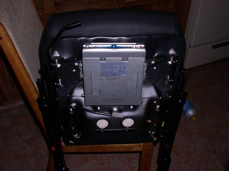

Here is the player mounted on the bottom of the seat. This part was cake.
By the way, our seats are easy to steal!
This is what it looks like flat on the floor. Keep in mind, the seat actually bolts on 1.5 inch "lifts" so the player when in the car, isnt even close to the floor. You cannot mount anything on the floor instead of the seat, because the seat flares are the rear, and will knock whatever you mount on the floor. Even in this pic, the player isnt touching the floor. You can still slide a credit card clear under it.

is the seat going to move on the rails?
Old Apr 17, 2004 | 09:31 PM
NFRs2000NYC's Avatar
Posts: 18,852
From: New York
Oh yea, there's about 1.5" of clearance.
