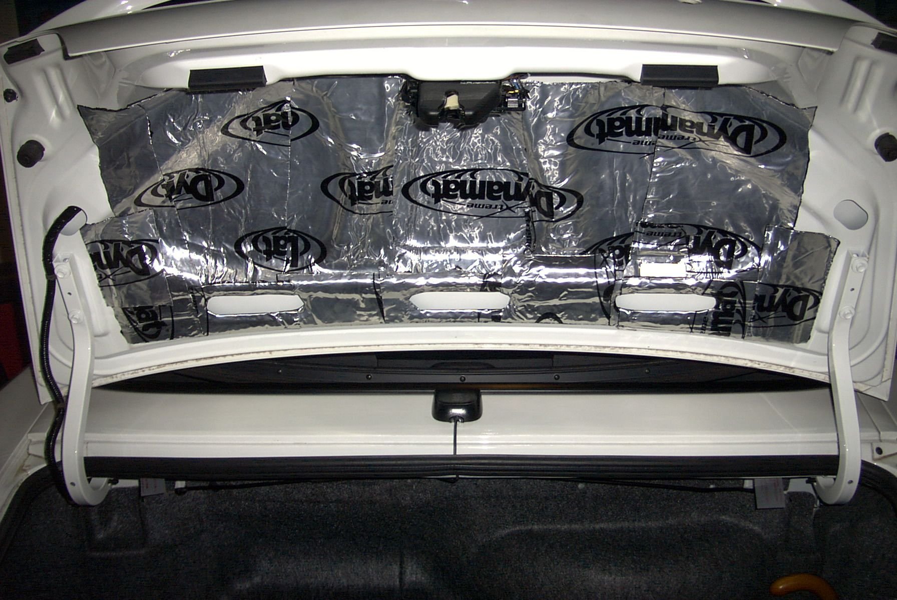

here are my trunk pics:
(BEFORE DYNAMAT, notice the cheap OEM Honda stuff)
(AFTER)
