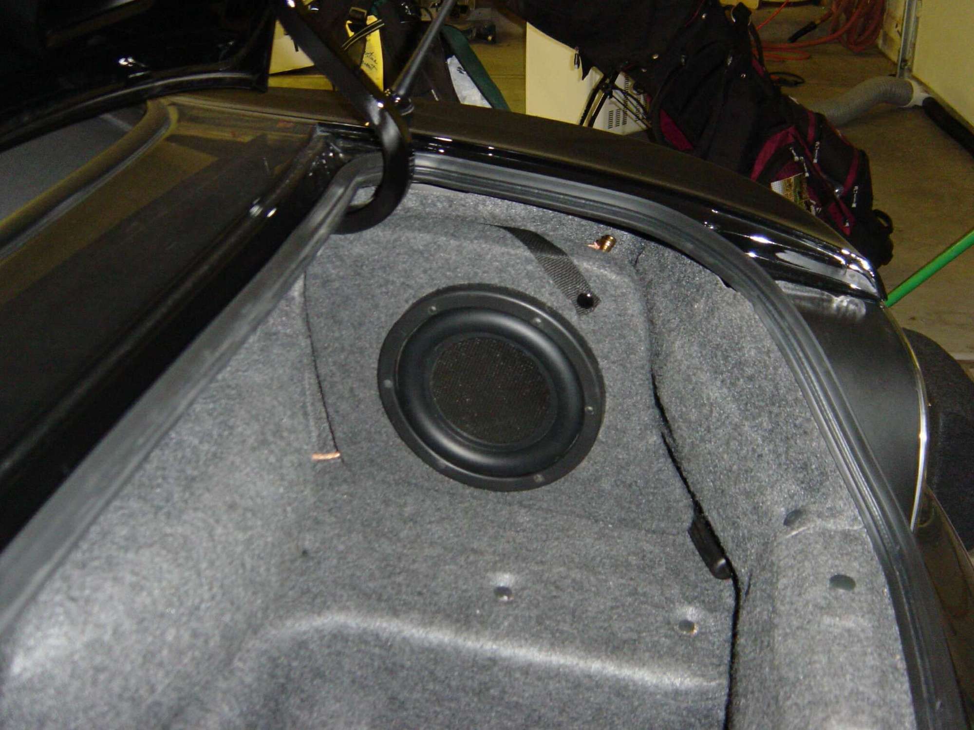

William, that looks absolutely fantastic...
"The sound is crisp, natural and deep." WOOOT!!! for all practical purposes -- we bought these things blind, just based on some reviews and 'net rumor'. it's good to know the gamble seems to have paid off...
how does it compare in sound quality to the JL stuff?
i suspected as much about the recessed approach in the trunk hinge... i know from previous pics various people have posted that it is a tight fit to that hinge...

Installed one of the E8A's and fired it up this evening:
