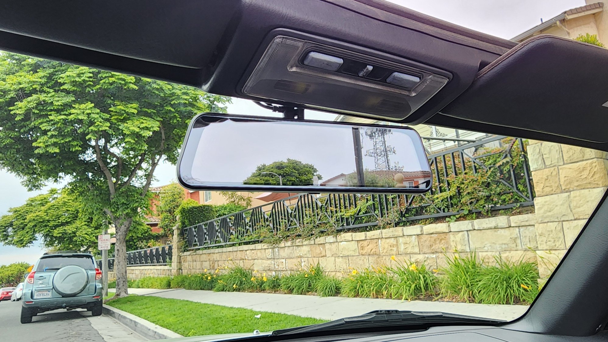

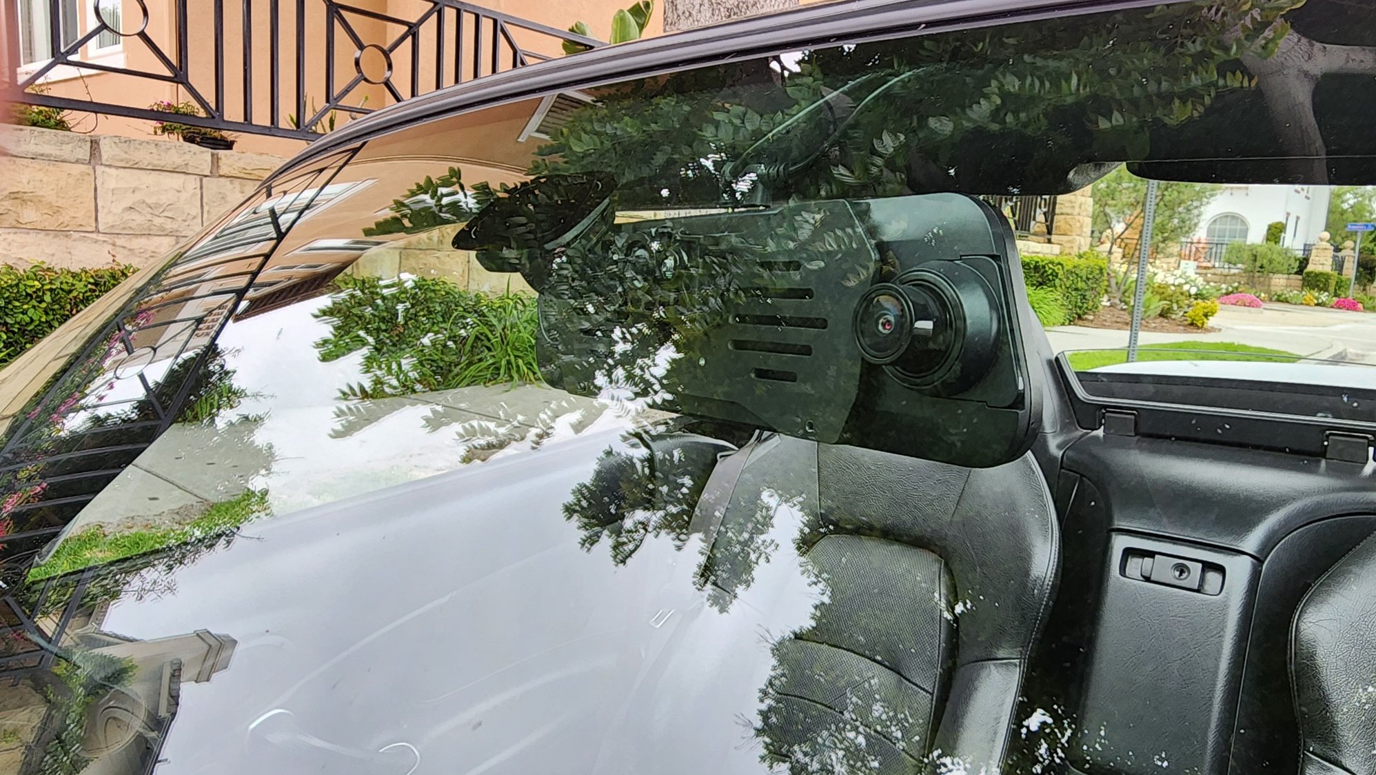

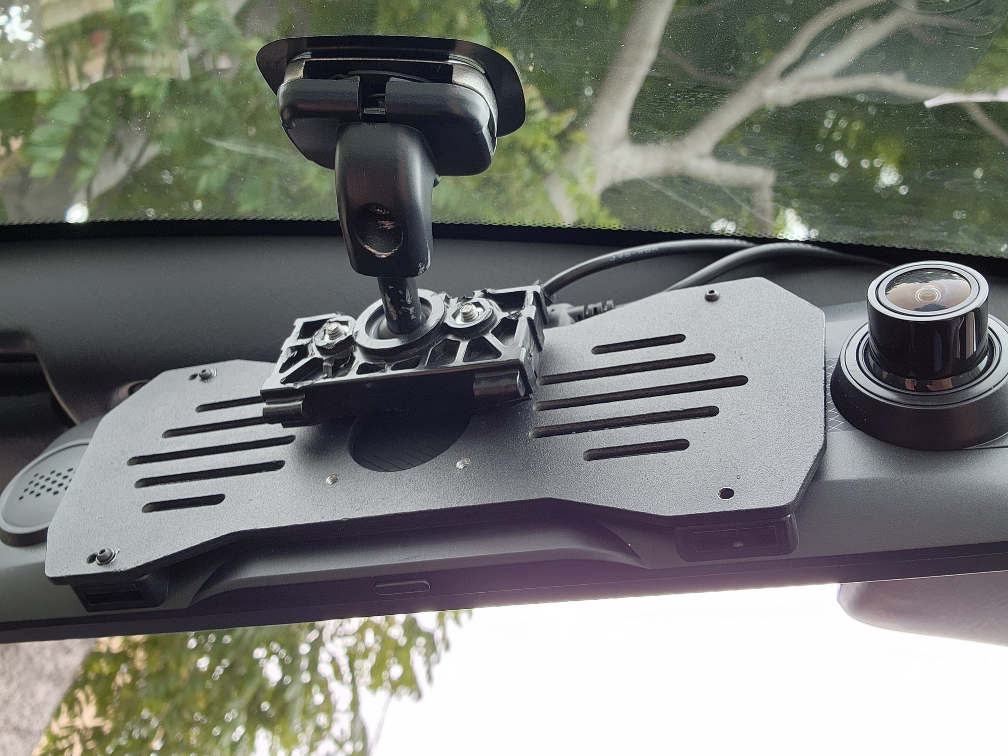

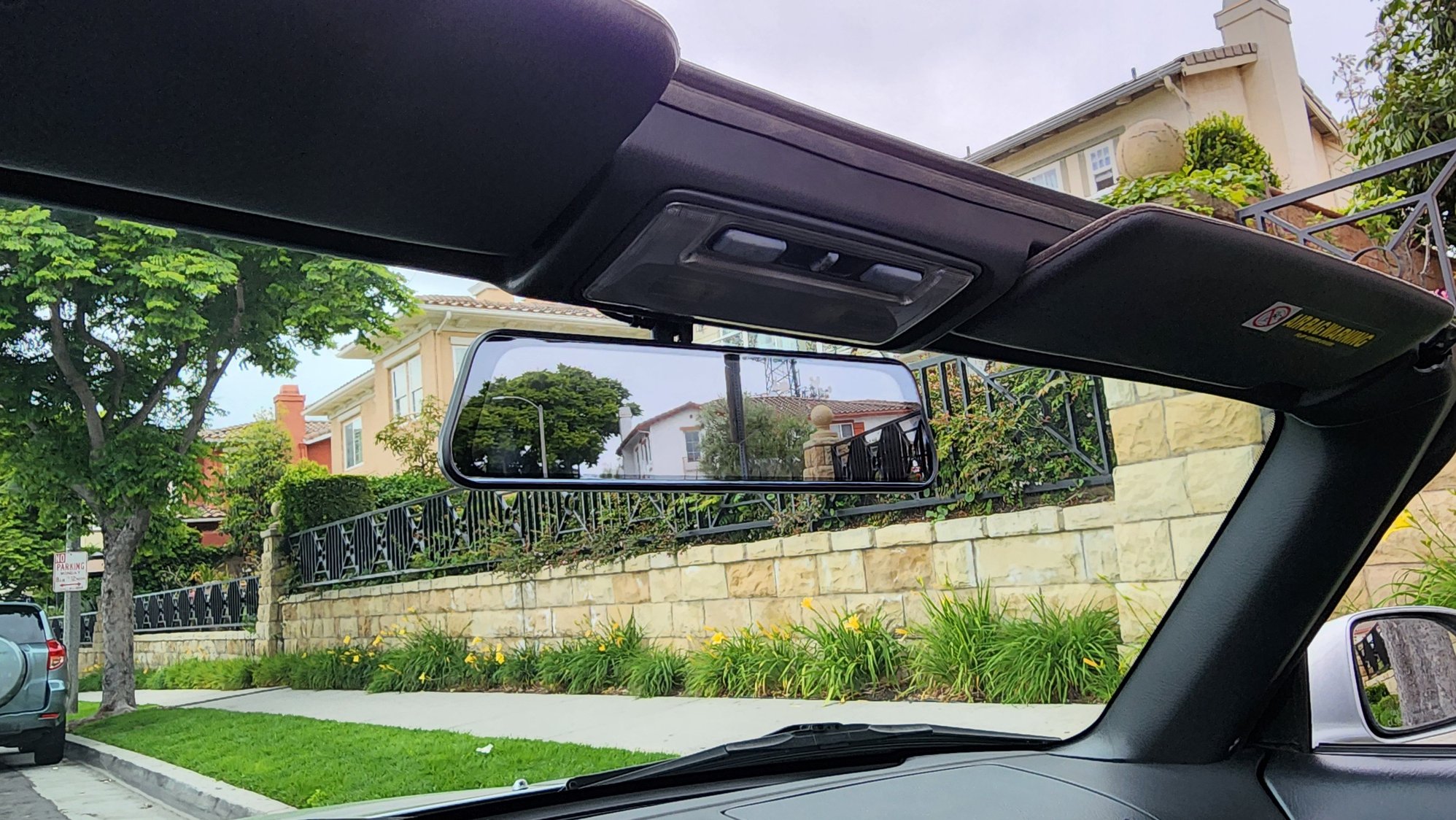

Here's how mine turned out using the OEM mount salvaged from my original mirror on a wolfbox G930
Screw backed out on the bottom right on the drive to take these photos, replaced and tightened, hasn't been a problem since
Excellent setup with front and rear cameras and a 256gb SDcard that keeps about a month or two of footage, including time lapse footage for 12 or 24h after each drive. No battery drain issues.
