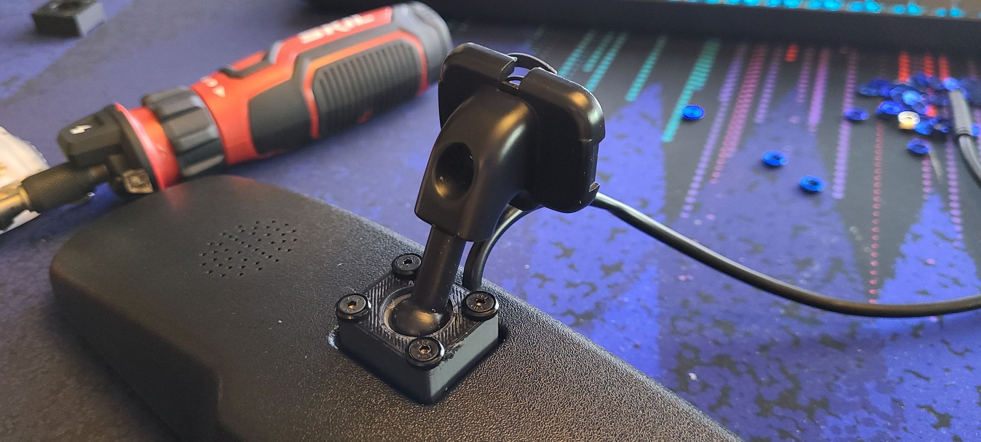

Nice! yours is much cleaner than mine, i've been meaning to figure something else out. I'm using a generic backup camera / auto dimming mirror and i've created this adapter for the stock mirror mount. It works alright but the display is kind of hard to see with the top down which is annoying. Also, some vibrations get transferred to the mirror.

Wow, very nice! Clean design and I can't even see your layer lines!

Thanks! I think yours is probably better though. The screen in mine is just not really bright enough with the top down on a sunny day. do you have any problem seeing yours?

I couldn't tell you about visibility in daylight since the hardtop is pretty much attached all the time now. It still has the auto dimming function so nighttime glare from headlights is not a problem.
HOw did you get the OEM mirror off the ball mount? Did you have to sacrifice the old mirror?
